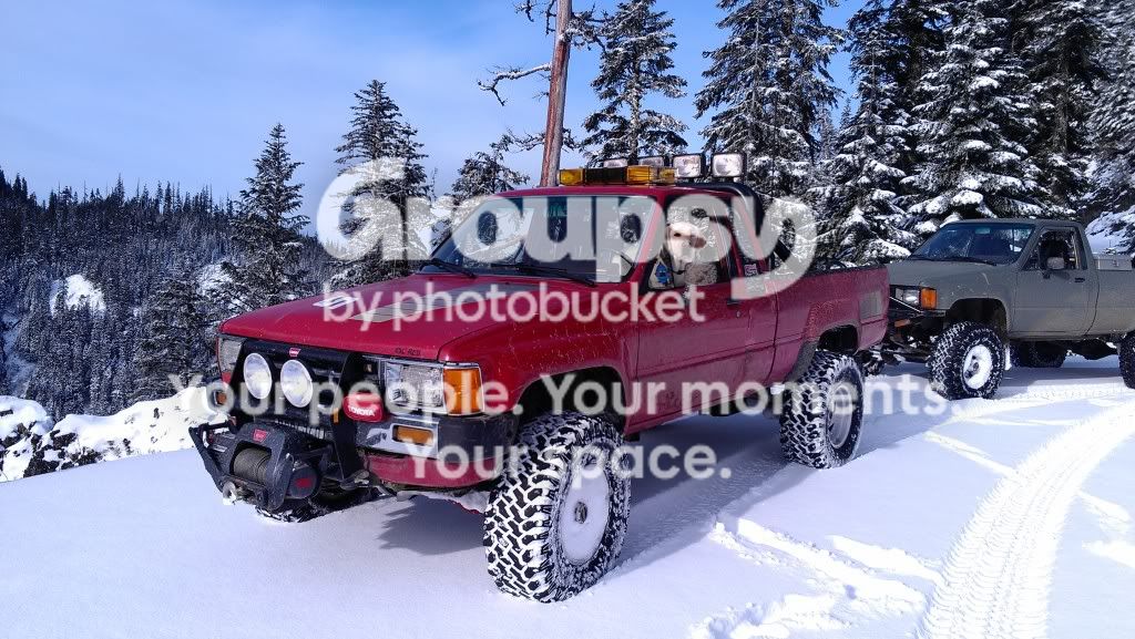

My dad installed the winch on my 4Runner before I inherited it about 7 years ago or so. He just bolted on a plate onto the frame from the looks of it. It's done a ton of work and no issue. It also sat recessed into the bumper and in the front lip so besides the cable you wouldn't know there was a winch.
There are just 8 bolts in shear holding 1/4" plate or so that the winch is mounted to onto the frame.

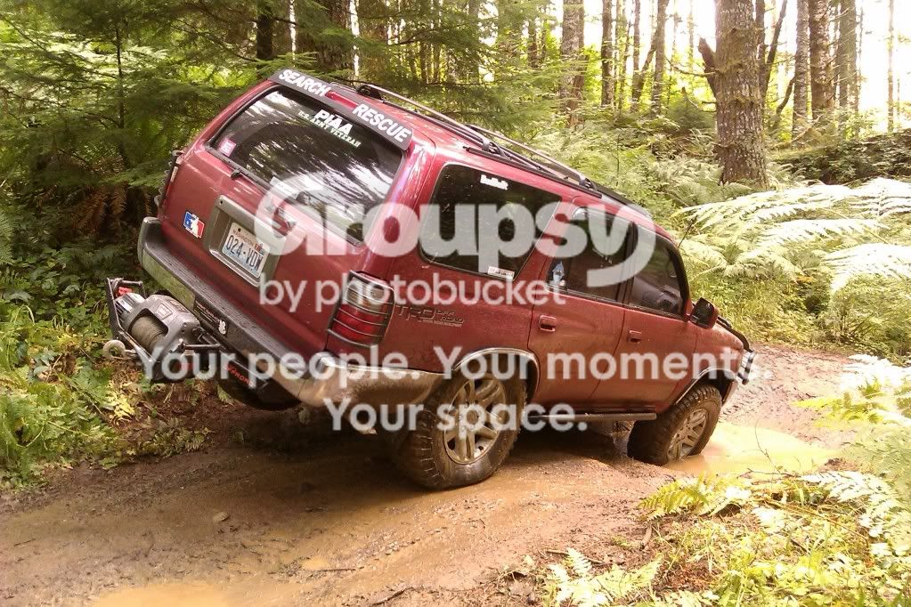

Receiver mounted winches are great because they can easily be moved from front to back on your rig or to another truck, but they have two major downsides. 1) As mentioned they significantly decrease the approach/departure angle. 2) They are not good for side pulls because of the long lever arm of the hitch adapter.
