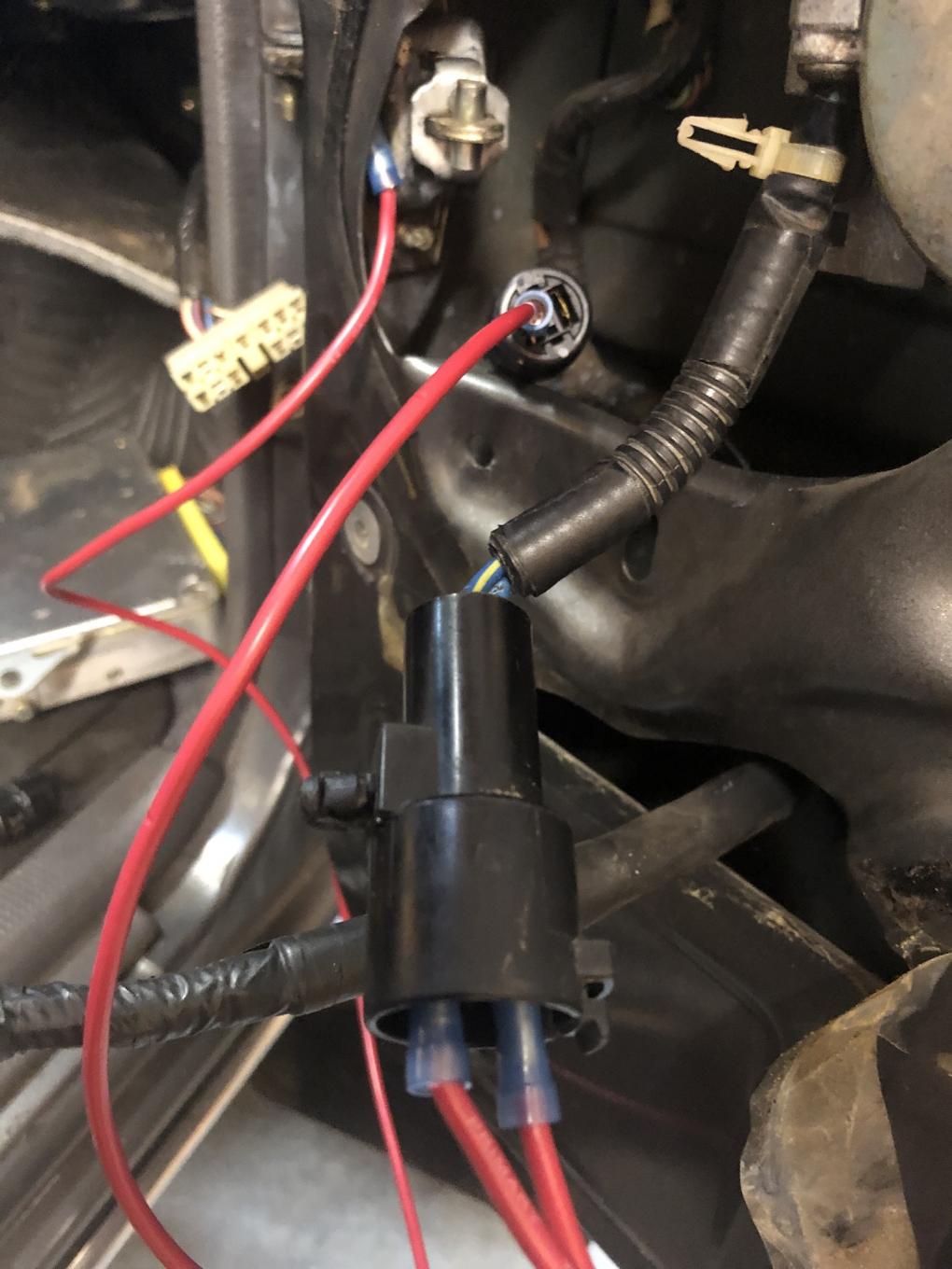

I can’t get my passenger window to go up or down with either switch. I’m getting voltage to the terminals at the motor plug. One terminal up and the other terminal when I push switch down. I don’t get continuity to ground on the in-energized terminal. I’m able to make the motor work when I run a ground wire. I did replace the passenger switch with switch docor replacement. Any ideas B8F108BE-DA76-4660-9CA8-4284D932C65D.jpg
