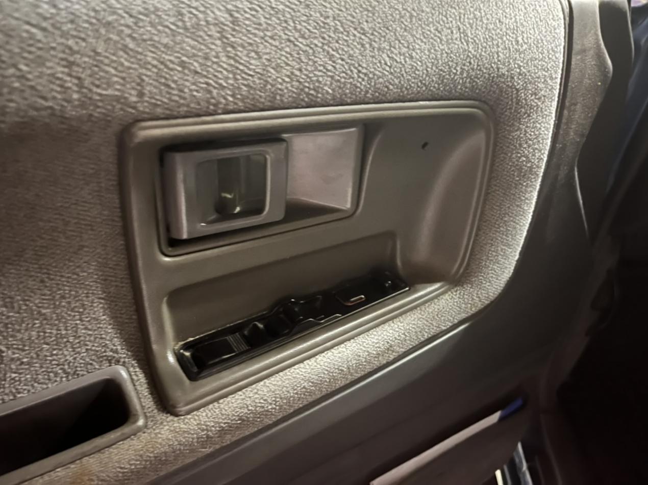

‘89 4Runner Window Switch. Can anyone help me on how to remove this switch panel? Do I need to remove the door card?
I’m thinking I have a bad contact. Passenger window works, door lock works and when I press the up button, it’s drawing power because the door light dims. However, it doesn’t dim when I press down.
I’ve owned the truck for 20 years. I’m not mechanically inclined, which is why I enjoy owning a Toyota. Appreciate any insight.

Don't attempt to pry that switch out of the door card....ask me how I know this....Those are screwed in from below and require you to pull the door card to access. That entire switch disassembles as one piece. When I cleaned mine up, I used 1000 grit sandpaper on the contacts followed by a pencil eraser. Everything works flawlessly now. If your door card plastic clips break or are missing, Toyota has the stock replacements at a reasonable cost, so much so that I bought enough to repair both doors if necessary.
