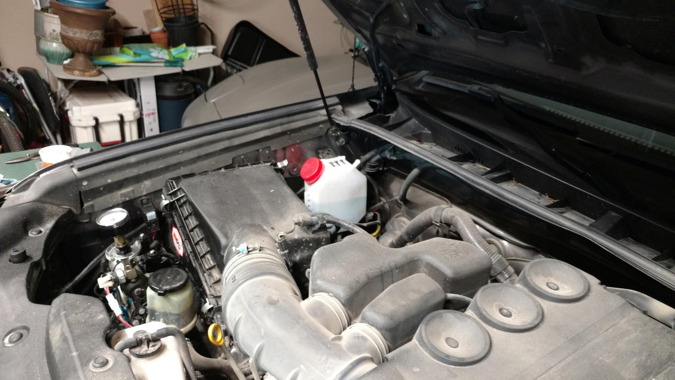

I spent ten bucks and relocated mine. Just used a cheapo generic small washer bottle from an auto parts store. It gets the job done.... Just cut a hole in the bottom and put the motor from the original in it. Required a little RTV to help the grommet seal good. But no leaks now....
