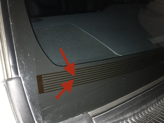

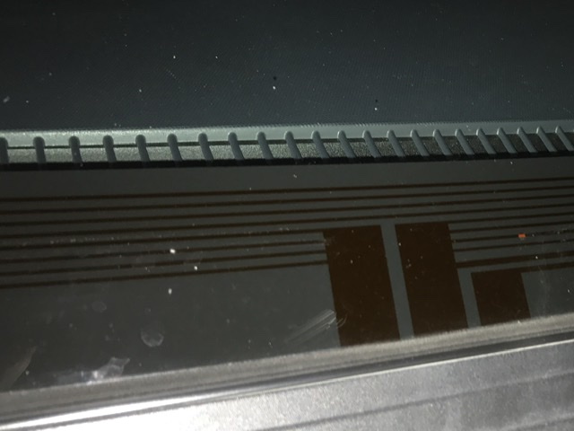

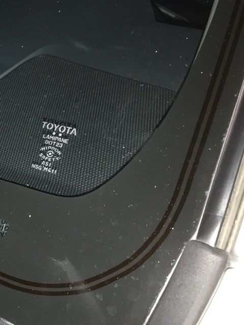

That’s interesting. I’ve never paid much attention to that heating strip, I haven’t used mine yet. But looking at the lower center of the windshield, you can see the +12v and GND tabs and the embedded wires that heat the wiper areas; four come off the +12 and four return to GND. Also a vertical offshoot that goes up the driver side by the A pillar area. I would guess that your passenger side has a crack in the center area that bridged the +12 and GND wires. Probably got some water or dirt in there that shorted across two wires, creating a hot spot that boiled off the water and burned up the debris in the crack. As long as you don’t turn it on it shouldn’t compromise your windshield any further.
