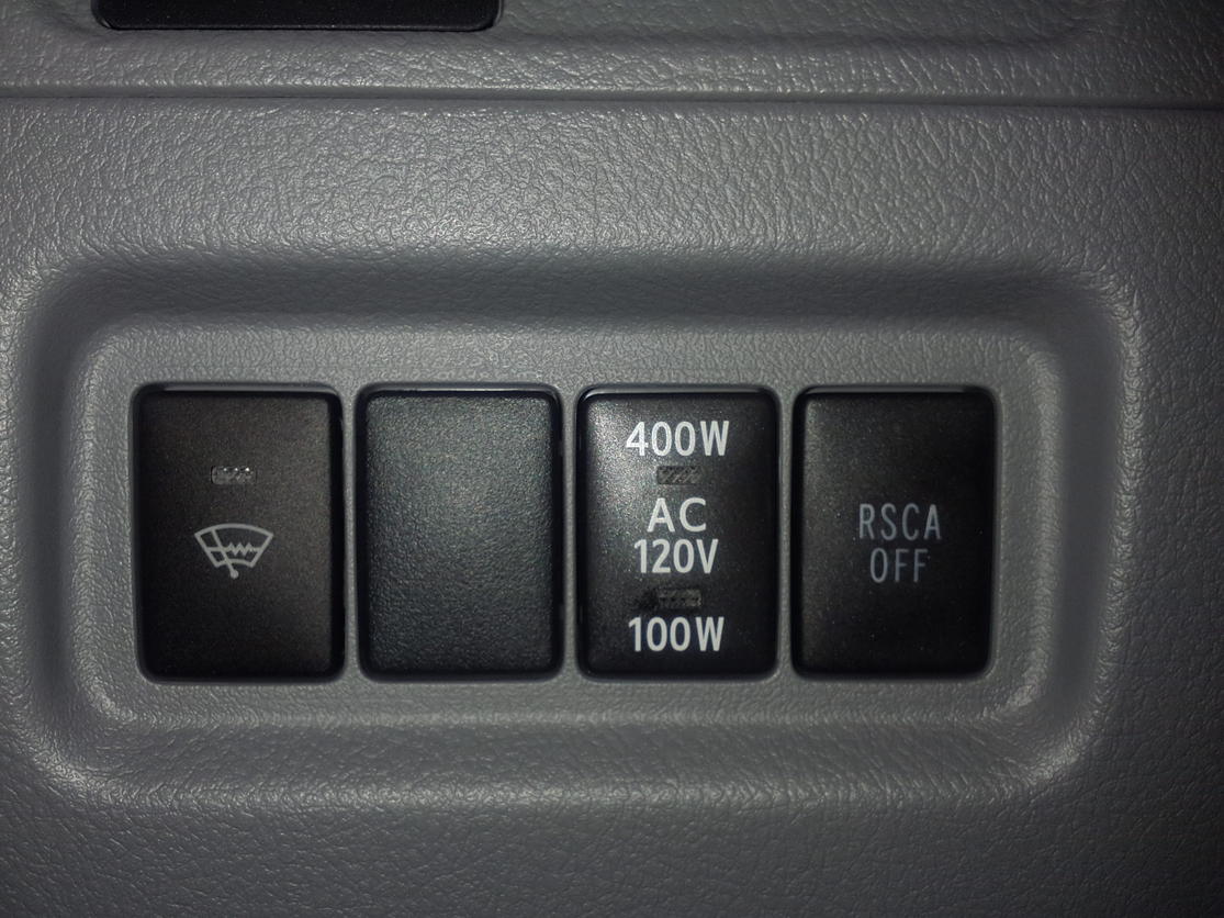

Perhaps a stupid question, but I'm assuming you don't have the windshield wiper de-icers on your 'Runner? Mine has a button for that.
Wipers
Did the switch on the left help??
Well here's a dumb response - Not that I know of. I KNOW my Tacoma doesn't have windhshield wiper de-icers. I didn't think my wife's 4Runner had them, but that's not something I've ever needed to use before. Maybe I overlooked something. Is it an option or standard equipment?
Regardless, what do you do on vehicles that don't ww de-icers?

My wife left to go check on her mother, so the 4Runner isn't here right now. I can't check - is that standard equipment or an option?
Thanks,
David
It was standard on my 2013 Trail, but I think I will get the Rain-X De-icer too.
--- BobH
I remember there being some threads about this a while back and I don't think it was ever really pinned down as to why some have it and some don't. Maybe it's a regional thing. I have it on my 2011 SR5 w/ premium package.
Dunno. I have a 2014 SR5 Premium 4x4. I didn't even know about the feature until I got the truck home & was looking through the manual. I know it wasn't a standalone option, but it may be part of the Premium package.
