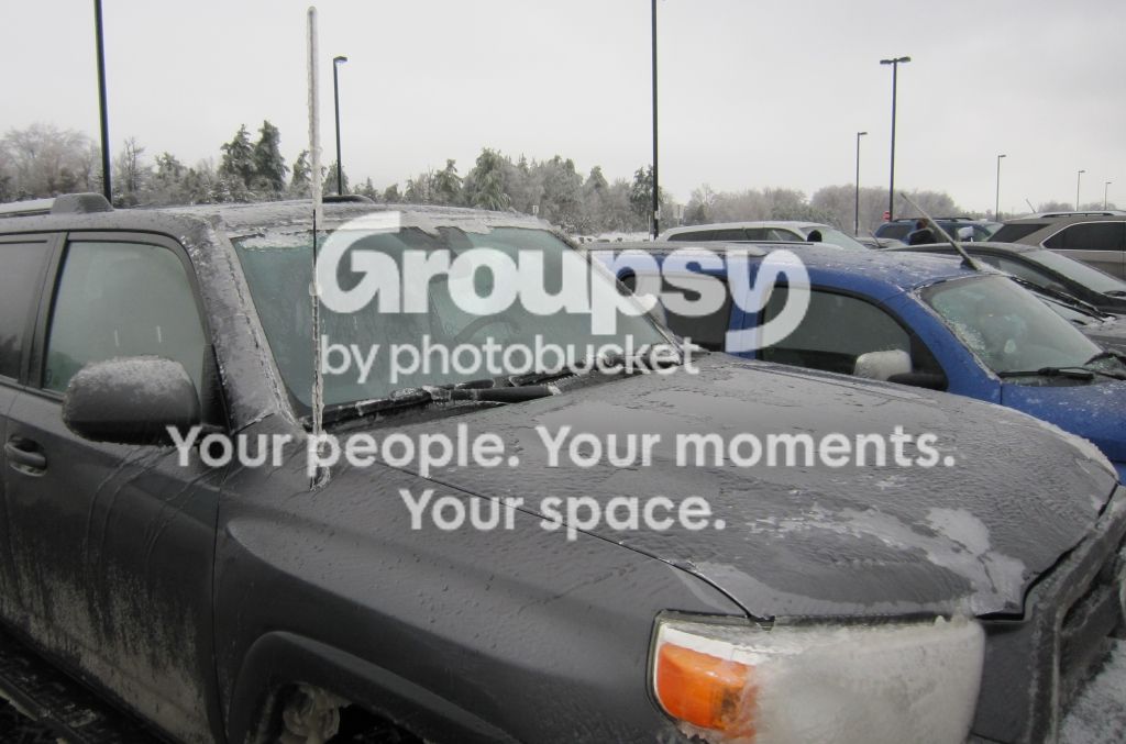

I had to drive in freezing rain few days ago and I was just fine with air blowing on windshield and wipers heater on. I took a picture during a lunch stop, by the time I got to my destination I had bigger build up of ice everywhere including external side of windshield wipers. But windshield was clear - wipers did their job good.
ice.jpg~original

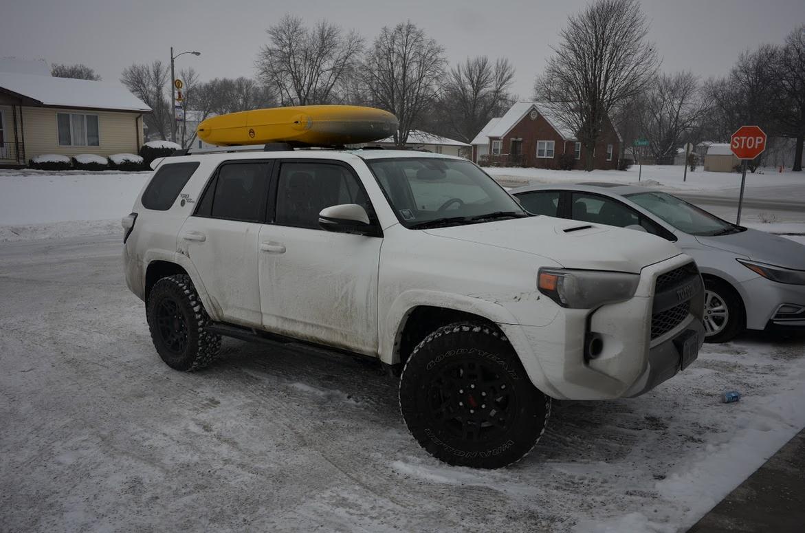

We recently came home from a trip out west and through Iowa on I80 the weather conditions went from cold (-2 on the dash) to cold with a spit of sleet. The ice built up on the windshield almost immediately from about 2/3rds from the top. The defrost on full couldn't keep the buildup from subsiding, so I kept the wipers running and spraying ant freeze wiper fluid to keep some of the windshield clear. Since we were far from home and it was getting later in the day we decided to just get a room for the night. Headlights were frozen over as well so they were becoming ineffective too.
As you can see in the pic, the entire front of the vehicle has about a 1/8" layer of dirty ice on it. You can also wee the 1/2" thick coating of blue antifreeze windshield washer fluid building up on the roof box. About 70 miles later we pulled off and got a room. No reason to try this at night.
The next day we counted 35 vehicles that had spun out and in some cases rolled in the median and the ditches on either side of the highway.
