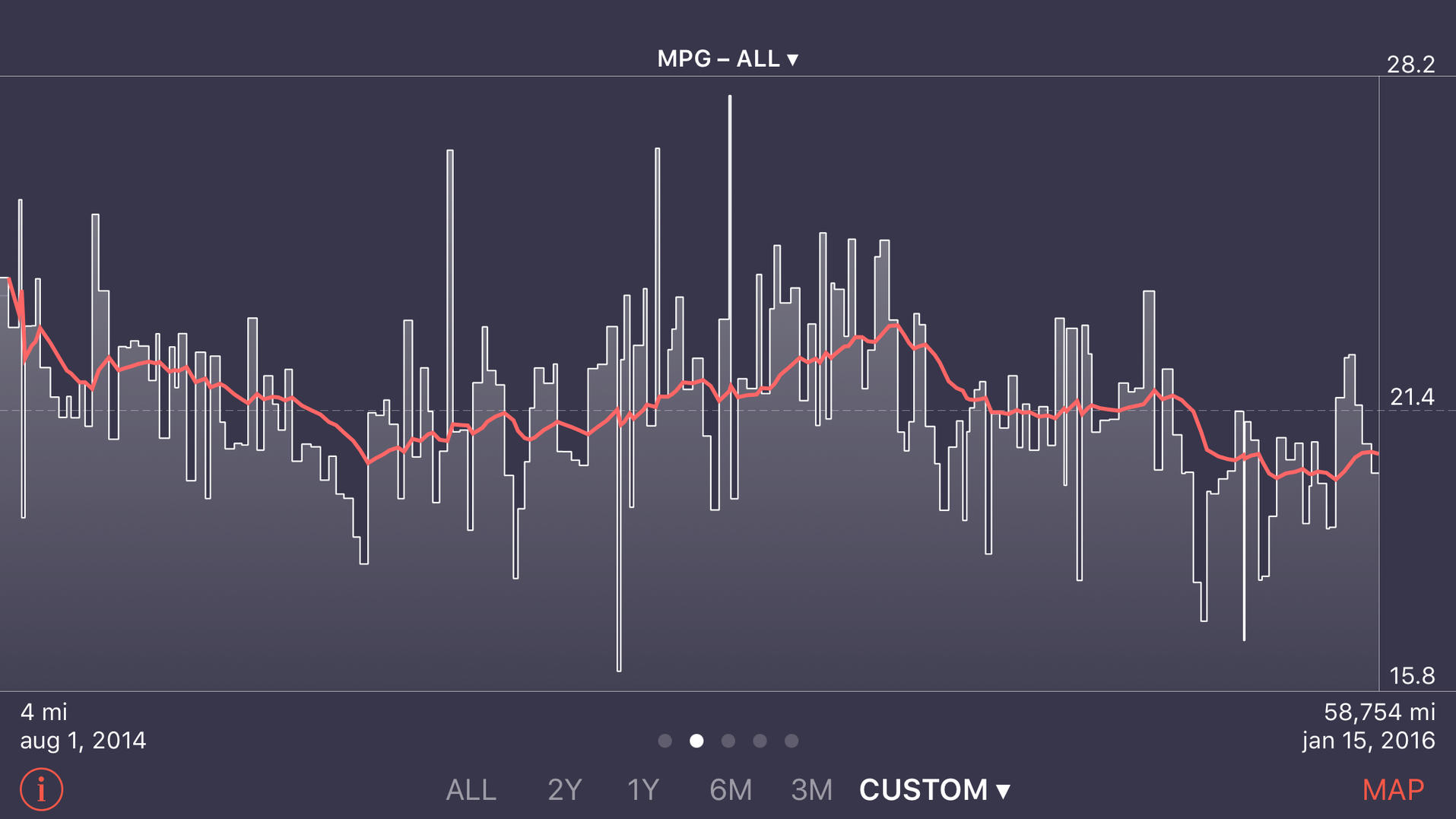

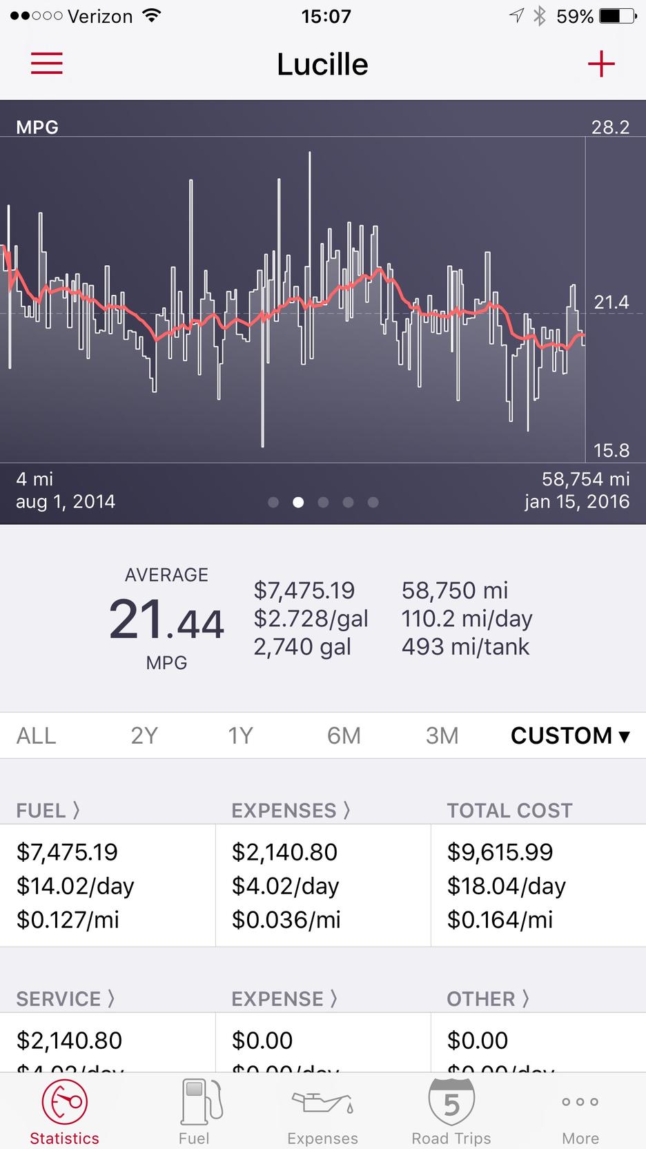

To follow along with your other thread, below is the graph of my MPG (hand calc'd using Road Trip iPhone app) from beginning of ownership (4mi on odo) thru now:
Notice how the MPG goes down, then back up...following the trend of worse MPG during winter months and better during summer months? :) :use:
Here are the overall stats:

There are many factors that cause worse mileage in the winter:
- Increased aerodynamic drag due to denser cold air. Drag forces are about 10% greater at 15 ºF than they are at 70 ºF. (larger effect on highway than city).
- Tires are more likely to be under-inflated at cold temperatures.
- Cold oil reduces the efficiency of the engine (larger effect for short trips).
- People are more likely to idle their car (remote start and/or leaving the car running during errands).
