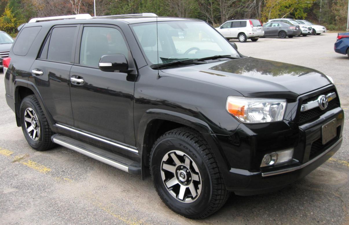

After running two Canadian winters on my Michelin Premier LTX 245/60R20 Michelin Premier all-season tires (20" Limited rims), I began searching for a second set of OEM alloy rims last summer (2018) to run a set of dedicated winters.
I found some 2018 TRD Off-Road take-off rims with very low mileage at a reasonable price, and then installed Toyo Observe GSi-5 265/70R17 winter tires. Fit perfectly on my 2011 Limited.
The Toyos did a very good job up here in Northern Ontario.
Having a second set of rims removes some of the hassle associated with the seasonal changeovers with only one set of rims. The winter rims may take a beating (corrosion!) if road salt is used on your roads. That is why I decided not to run steelies - they rust far too quickly up here.
