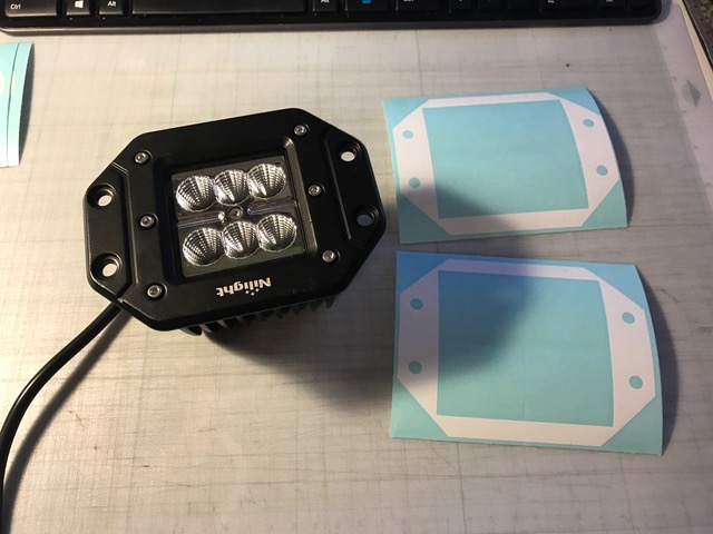

I'm about to do the same install. I made some vinyl decals of the light dimensions to help placement/alignment and cutting into the bumper. IF anyone wants a set, let me know, it should help make the install easier.
