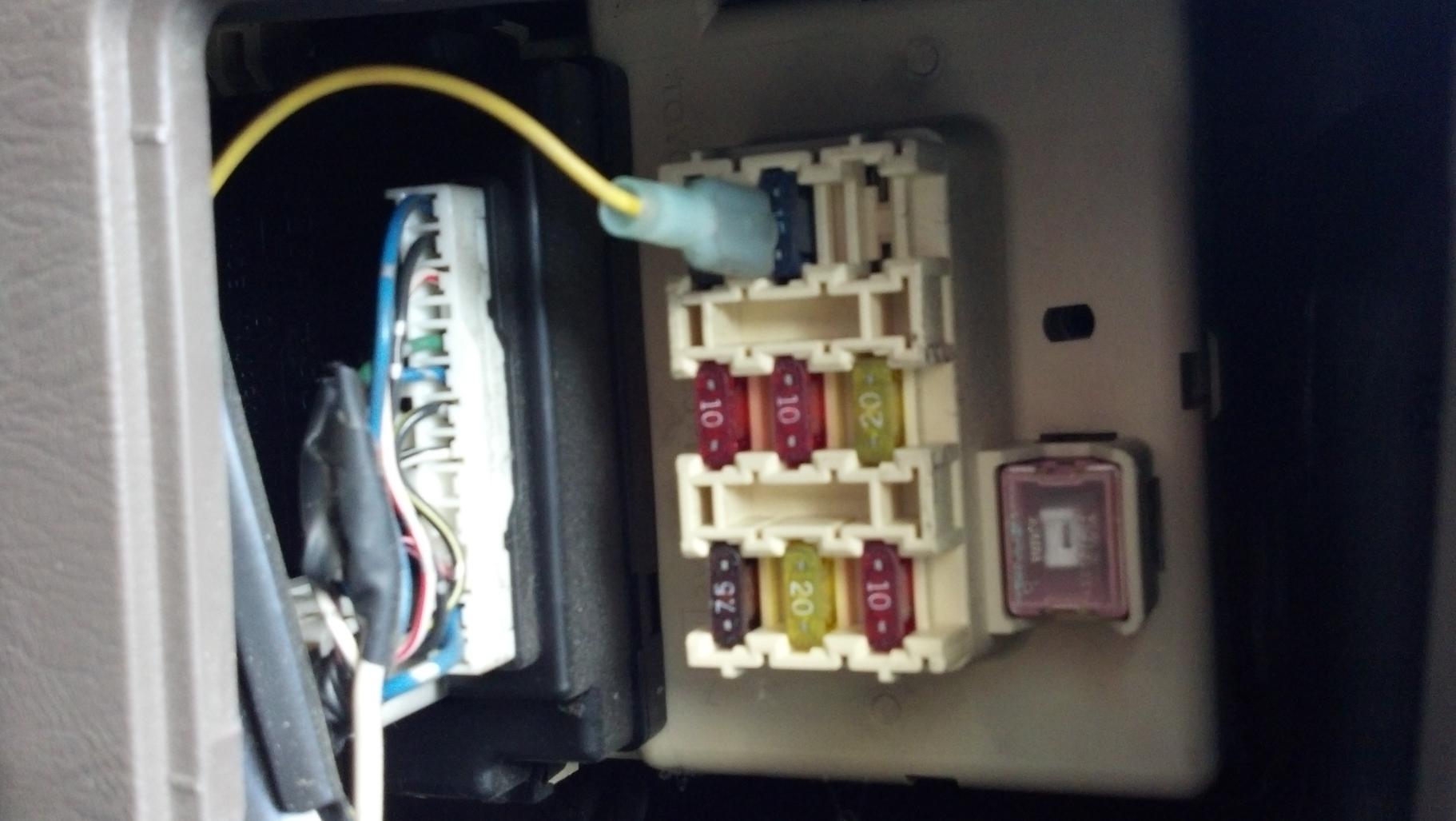

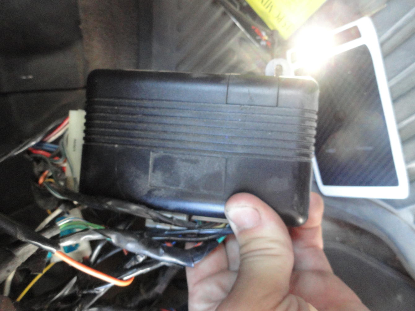

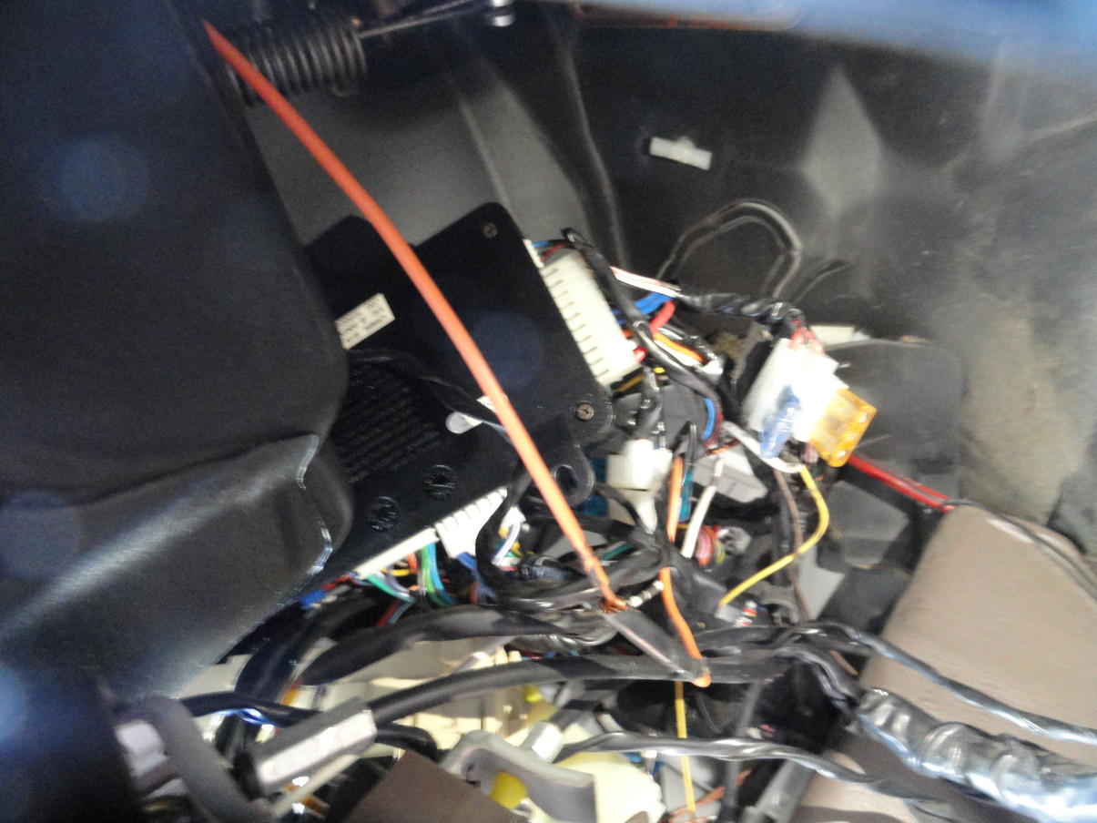

hear are some pics of the fuses etc, and some black box thingy from behind it. no idea what it is so any insight into that would alos be appreciated. thanks guys,

yeah i don't even know what's going on there, alot of your wiring isn;t normal and is a rats nest, i'm not a wiring guy in the first place, so i'll just say that but you got some issues going on there, get it cleaned up and track that line coming off the fuse...wtf is that for?
that black box thing looks like it could be an old alarm. hard to say without seeing where the wires go but looks like it. if the wires go to the starter, 12 volt wire, n ground n bunch of other little wires, its most likely old alarm. as for the radio, i suggest the wires (accessory, 12volt, and ground, and fuses unless there is no radio fuse). good luck mang!

Thats definitely an old alarm of some kind. It shouldn't have any effect on your radio though. The old speaker wire you found behind the radio may actually be connected to the alarm. Its easier to run speaker wire than 2 separate wires, say to a siren or power door lock. Double check the plugs you undid at the centre console. I know I've plugged the clock harness into the "blank" plug by accident several times before.

My suspicions are that:
The little black box with the RCA output plugs and the 3 wires is a "Line Level Adapter" This would allow you to (poorly) supply a low-level signal to an aftermarket amp through those RCA cables, while using the factory head unit.
The blue wire that goes to the back is the amp remote. It would have 12v whenever the radio would be on (like when the ignition was on)
You would be best served to pull everything out that doesn't look like it came from the factory. This will eliminate a lot of potential problems.
