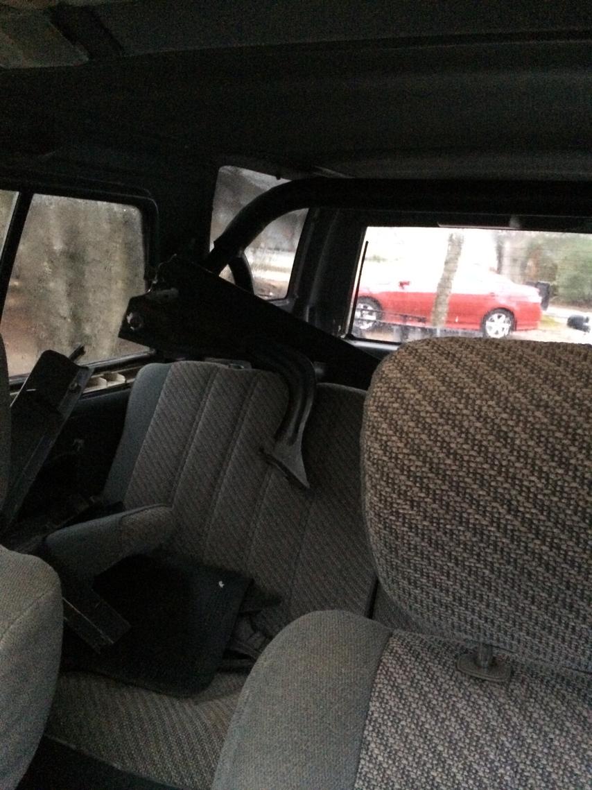

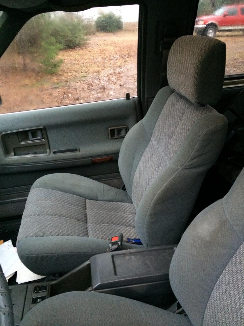

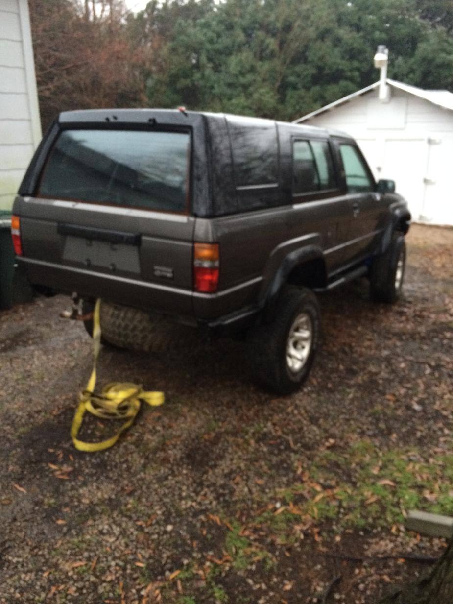

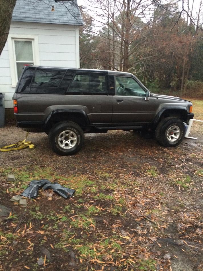

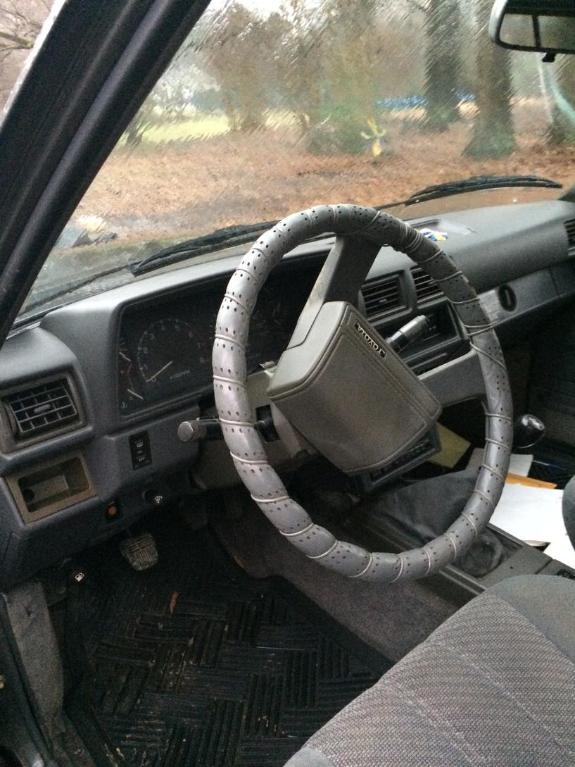

ok heres what im working with, unfortunately for me its pouring rain here so no fun today. but anyways here she is
