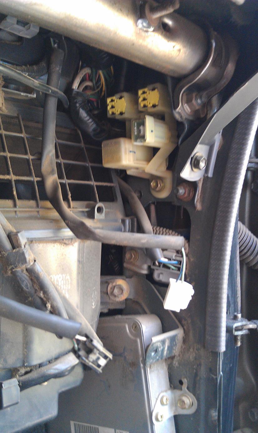

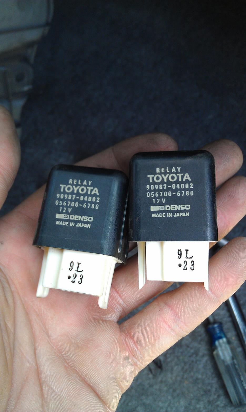

i pulled out the glove box and their are two relays none of which are the circut opening relays both are identical does every 4runner have one on every year? the research ive done in here leads me to belive that the 92 are diffent than what most people have on here.

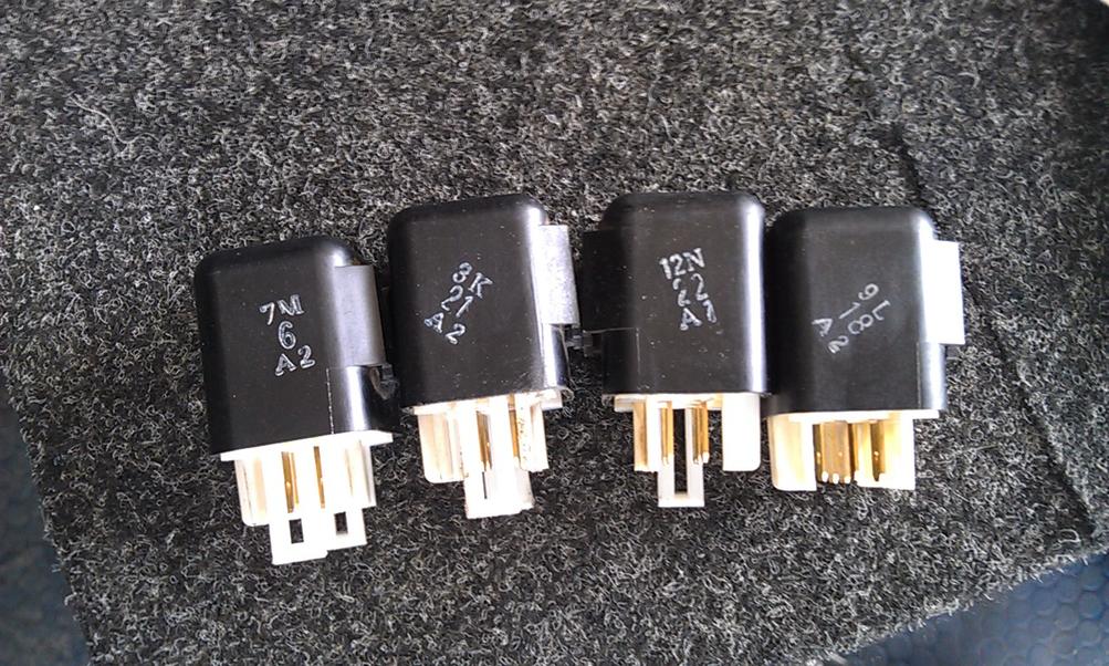

ive all ready tired 4 other fuel pump relays and none of them work could it be that every relay i picked was bad? the relays were all identical except the stamp on the side which i thought was just a lot number. or do these markings mean something?
