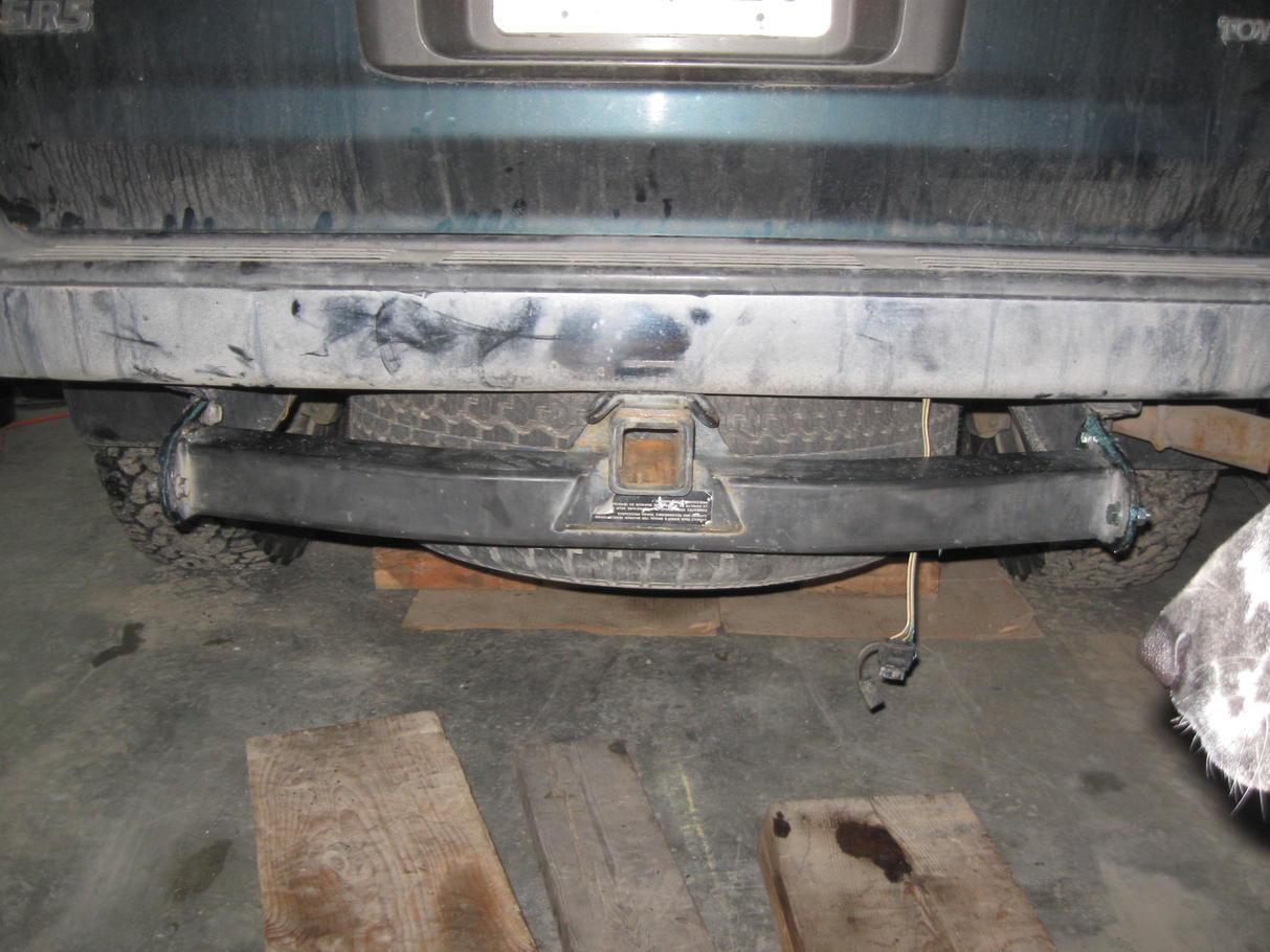

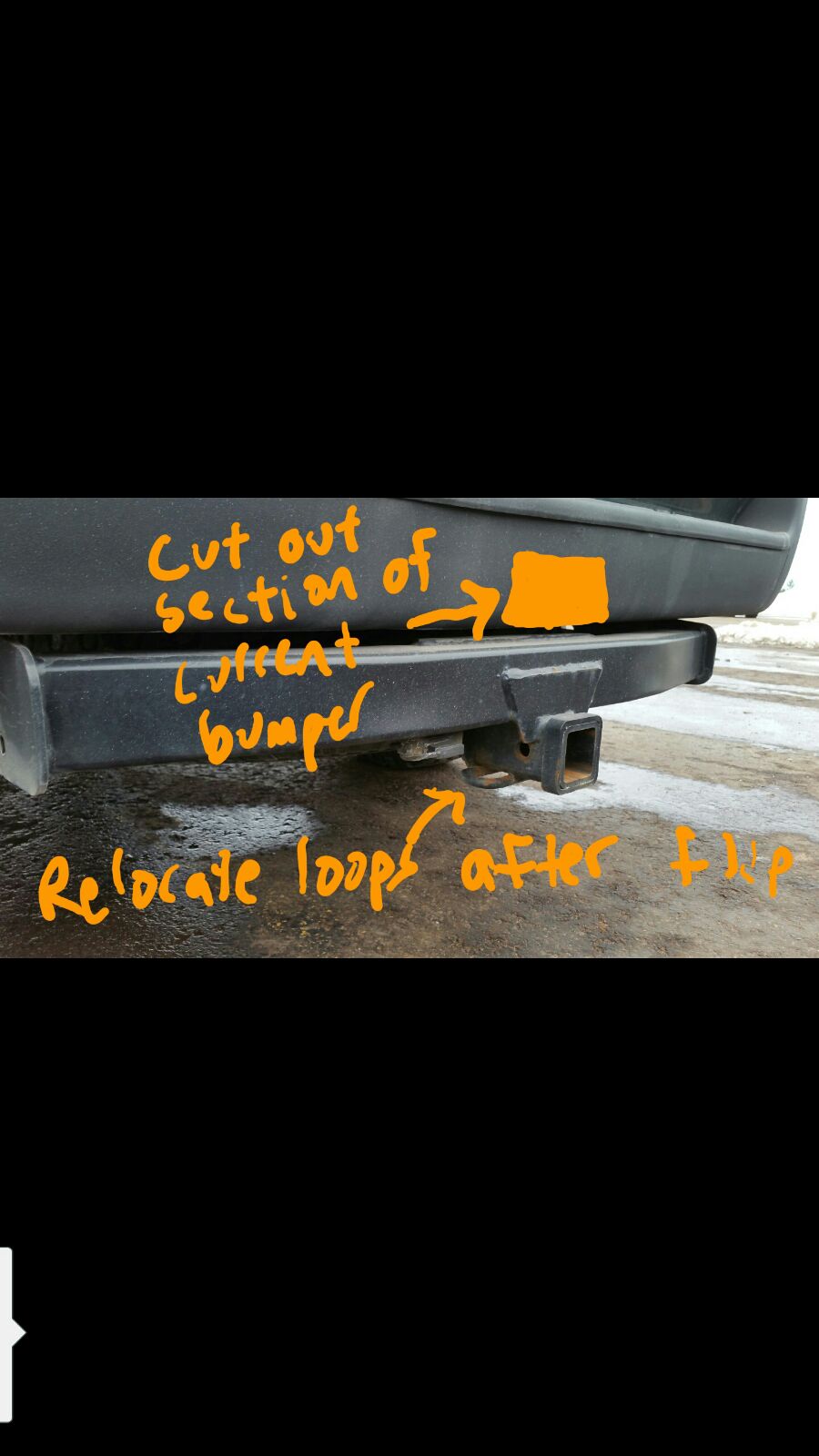

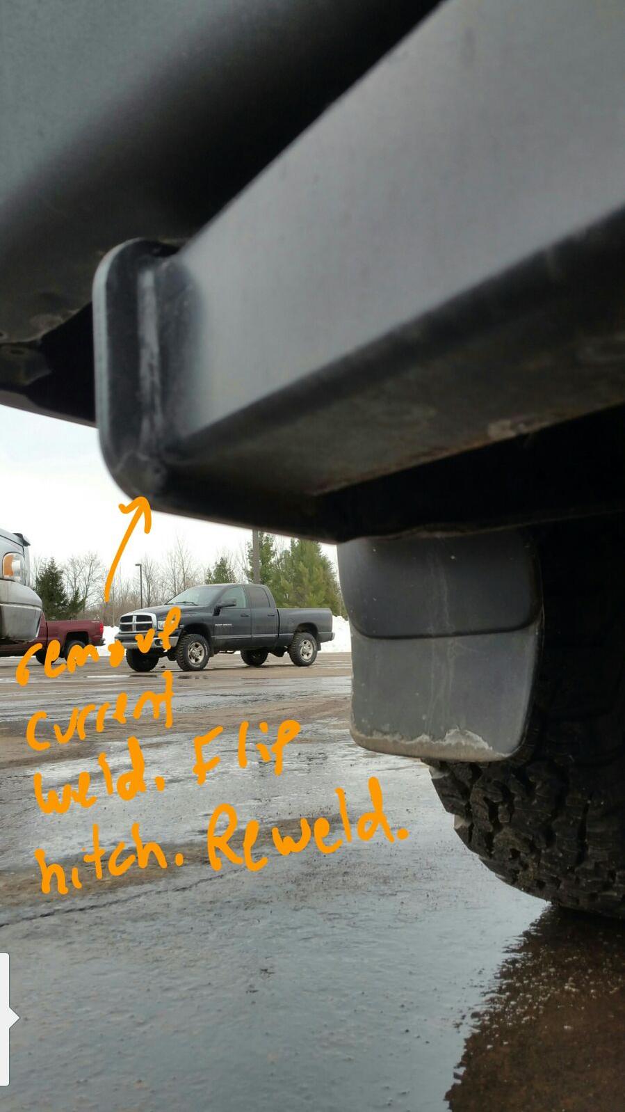

I have a metal fabrication shop working on my 4runner. Could they just break the weld, flip the hitch, and reweld?? A bit more work but still doable.
Or is there a geometric reason the hitch flip won't work with the welded bumper?

The bolt together allows the exact same thing your talking about doing. If you want to with this hitch cut it loose, flip it, re-weld it back on. If you put a 1" body lift on it fits perfectly under the bumper without cutting anything out. Just bend the safety chain hoops down nothing else needed to be done. Paint the new to keep rust down and when coating will flake off when you bend the hoops.
Then again for less than the cost and effort you mentioned....get a bolt together from a wrecking yard!

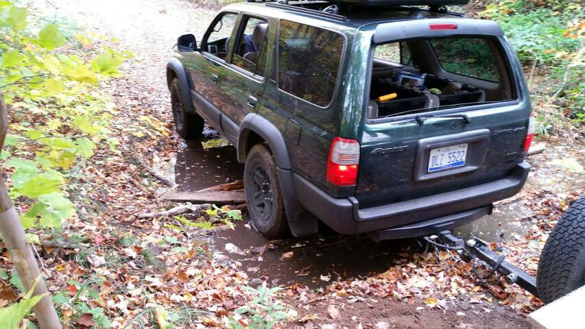

Last summer we dug our hitch several times pulling a teardrop trailer offroad. Those rollers got us everytime. The trailer got the offroad package install this winter - and now we need to raise the 4runner hitch height to match.

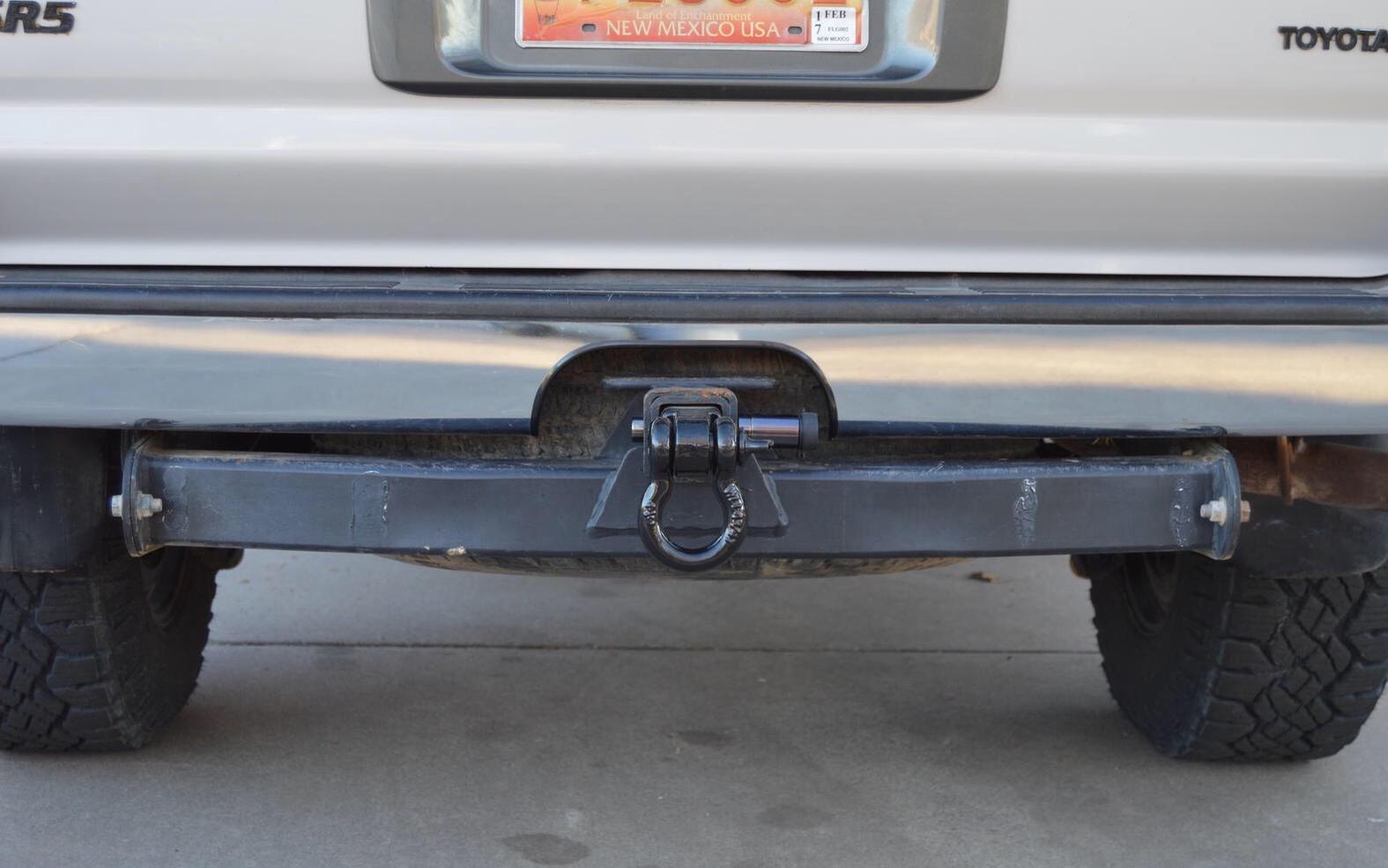

The hitch will still protect as the bar still goes straight across, you just don't have the receiver hanging down gouging into everything you come off of. The extra height was nice for the bike rack, too. You do have to cut a square into the bumper though. I was okay with that. Old pic of my second mod:

If you went with the cut and re-weld you are not compromising anything. Well....If you have someone who knows how to weld....a professional fabrication shop should be fine.
Yes you can hack up your bumper....why???...for about $40 bucks or $100 if you buy one you can put a 1" body lift on in a couple hours. (Stupid Easy!!)
You will not gain 5" of height gain....only 3"....no there are none available (I could not find any) that will gain you any more than 1". So if your going to buy a aftermarket....just flip the one you have.
Easiest....just get a 3" drop receiver and reverse it...bam...done. You just don't gain any receiver/ground clearance.
