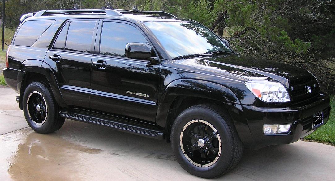

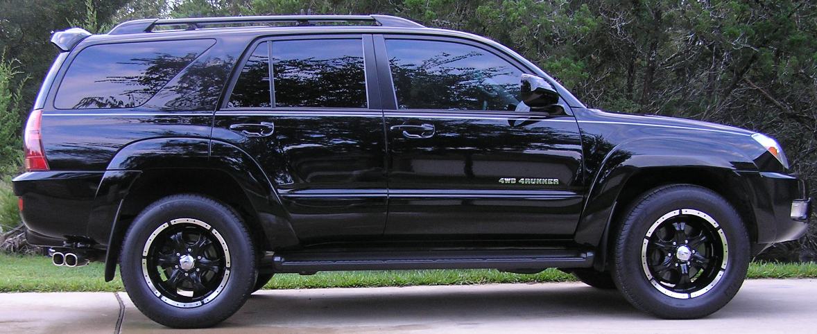

Well Fellas,
They worked like a champ and I have plenty of clearance. Best part....they look really sharp and fill my wheel wells perfectly. Thanks for all your help. Here are a few pics.

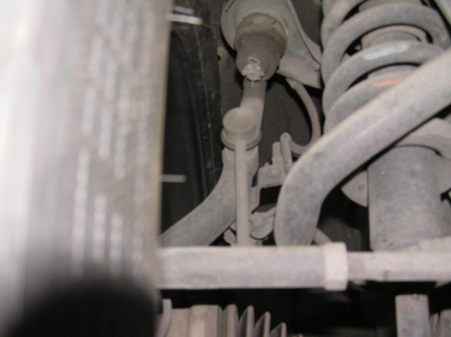

Clearance
Suprisingly have roughly the same clearance I had with the OEM 17" Limited Wheels
Eh hem! What did i say earlier in the thread? I told you it would fit fine, but the other guy insisted it would not fit, its all good though, looking sharp!
Re: Re: Clearance
I never insisted his wheels wouldn't fit. I was simply saying that using YOUR numbers, those wheels wouldn't fit on my 4Runner because I don't have nearly the same around of clearance (inner) between my aftermarket tires and the suspension components. I'm lucky if I have 7mm of clearance with my OEM rims and the Discoverer ATR tires!
BTW, it looks like he has at least, if not more clearance with his new wheels than with OEM wheels. Maybe his backspacing has something to do with it. We never really got into a backspacing discussion.
