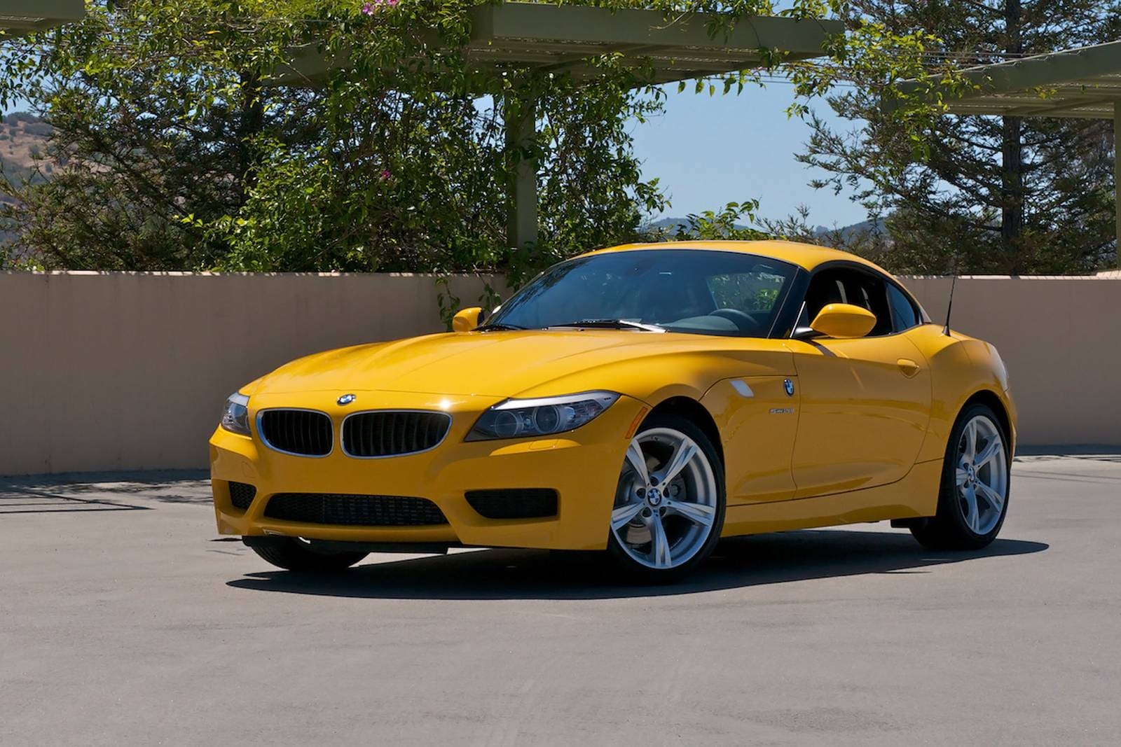

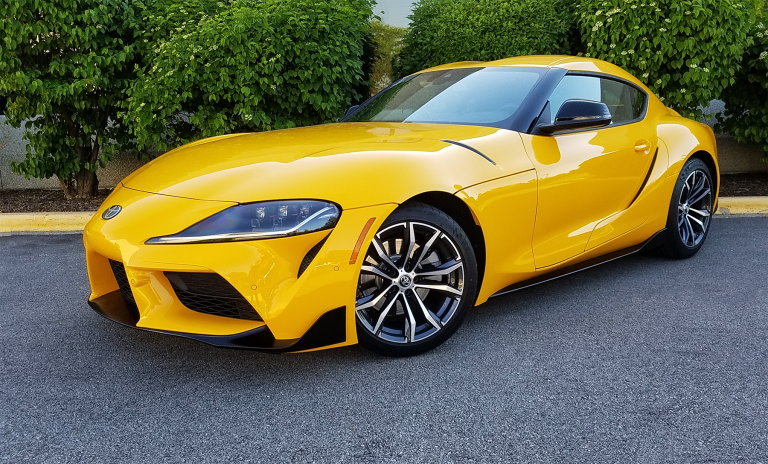

Yes! I like that Toyota brought back the Supra as it's been way too long since Toyota made a true sports car and let's be honest, the Lexus lineup has been nothing but cushy, heavy luxury sedans disguised as performance vehicles for years. What I don't like about the new Supra as it's more BMW than Toyota and looks way too much like the Z4. Can anyone tell beyond the badge and the headlights what is different???

Well same general shape. Just like you and I have 2 ears, 2 eyes and a nose yet otherwise Significantly different.
Biggest difference is everything, nothing is based on the pile of crxp z4, this is engineered to toyota specs for longevity And performance. It took bmw a while to achieve the longevity part of it, should help them too.
The newest update brings it closer to bmw's software allowing more tail swag around turns, fun fun....
Huh? Most body panels are different, but it is a BMW engine, transmission, chassis, suspension, etc. Built in the same factory as the Z4 by Magna Steyr.
Similar to the FRS/GT86/GR86 vs. BRZ. That one is a Subaru engine (with some Toyota fuel injection parts), chassis, suspension with an Aisin rear diff and transmissions, built in a Subaru factory. Oh, yeah, some of the interior parts are from other Toyotas too.
