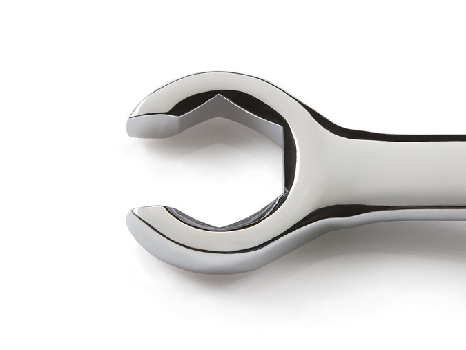

Its a semi special called a flare nut wrench. They look like this and its made for brake bleeding. Also works good as a box end wrench
You need a flare nut wrench. I bought this set from Tekton for my axle swap. Tekton are the best tools for the money. It's all I buy now.

Don't bother with special tools if it's already rounded, use vice grip pliers. Otherwise when you do replace yes you should use the nut wrenches, I got a 10mm one at lowes for like $4
