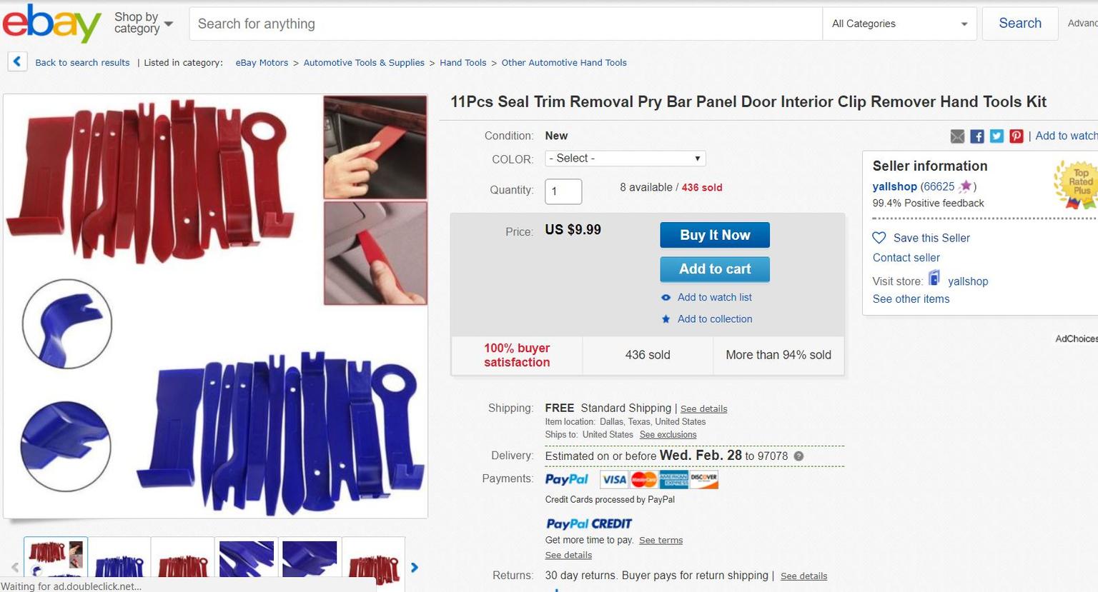

No it hasn't its just me being afraid of breaking stuff. Last time I tried to pull a panel off my BMW I ended up breaking a prong, why, because I was pulling from the wrong spot/wrong angle, why, because I couldn't find a good descriptive tutorial/write-up.

If you have one nearby, Harbor Freight has similar tools for local pickup. And yep they saved me a ton of trouble on another vehicle.
