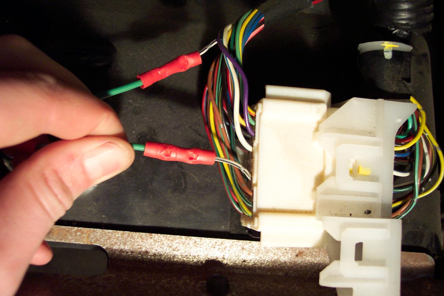

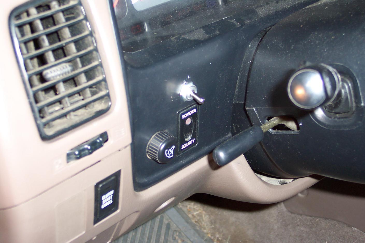

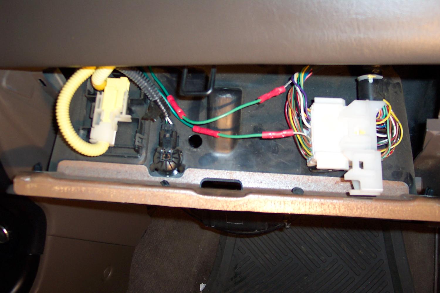

Ok so here's what I did. I'll just say that this is what worked for me on my 99 sr5 v6 5spd manual tcase.
I removed the glove box (2 phillips screws underneath) and the top plastic cover above the now empty glove box area (3 10mm bolts). Cut the white wire with black tracer (4wd transfer detection signal wire) and run the switch in series with that wire. Leave some slack on either side of the wire to be able to strip the wire for connections as well as put it back together if desired in the future. I just used wire I had lying around because its just a signal, and not load carrying. Check the pictures as to what I did. (note that the only reason there are two crimp connectors on each wire is because I had to lengthen the wires. I used to have the switch hidden in the glove box but that got annoying so I mounted it in the hole where my alarm light was.) When the truck is in 4lo the 4wd cluster light will be on, and when it is in 2lo it will turn off. Essentially all you are doing is tricking the tcase 4wd signal. Hope it helps!
