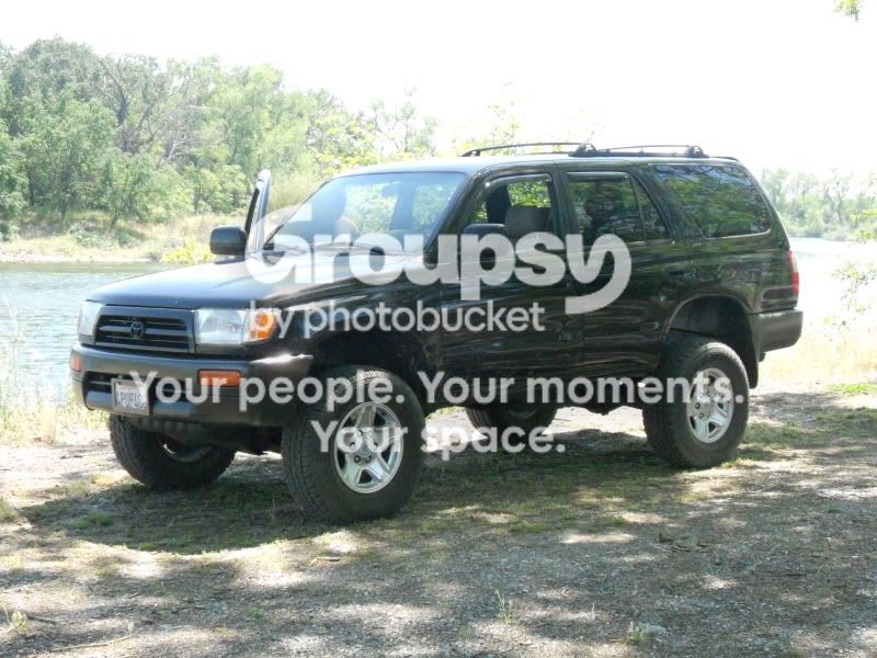

Wtf..Why so much lift?
OP: Did you use a top plate spacer in the front. I have read using between a 3/8"-1/2" spacer helps level things out.
Also, what size tires are in the picture. I am collecting parts now for the same lift and am tossing around the idea of going ahead with the lift install before I purchase new tires.
Thanks!
No spacers in the front. 265/70/16 tires. I'm gonna give it a little time and see if it will settle some. I will get spacers for the front if the rear does not settle.
I would assume taking them out nets less lift (although, how much I wasn't certain), but is there any bad effects of taking them out? I'm guessing they would stop me from bottoming out, but if I really going to be 90% of my driving on highways and back streets do I need them? What about when I start pulling my pop-up? Thanks all!
The cones are only ~1/4" thick so taking them out isn't going to be a big difference on your lift height. Lots of people run without them. But when I did, I could hear my coils rattling around down there and it was annoying so I put my cones back in. YMMV.
The cones are useless as bump stops with lift coils. The coil will compress and you'll hit the bump on the frame before the cone will do anything.
Well I just got back from driving about 300 miles. About 20 of it was off road/washboard and the rest hwy. Although the redonklious rake still bothers me, The ride quality on and off road is awesome. I've got 2" leveling spacers for the front coming and that should eliminate most of the rake.

Spacers installed on the front.
DSCN8325.jpg~original
38" Front
39" Rear..
I'm Happy now lol. Rides great so far..
