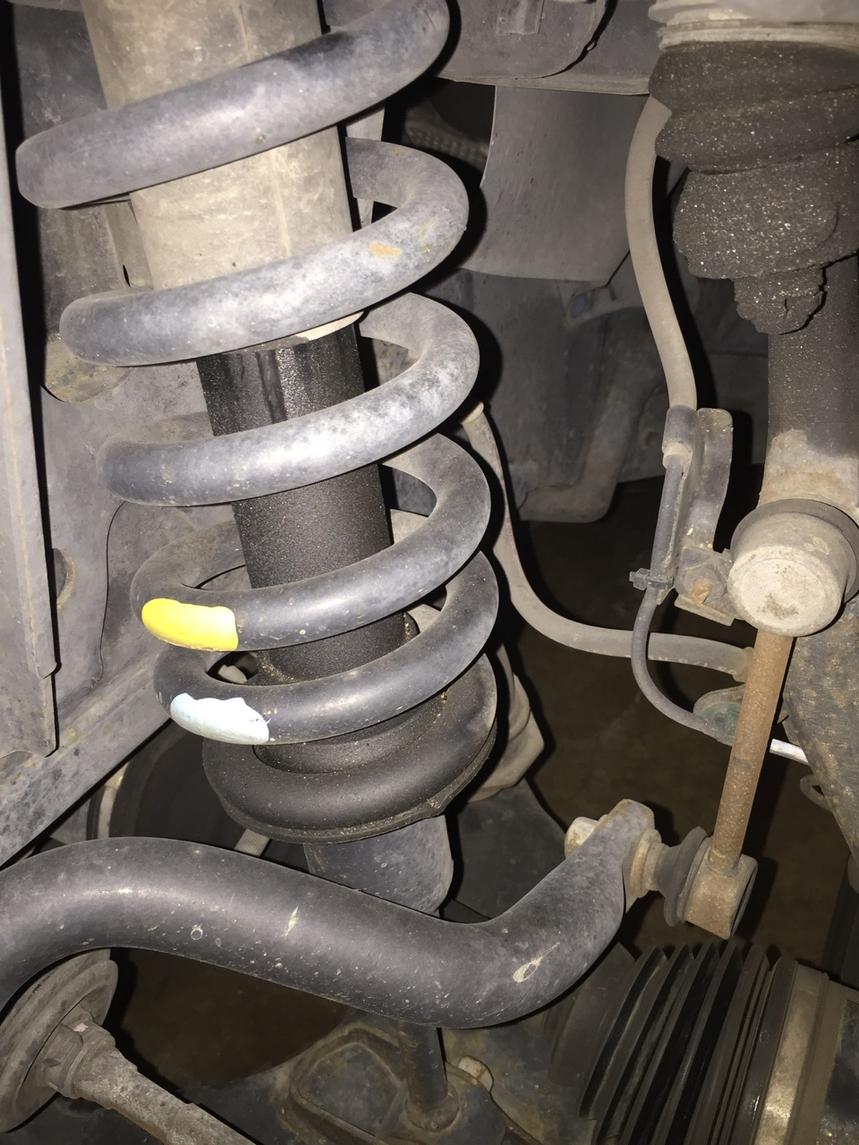

I will do the suspension stuff myself - that strut still has some life left in it.

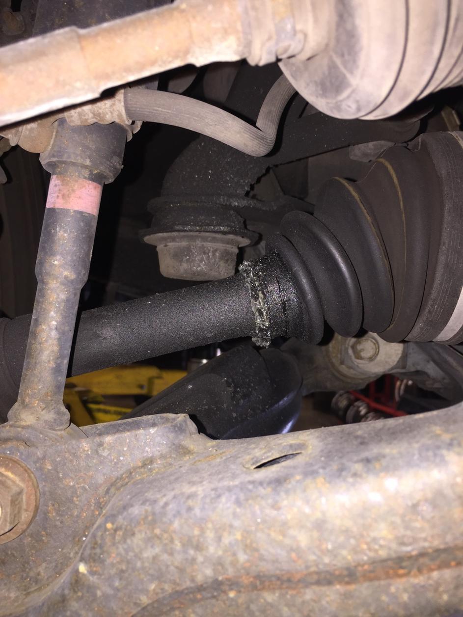

Your boots don't look torn, but it does look like it is leaking out the ends of the boot. I cut the old clamps off and replaced them with stainless steel hose clamps from McMaster-Carr. It cost a few bucks for 10. They have rounded edges so they don't cut into the rubber. There's a post somewhere about this which is where I got the idea.
