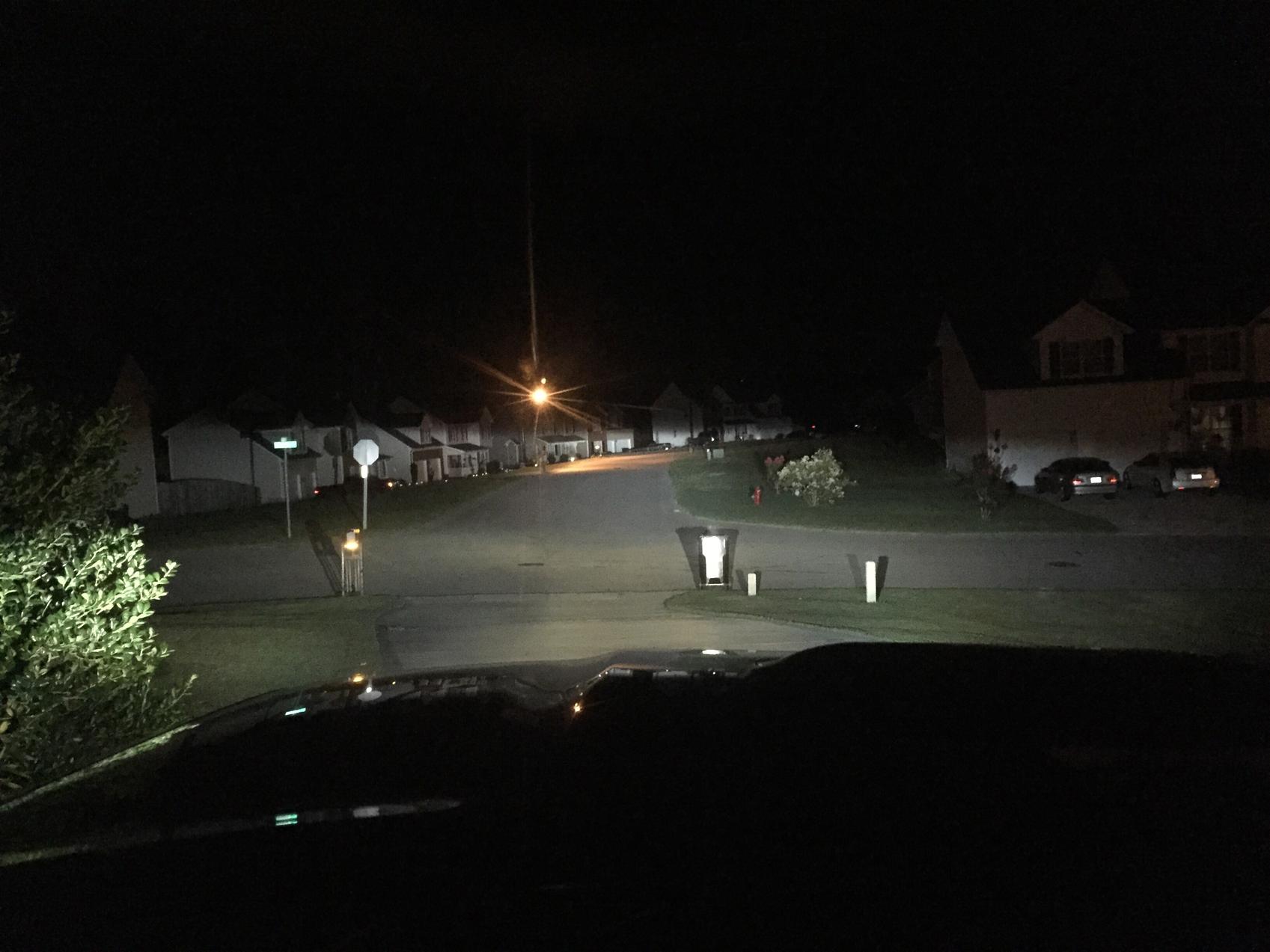

XD LED Low beams came in today
True, but I was tired and didn't want to wait for the sun to set fully. Additionally, the comparison is against sylvania ZXE bulbs which are already significantly brighter than stock.
I'm not fully sold on these bulbs yet. I think Xenondepot should've put both diodes on the same side. There's no point in lighting the back side of the projector. Secondly. I think these bulbs are more tuned to the "pre refresh" version. It doesn't appear they considered the dust covers for the headlight housings. The covers needs to stay because the projectors aren't watertight.
So [MENTION=12905]XenonDepot[/MENTION] ... Care to expand on this?? Seems like they're "almost" where they should be, but not quite.
Kind of having the same thoughts. I'm not very worried about the heat sink, but the fact that roughly half the light isn't doing anything is useless. Starting to think it would've been best for me to buy 4300k hids and yellow fog light bulbs.
Exactly, where I admit they're bright, the design seems a bit shortsighted and they could perform a lot better. [MENTION=12905]XenonDepot[/MENTION] I have an idea to fix the diode issue, I'll have a design drafted on viacad this week. PM me please.

I totally agree with you, I'm considering returning them or selling them. Because of the same reasons.
Op, just wondering, any reason in particular that you went with LED over HID? Not trying to sell anyone on the HID thing, just curious.
How are your LED fogs?
HID costs more! Lol, but really it's because I wanted every light to be LED. I absolutely love the LED fogs though, they're perfect.
I am somewhat confused regarding the LEDs being on both sides and 1/2 not being useable. Isn't the projector silvered on the inside in order to reflect whatever light comes off the back of the light source? If not, it is not using all of the energy being emitted by a halogen or HID bulb either. I must admit to not having seen the inside of a projector unit but I would think it wise to direct as much light out the front as possible and this would involve some sort of reflecting surface inside to take advantage of the source. Somewhat like a folded parabolic antenna for radio waves being used to create a concentrated beam.

thanks for the thorough response! Im going to give these a bit more time. We'll see how it goes.
Not to bad mouth the LED, but if you're looking for crisp color, already have the projector housing in your 5th gen. I'd suggest personally the HID. The 35W kit is the same price as the 50W kit. The only thing you have to factor is a 1000 kelvin drop in the 50W system. So 6500 becomes 5500. Mine is so bright I can see the future, with good cutoff not to blind anyone. Just my .02. Not trying to steer anyone away from LED, but having seen both, I personally think HID is the way to go unless you are wanting to do LED all the way around.
OP you're LEDs look good, I'm interested in hearing how your fogs do in the dust and dirt. I need to upgrade my fogs and see a lot of fire break roads, etc.

Can you put the low beam Xenon depot H11 led's in the fog lamps? I don't think they are very bright for driving at night. Mine look really dim at night, my stock fog lamps look way brighter than the Xenon low beam led's? Thinking of getting HID's in the low beams, do you thing it will work?
Thanks in advance.
Thanks in advance.
The fogs are H16 on the newer models but they might fit. The XD are way brighter than the Philips ones though. So you run the risk of blinding everyone.
