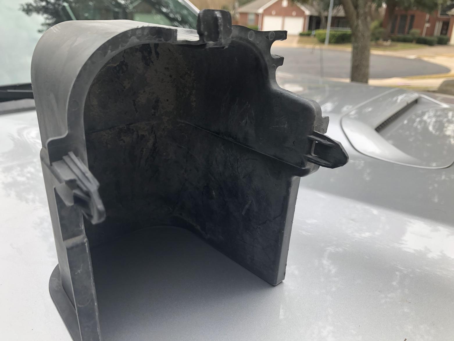

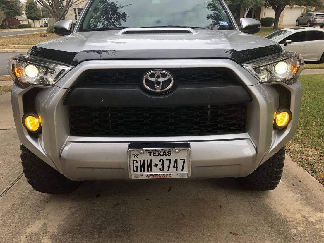

I picked up the H11 Xtreme HID (5K) and H16 Xtreme LED fogs(yellow) and finally got them installed this weekend. The fogs were way more difficult for me then the low beams. My passenger side fog was covered by a plastic case that made it difficult to remove the old bulb and impossible to install the new LED. I had to remove it to complete the install. The new LED would not fit with the heat sink spread out. See picture below. Luckily this thing was only on the P_side. Otherwise smooth install and impressive results.

yes, that thing is only on the P side. After 30sec dealing with it.. I ripped it the F out. Took me less than 10min to install the H16 Fogs, and they are great. I did the LaminX for daytime look. I also run the HID low beams.
