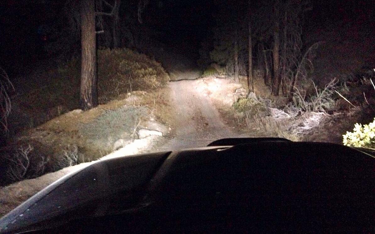

Alright, got the issue resolved and the new HID Xtreme's are fantastic. A HUGE shout out to [MENTION=102597]IBallEngineer[/MENTION] who took time out his morning to come to my house and diagnose the problem for me - thank you very much. Also wanted to give some props to [MENTION=12905]XenonDepot[/MENTION] for contacting me immediately when he saw there was an issue and offered all the phone support I needed.
The problem was a bad grounding wire that looked but was not making contact - I may have yanked on it when I was trying to tuck all the wires away neatly. I really need to spend some time learning to use the voltmeter properly so I can dig into electrical issues a little deeper.
Anyway, all is good and I am happy - took it for a drive through the forest tonight to make sure they worked off-road haha. Together with the ditch lights my night vision is 100% better than my old OE headlights so many night cruises are in my future :thumb:
