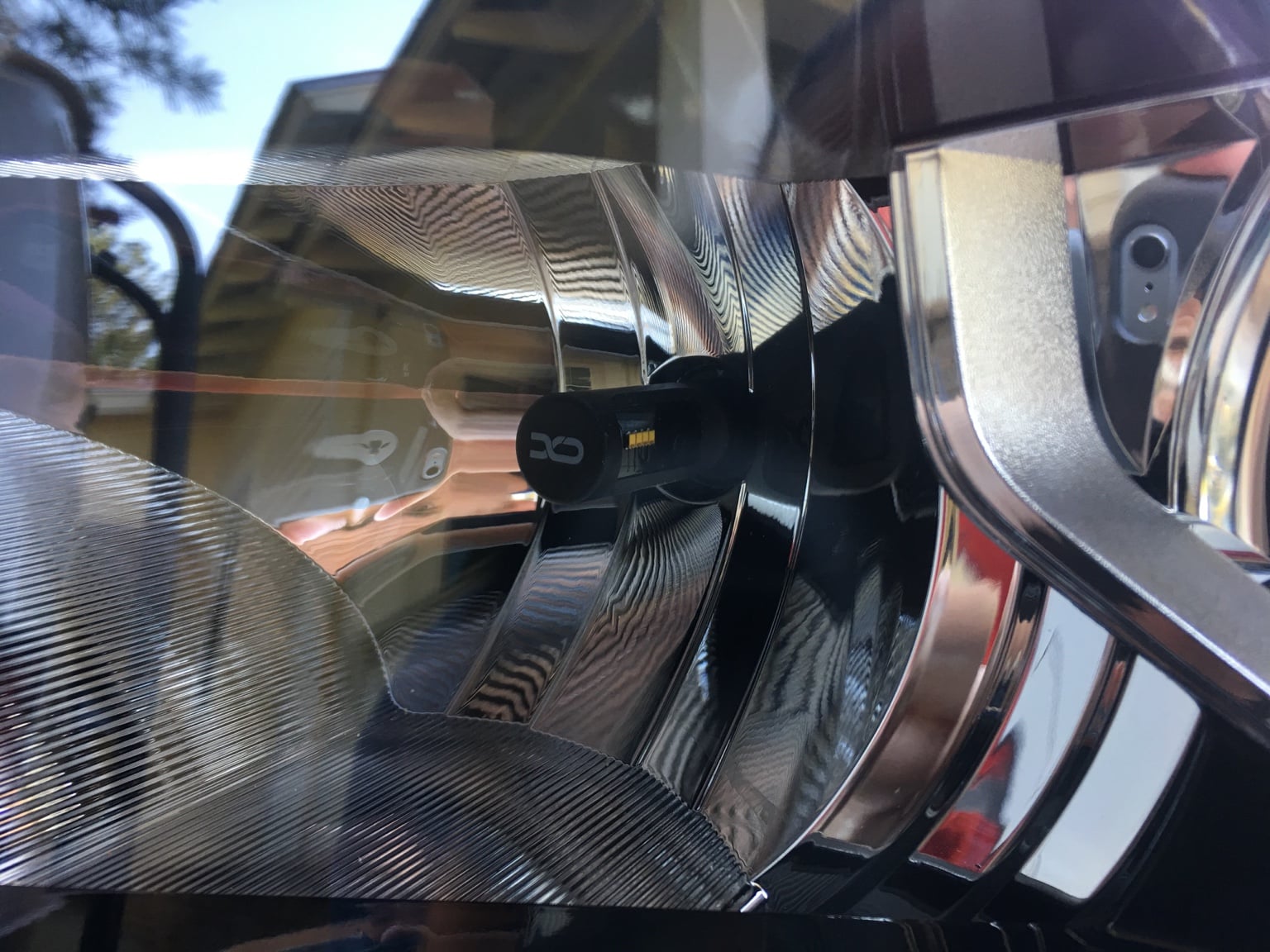

[MENTION=137794]JasonKoko[/MENTION],
Once installed, what is the orientation of the LED's in the housing, 12/6 o'clock or 3/9 o'clock position.
Looks like the diodes are facing 3/9 o'clock.
Hope this helps.
You can adjust the orientation on these
Yes. These have the ability to loosen the orientation and rotate them so the diodes face however you want.
I haven't messed with it but by doing this i believe you can change he beam pattern.
I'll see if I can do this with a video asap.
Hope this helps.
Thanks.
You will find they are going to direct the best forward light output in the 3/9 o'clock position in your high beam reflector.
If they were positioned the other way, I was going to suggest rotating them....
Sounds like you are good to go!
Thanks.
Cool!
Well I just turned one of the to the 12/6 position to test it out. I'll see if I can get good pix. It's super easy to adjust.

Ok - so I tested it out after dark and the 9/3 position through light way up high. 12/6 is optimal as you suggested.
Thanks.
Uhhh, not what I suggested....
YMMV
