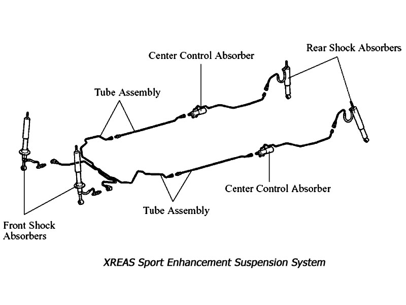

I have a 08 4runner limited with XREAS. I would like to put a small lift maybe 2-2.5"
If cost was not a factor, only ride quality.
What system or shock/lift combo would most closely duplicate the XREAS ride?

The body roll reduction of Xreas might be difficult to duplicate, especially if you want a lift. At least mine seemed very agile when I had Xreas.
If you have the money, I would recommend running Icon or King adjustable front coilovers custom valved to a street setting or with remote resi's and clickers for you to adjust yourself.
For the price though, its difficult not to recommend a Bilstein 5100s setup if it is just for the street.
To keep body roll down once you lift it, you will want a decently firm shock. I have my Icon CDC setting at their firmest which makes it stiffer over bumps (think sports car) but I find it feels very controlled this way and has a bit less body roll with my front sway bar removed.

If you want to closely duplicate the ride with little to no off-road enhancements, but you want a 2"ish lift I'd reccomend replacing your XREAS shocks with new XREAS shocks and add a 2" spacer lift by Daystar. IMO it's the best way to maintain factory ride plus add a little height to the look of your T4R.

Brand new Xreas ride quality should be similiar to Bilstein 5100s over bumps if not better with the Bilsteins, but the body roll will be greater. I only mention this because buying new Xreas shocks from your dealer will cost a fortune. Its possible, but it's like $2k or more from what I remember some quotes guys were getting one here.

I kept my xreas and did the daystar lift. everything seems to be fine. Ride quality is still just as good in my opinion.
Its not too pricey. I got about 2.5 inches of lift up front but lost a 1/2" with addition of a winch. It looks good with the right amount of lift - just waiting on tires now.
Thanks for the input man, you're fortunate that your XRAES was still good.
I'm forced to make a decision on replacement, mine are worn out.
I had XREAS in my 08 when I bought it. If its not blown, a spacer lift from [MENTION=9]Jason B[/MENTION] is a great option. If it is, its very costly to replace. I went orignally with Radflo 2.5 coils in the front and Icon in the rear. I like the Radflo a lot better. It feels smoother on the street and off road. I just ordered Radflo rears and am ditching the Icons.

New XREAS, $1700 parts and labor. (No lift)
Off-road shop:
Bilstien 5100 adjustable, says they can adjust the front and raise it 2-2.5 inches and add a 1-1.5" spacer to the rear if needed.
$1000 parts and labor
The shop insisted that the bilstiens will have a stiffer more sporty ride and hardly any body roll due to them being filled with nitrogen, rather than oil.

I had 5100 after my XREAS and before real coils. It was ok. On road was good. Off road sucked pretty bad. Deffinatly stiffer then XREAS.
