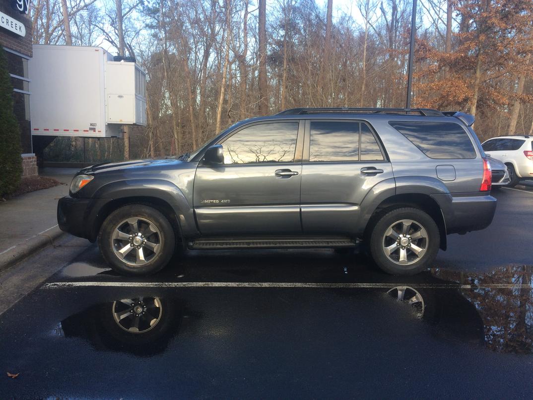

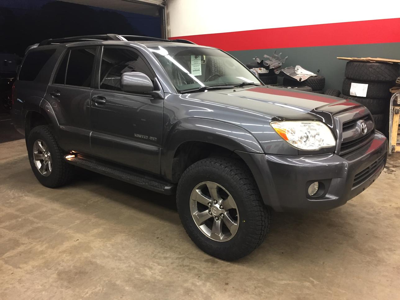

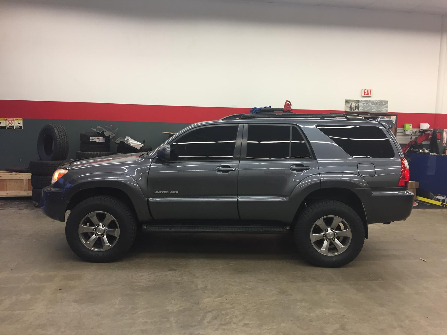

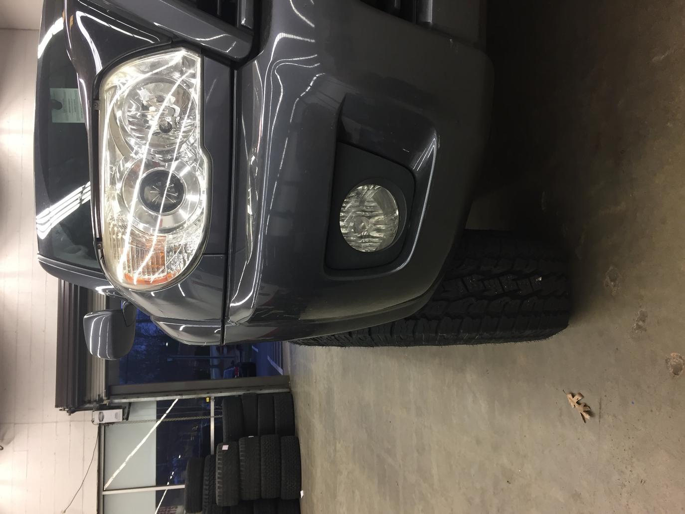

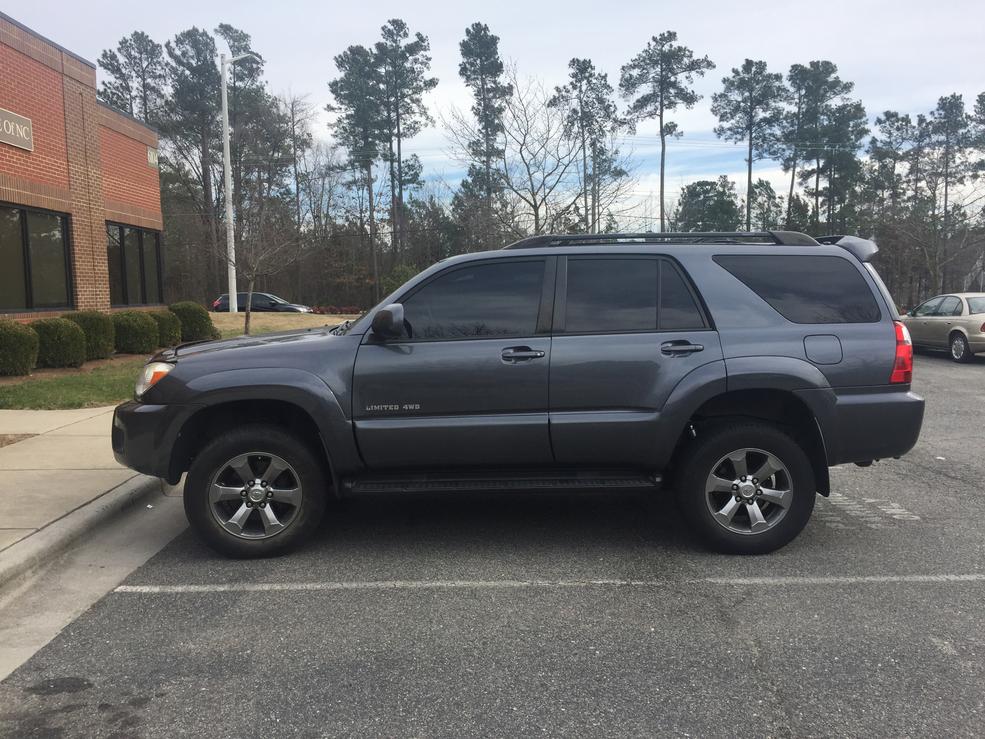

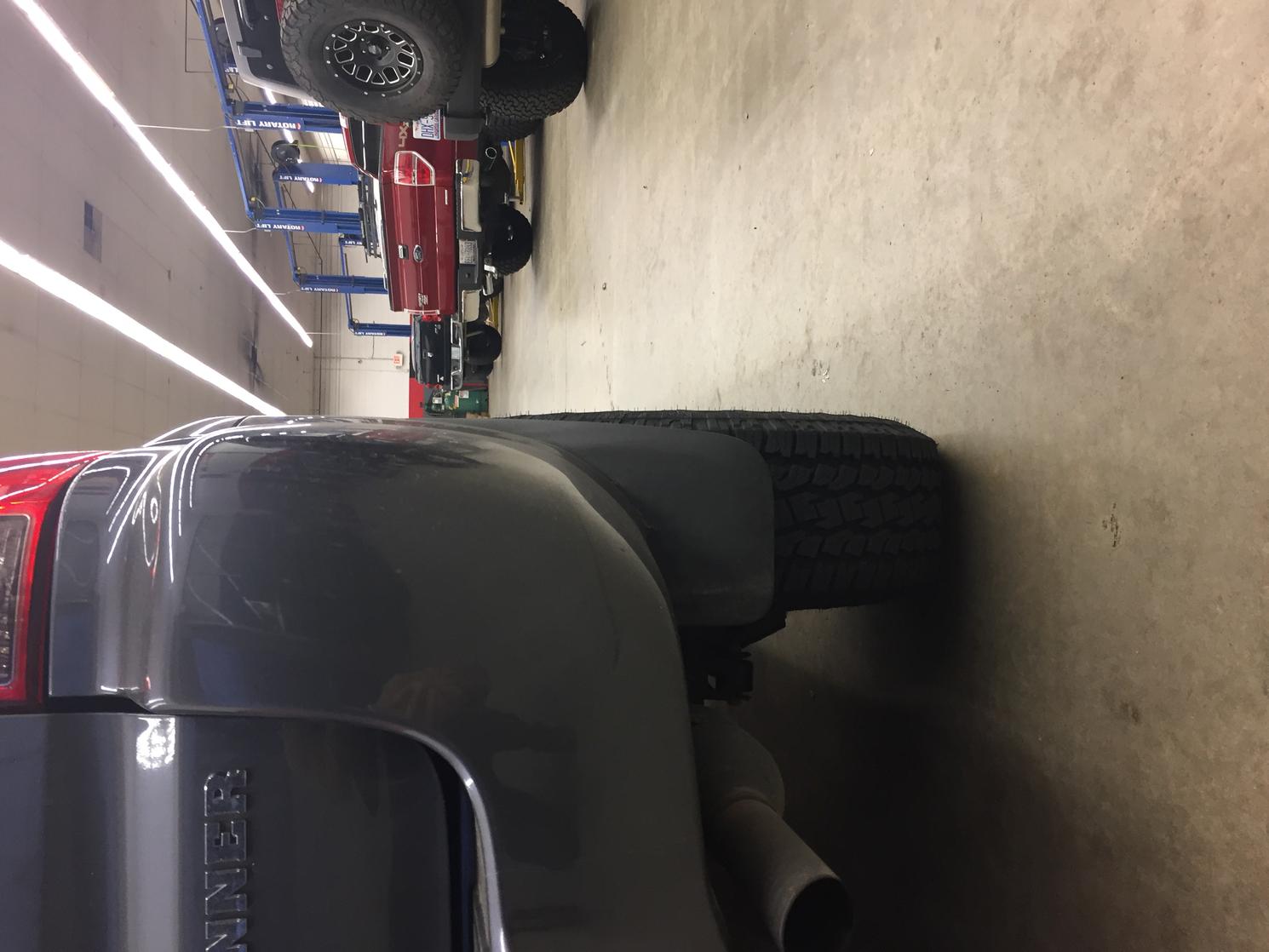

Okay, I've got most of the mods installed.
Front springs are stock
Rear springs are ARB 2895, which I think is branded an OME
And the bilstien 5100, max length
Tires: Toyo AT 2, 265/70/18
Spider Trax wheel spacers
Before, after lift, then tires
Outstanding, the photos are extra helpful as well! The spacers look fantastic (well, the results of the spacers). I just did a spacer setup on my GT, amazing how much it changed how the car sits (when combined with lowering, etc.)

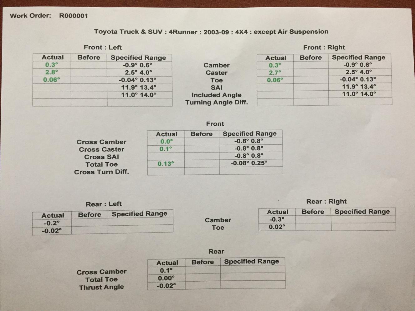

Thanks for the advice on the caster, had to do some searching on that. I noticed it immediately after the lift but I thought it was because I had a completely new tire on the front, as a spare.
The shop aligned the truck already. I'll have to give them a call. It shows its set at 2.7 and 2.8. You're saying that I need at least 3.5 in order for it to track properly? If I cant get that then I'll need to look into the others you suggested.
I came across some posts that say I can adjust the LCA's in order to get caster optimal. Would that be something the shop may already know about during the next alignment?

This will vary from vehicle to vehicle. The caster on my 04 was 2.5 with a spacer lift and I'm at 2.0 with my OME/Toytec + Camburg BJ UCA's and I think it drives just fine: no issues at 80 mph or when towing my 5000 lb TT. No complaints from my wife either and she normally drives a bone stock Acura MDX. With that said, I don't ever remember driving with caster >3.5 so I have no idea if it would drive better, but at 2.7 and 2.8 you are within Toyota spec it should drive better than you describe.
Moving from XREAS to any "enhanced" shocks/springs will result in a stiffer less sporty feel until you get used to the ride. Good luck in figuring out the squirlliness, but my guess is that it has to do more with the steering/suspension set up than your alignment. IMHO...
The Toyota spec is 2.5 deg to 4.0 deg, so at 2.7 deg you are on the bottom end. All else being equal, more caster results in greater steering stability and less wandering. People vary in their sensitivity and preferences in this regard as well, so you'll get differing opinions on what is the "best" setting. My personal experience with my '06 Sport is that, at 2.7 deg, it was drivable but it was more work to keep it going straight down the road than I preferred. It didn't track as well as my '94 4runner or my 2011 Juke. When I put on the SPC UCA's and bumped the caster up to 4 deg the change was remarkable. The vehicle now drives like it is on rails. Some may find the steering too heavy, but I like it this way.
Another rule of thumb is that, for every inch of front-only lift, you lose about .35 deg of caster. For every inch of both front and back lift you lose about .8 deg of caster. So, with a 2.5/1.5 lift, you will lose 1.5*.8+ 1*.35 = 1.55 degrees of caster. Your alignment tech can get some of that back, but with stock UCA's you typically run out of adjustment range at about 2.7-3 deg with that kind of a lift, so I suspect you're as far as you're going to get with your current setup.
Edit: One other thing. I notice your camber is +.3. The spec center is -.15, so you're toward the positive side of the spec there as well. That's not as critical, but it indicates to me that the alignment tech sacrificed camber in order to get your caster as high as he could. That's a pretty good indication that it will likely take aftermarket UCA's to get more caster.
That's what the tech said this morning. Basically, he could get more caster, but it would throw the camber off. So, yeah..
For what its worth I plan on upgraded UCA's to push it to 3.5, im sitting at 2.5 degrees right now and have been told it will ride closer to original this way.
