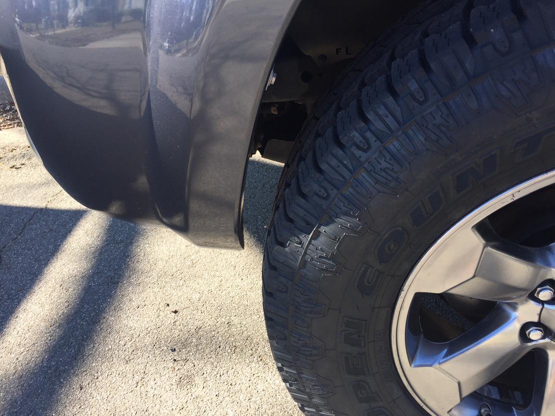

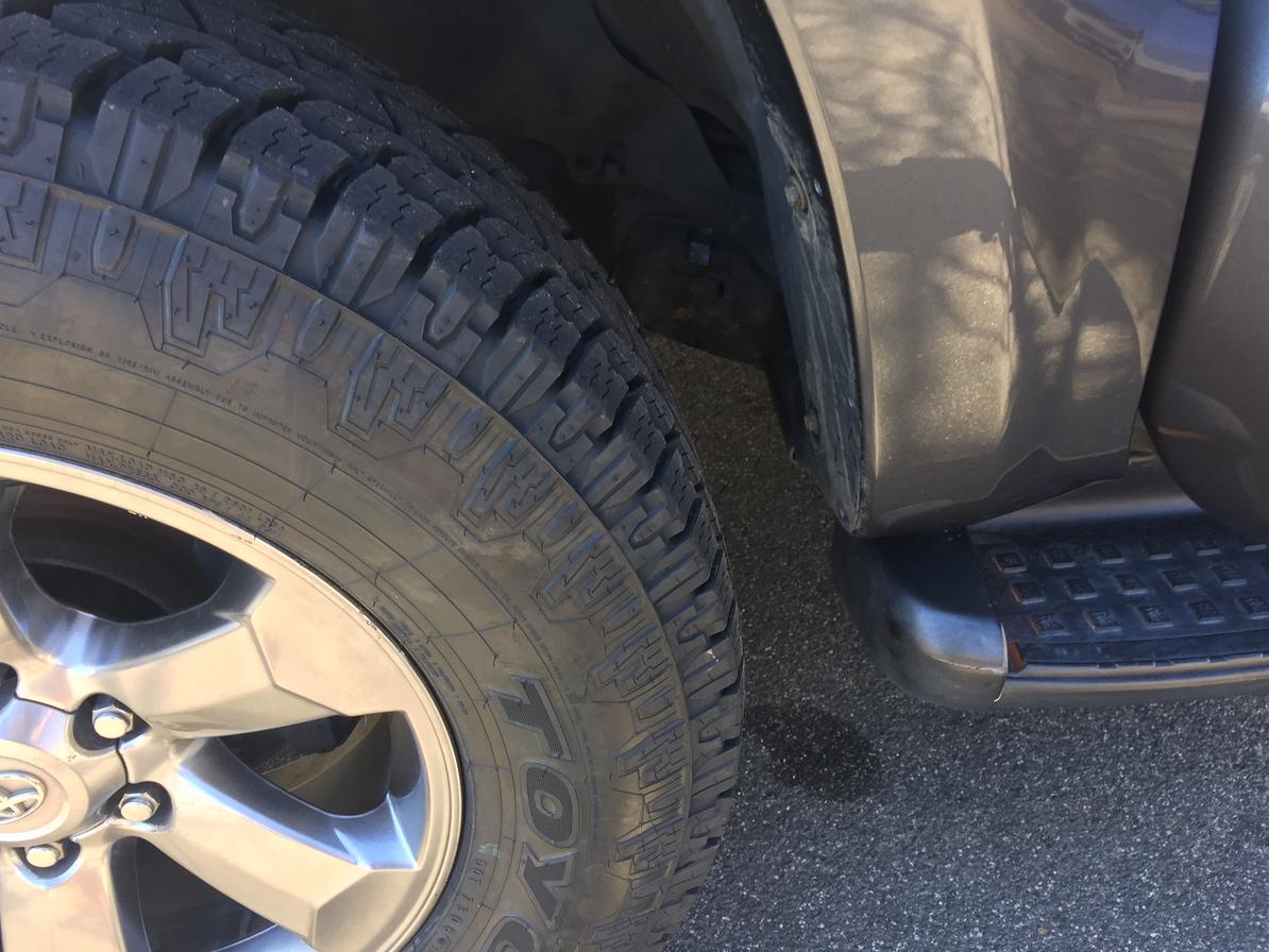

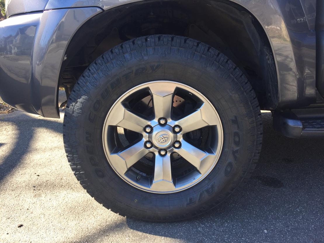

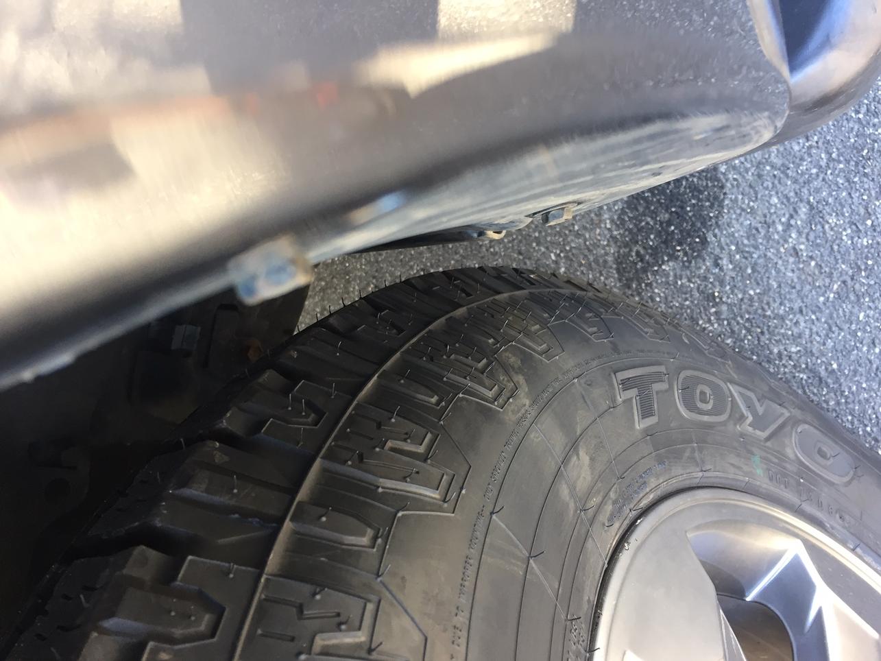

I'll be installing aftermarket UCA's to get more caster for the truck. One of the unknowns is tire clearance.
I've been warned that after I install the UCA's and get more caster that they may not fit and scrub.
My question is: Does anyone know about how far I fan expect the tire to move backwards?
These are the two options I'm considering:
JBA UCA, non adjustable, has +1.2 degree of caster built into them.
SPC UCA, adjustable, has +1 degree of caster built into them.
Current caster adjustment is set at +2.7 and +2.8
I believe I need approximately 1 more positive degree. I have no idea how much that would move the wheel, in terms of inches backwards. Its currently about .5 inches of clearance with the wheel turned out in the most restrictive position.
I know this is a difficult question with a lot of variables, just trying to minimize mistakes. Thanks

Based on a roughly 18 inch distance between the lower ball joint and the upper ball joint, 1 deg extra of caster will move the UBJ back about .3". The wheel itself will move back about 1/2 of that, so about .15 inches for that 1 deg extra caster.
Keep in mind, though, your tech may want to put the camber back closer to where it should be, which could also move your wheel back a bit, maybe another .15 to .2". You're going to be close to using up all of your .5" of extra space, but it could work.

Seems like the JBA's will probably work. Thanks for the math
