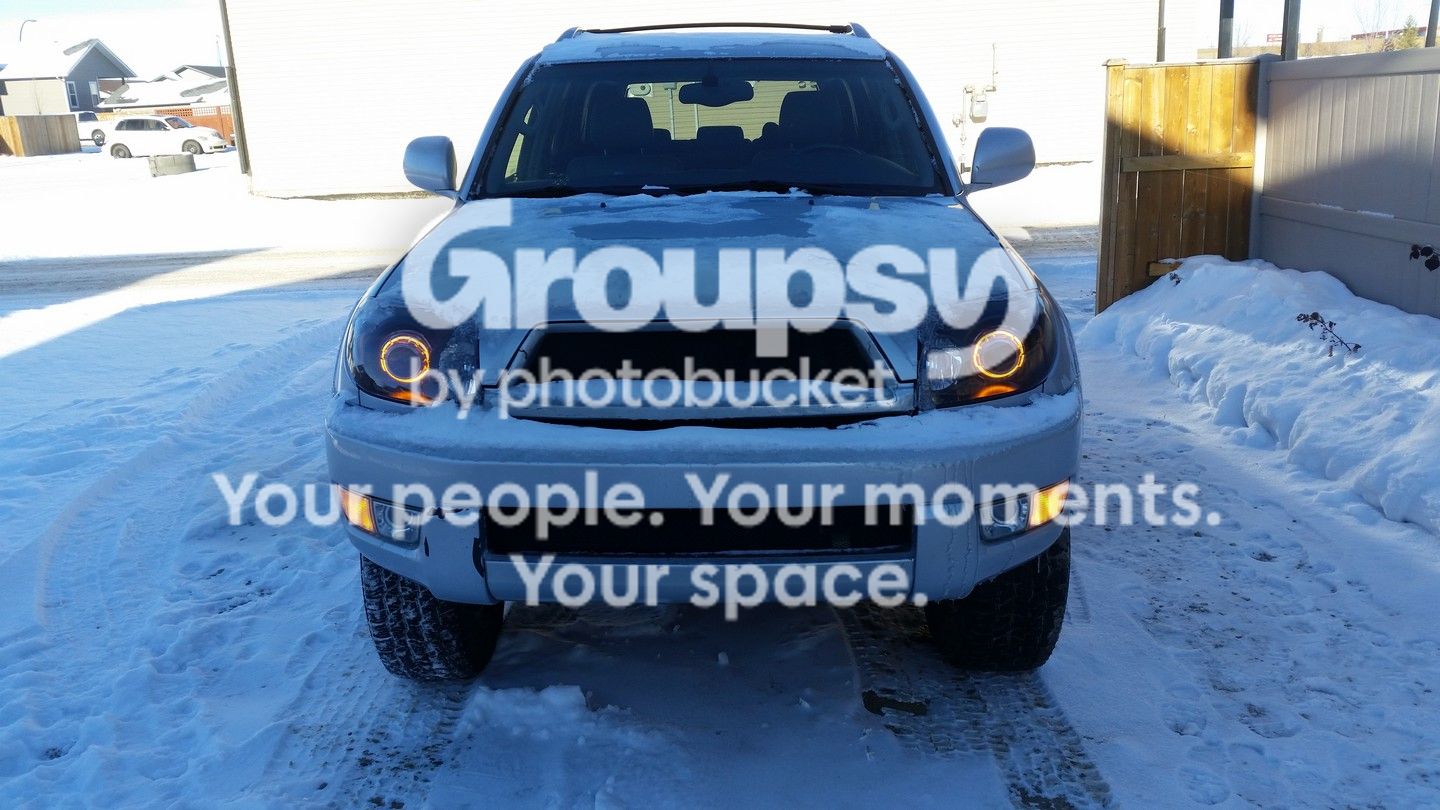

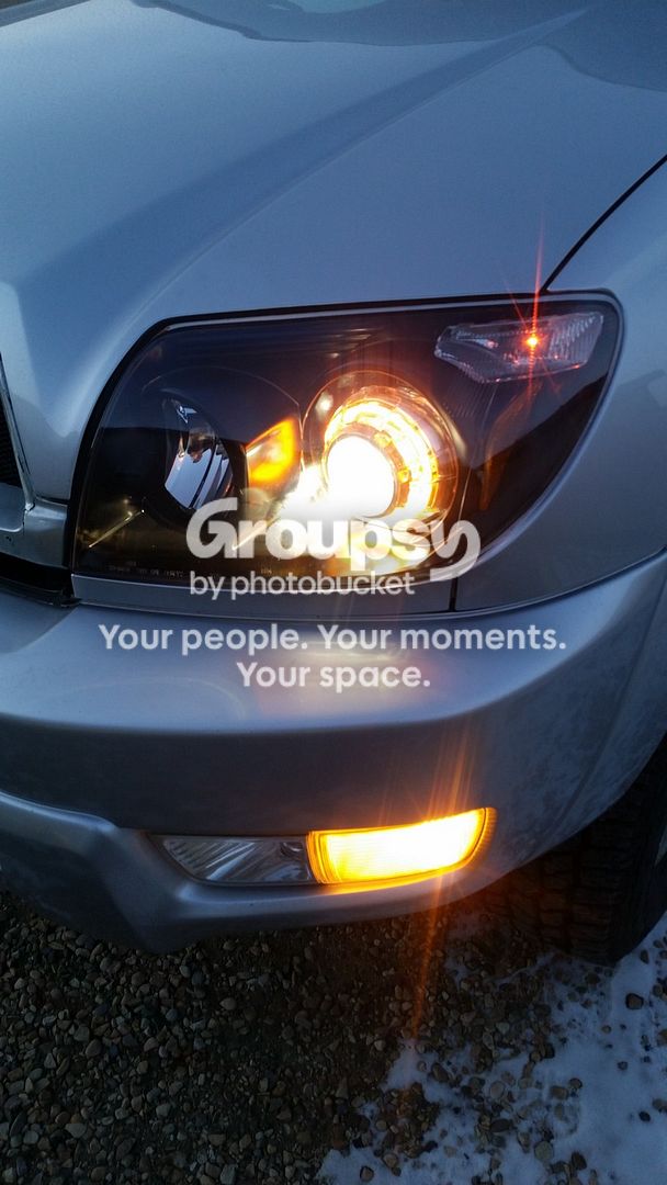

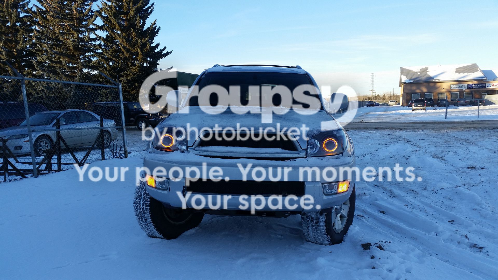

Finished wiring my XSB (gen 2) halos from TRS. Decided to wire them to my DRLs which are also happen to be turn signal. I wired them amber since there are too many white halos around, and I also figured it would match my DRL better compare to white. Just tapped into turn signal wires without relays. They also blink in sync with original turn signals in bumper. Matches them pretty good in color but not as bright in sun.

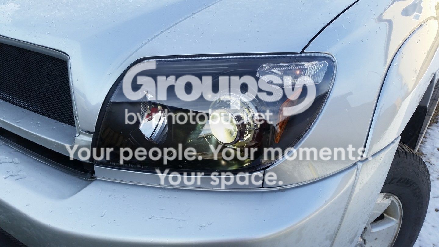

Simply installed halos under clear shroud. Looks like a diamond or crystal, love these projectors!

Any difficulty fitting the LS460 in?
Why'd you pic them, hear they are difficult to find.
Bi-xenons are hard to find, these are low beam only. There are tons of them on ebay. I choose them because LS460 considered to be one of the best HID projectors and they have very unique look. They large but after some trimming they fit great in large 4runner reflectors. I used epoxy to secure them to reflector instead of bolts. And they not that expensive. I paid $30 for one projector years ago, and bought matching headlight for the other side on ebay for $120.
