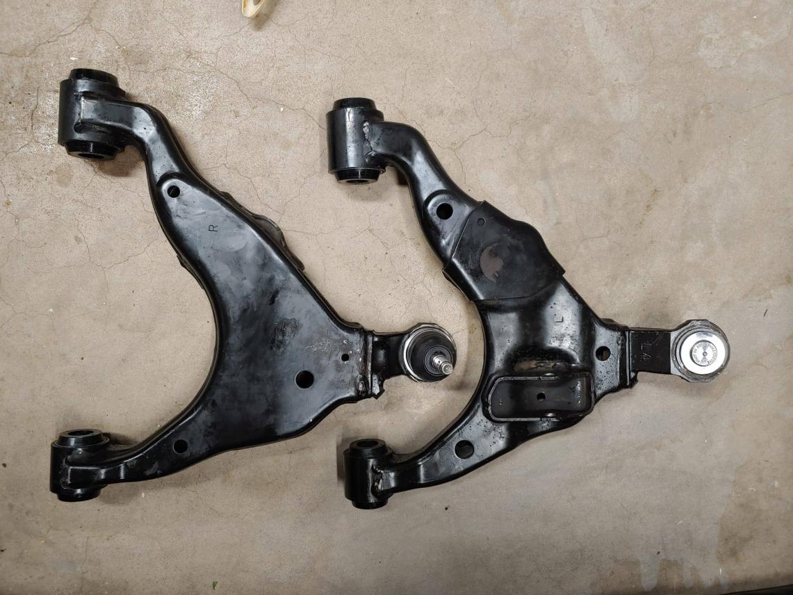

Lower control arm rebuild
Thanks for the detailed write-up on the lower control arm rebuild. Being on the west coast, the ones I worked on barely had any rust (the image shows them without any painting, just some basic cleaning). Pressing out the old bushings turned out to be the easiest part of the whole job. Using the bottle jack and a bit of heat they popped right out. Getting the ball joint out was the worst part. The ball joint press did not do anything! After soaking it with PB blaster I ended up hammering it out with a big mallet. There was no rust at all around the ball joint, so not sure why it was so hard to get out. Pressing the new one in was quick and easy. I struggled a bit with pressing the bushings in and ended up doing all four with the bottle jack method. Worked much better than using the ball joint press. This job would definitely be much easier with a shop press. Glad I don't have to do this again for another 200k miles!
Hey thats awesome! Glad you didn't have any trouble with rust, that certainly made this job more interesting lol.
Weird that the ball joint press didn't work on your clean arms When I did the one side with a breaker bar, I did notice the hammer shocks definitely helps it jump through, so maybe that is the ticket. Looks good dude!
