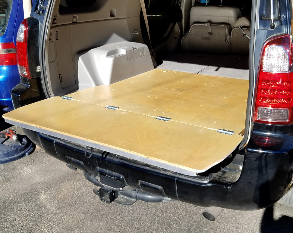

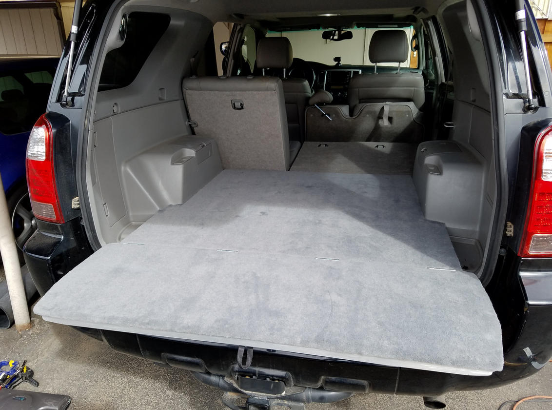

a design that would function as well as the old 1995 runner. Goals were.

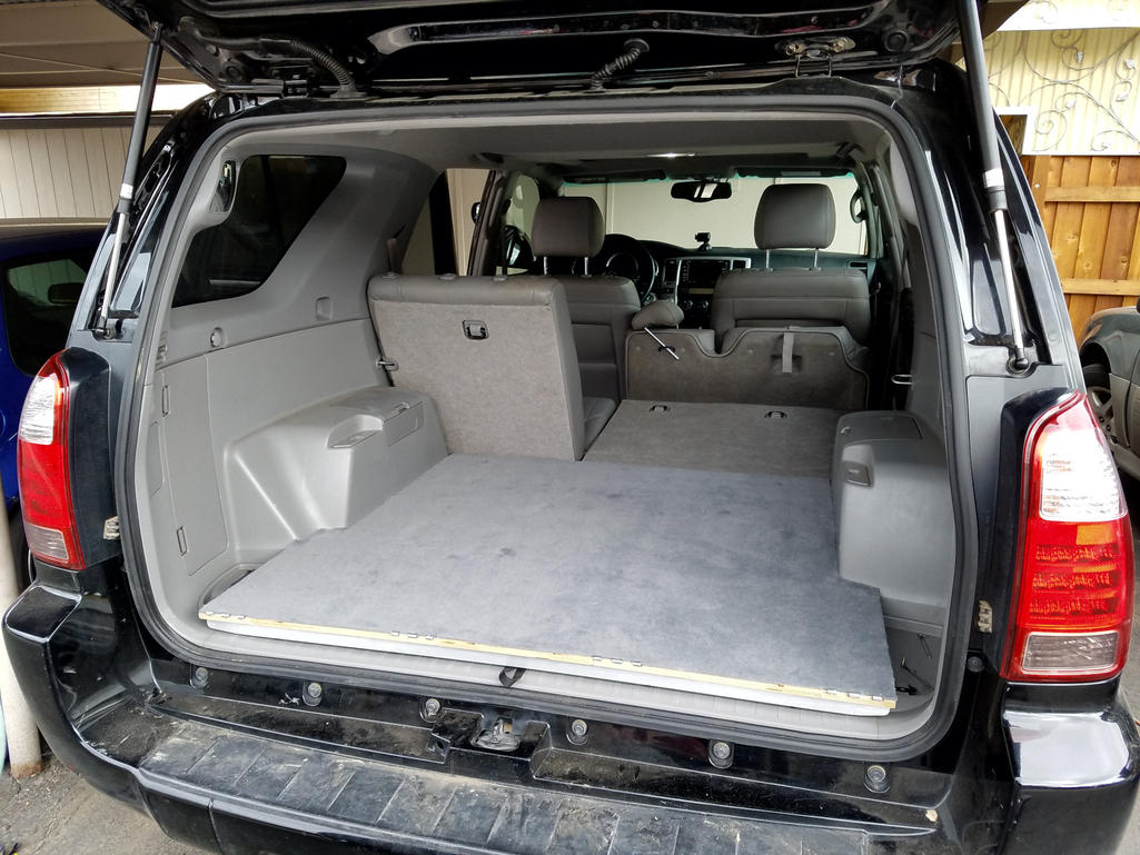

1. Should be solid enough for at least two people to sit on.
2. Should not use any more vertical space than the stock rear shelf, so that the floor stays flat when seats are folded. I car camp in the back fairly frequently.
3. Should not slide out like the Gen5 4runner tailgate/shelf thing which leaves a huge gap behind the rear seats.
4. Should be quiet (not rattle on bumpy roads)
5. Should not eat up significant interior length.
I sent him measurements, he built it up, brought it down from Montana and we then did some final trimming and fitting and
so forth, but the end result fulfills all the goals above plus some.
Once fitted, it's easy to install/remove (just two bolts).
Just the folding tailgate portion can be removed if need-be.
It'll actually support 3 people.

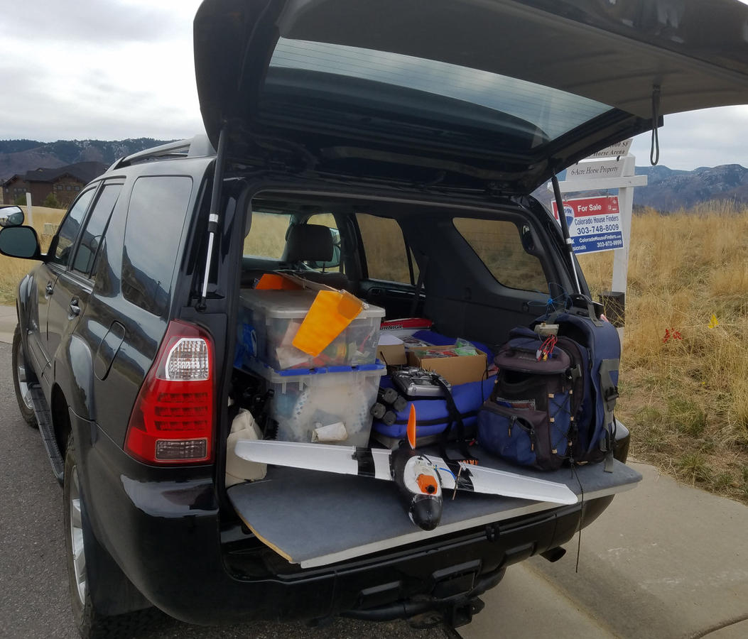

Pics below starting with my old 4runner taildate supporting a 40lb sailplane, which is the least of the loads it handled over the years.

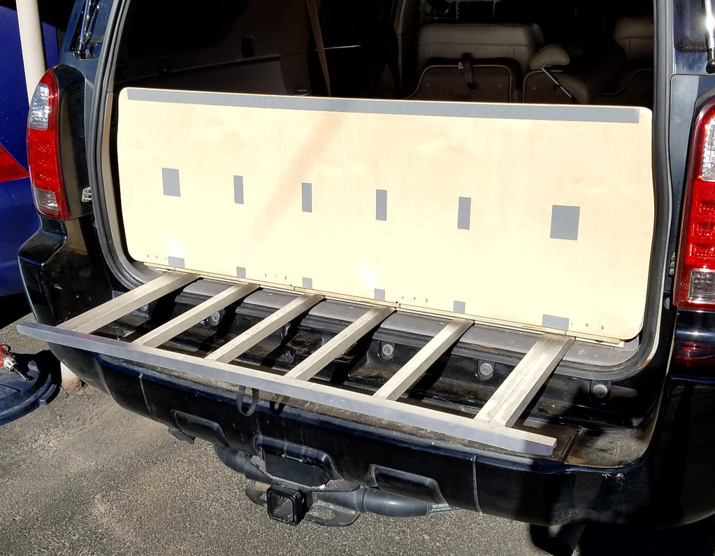

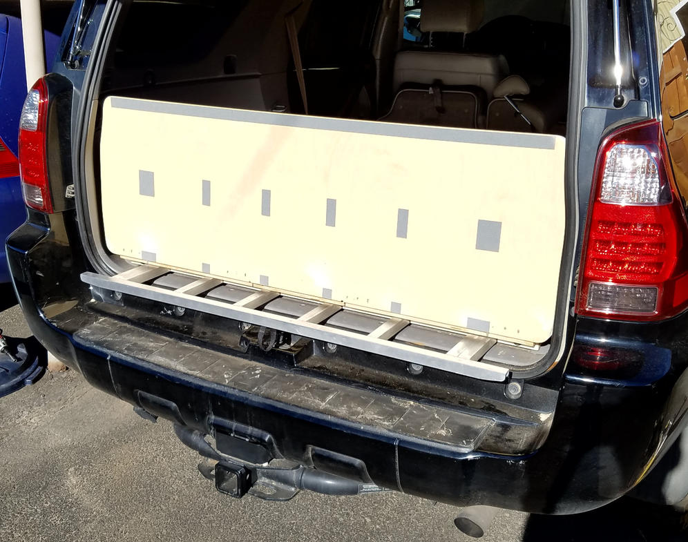

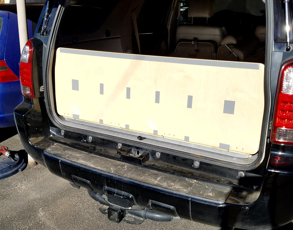

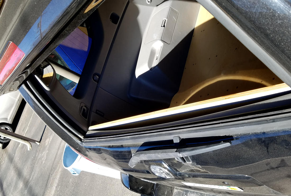

Obviously we start by removing the stock rear shelf/floor. I measured its thickness at a little over 1 1/2" so that's
what we had to work with to keep the floor flat.
We couldn't have a sliding tray because it leaves a gap as it does on the Gen4, so the trick was to design a regular
hinged folding gate that was supported from underneath.

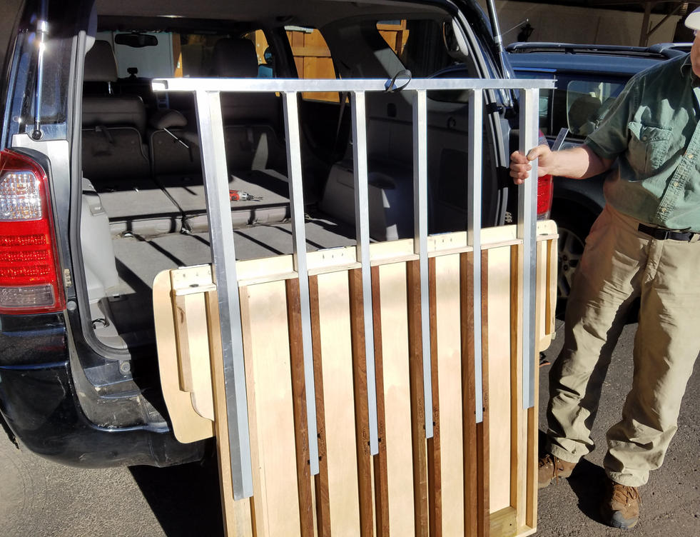

What we settled on was to have the 1/2" plywood floor held a tick over an inch above the rear cargo floor by 1 1/8"
deep wood channels, and then to use a frame made of 8 long 1" square aluminum tubing that slides within the support
channels. The frame slides out and then the tailgate folds down and rests on the frame.
The four center channels are made from ironwood and their sides are slotted.
The four center tubes of the aluminum frame have crosswise steel pins that ride in those slots They serve a dual purpose
of keeping the frame from sliding out past the end of the tailgate and they keep the frame from trying to pry the floor up
in the middle when you put weight on the tailgate.
With a full load (2-3 people) the whole unit flexes downward just enough (less than 1/4") such that the frame rests on the
rear lip of the hatch floor which is rear of the hinge line which helps keep it from carrying 100% of the load on those pins.
