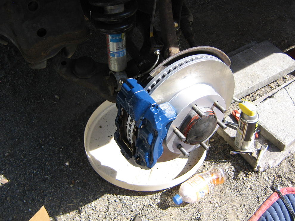

I did the TBU yesterday which was pretty easy. I've read so much about it here that I felt like I've done it before. I've only done front pads & rotors once before in '96 on my '78 Coupe Deville.

But the day ended good. I didn't have to call an ambulance & my brakes work insanely good. I took it for it test drive & when I hit the brakes I didn't expect it to stop so suddenly & all of my tools that I had in the back came flying forward LOL. I was like holy shlt! Definitely a different feel but I love them. And because pics are mandatory...
I used POR15 Blue Caliper paint, Rustoleom Aluminum for the rotor & Valvoline Dot 3-4 Synthetic fluid. I drained all of the old fluid out.

Like the color. :) I have not had another warped rotor since doing the TBU in Jan 2010....

Thanks, everybody uses Red so I wanted to be different but not flashy. I didn't think Black or Silver would be noticeable enough. I also did my new Alt with the same paint & will be doing my new starter & the TRD logo on my S/C.

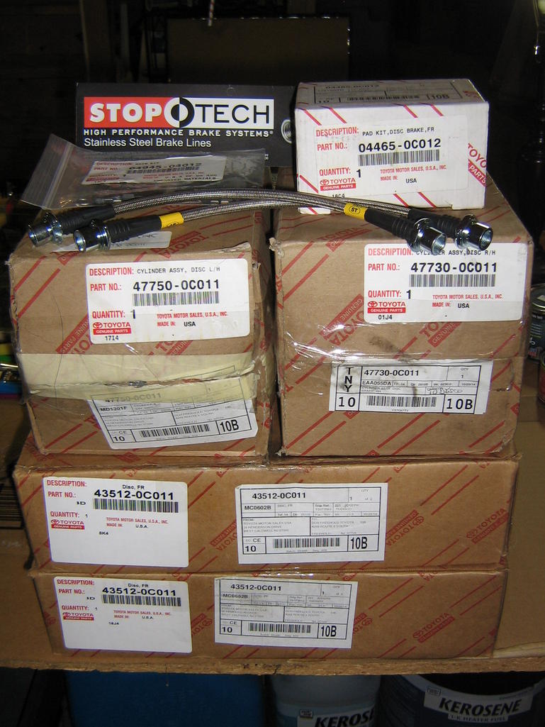

Thank You, I found them in the classifieds one night by luck. A member here bought a truck with those parts in the back. The PO never installed them & the new owner had no intentions of installing them so he put them up for sale. I paid $550 for over $1200 worth of parts. :whoo: I intended to do the TBU someday but I couldn't pass up this deal & the guy was close enough for me to drive to.

I wouldn't buy rusted calipers from a junk yard. If I didn't get a good deal on the OEM's I would have bought remans from Napa, EBC Black slotted & drilled rotors & shims & pads from Toyota. The Stop Tech SS brake lines I got from E-Bay. They were cheaper than Wheelers.

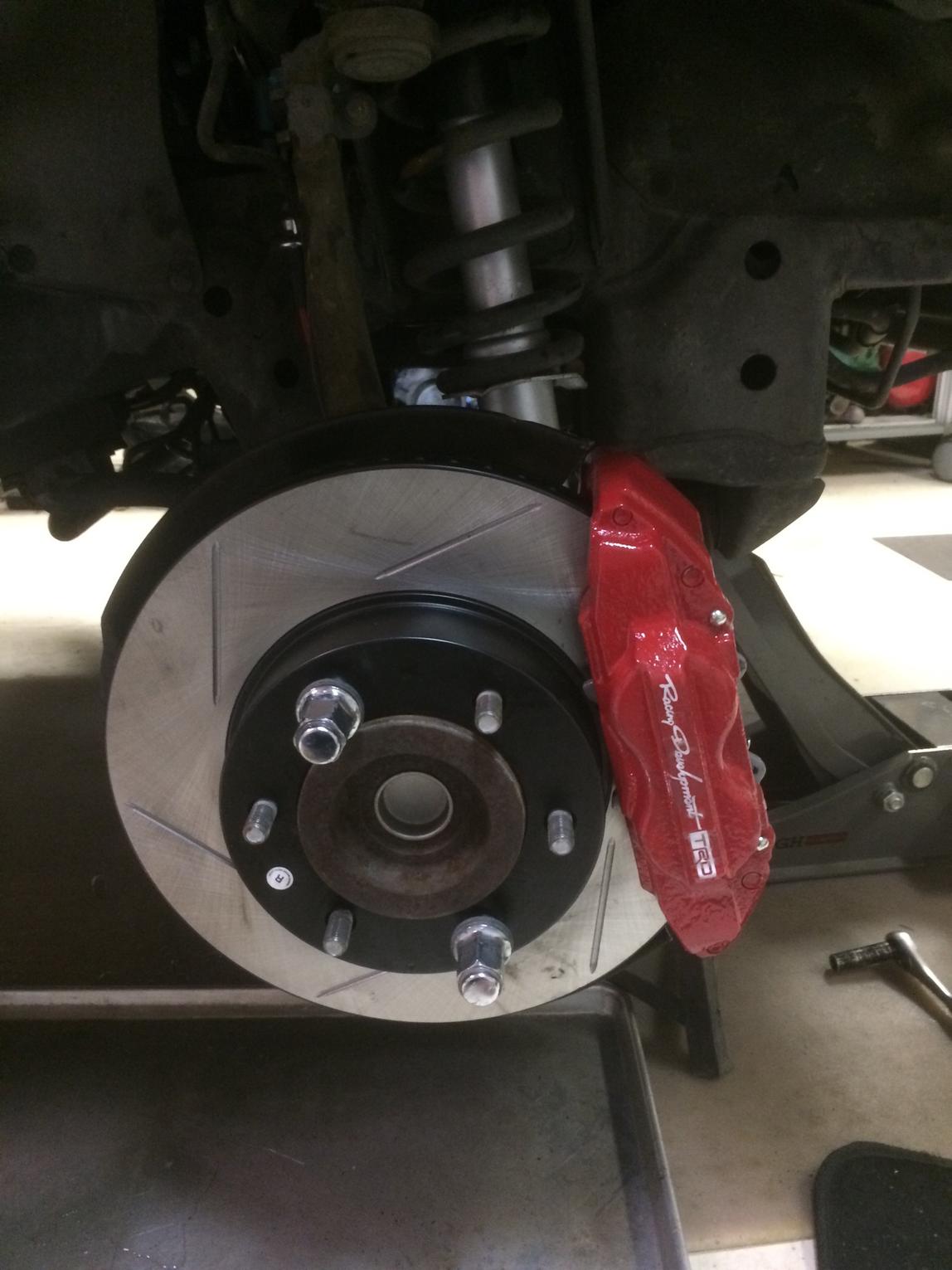

Did the upgrade yesterday. Took most of the day in an air conditioned garage, thankfully. Found junkyard calipers & rebuilt & painted myself. Bought StopTech slotted rotors, Wagner pads, & Wheelers Off Road ss braided red brake lines.
Install went pretty smooth except we had to grind down the calipers a bit to get the stock 1998 wheels to fit over the larger rotors. Brakes work great !
1998 Limited RWD. This pic is before we started grinding !
