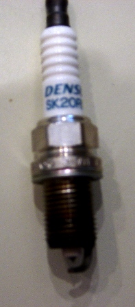

Replaced Densos with NGK IX Iridiums
Had 8 Denso Iridiums in my 2005 4.7 and not a mix. Replaced w/ NGK IX Iridiums. Although I only have 17K on the vehicle I decided to replace with the NGKs. I have attached a pic of one of the Densos that came out.
