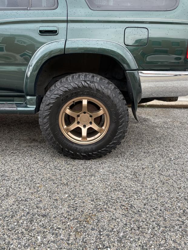

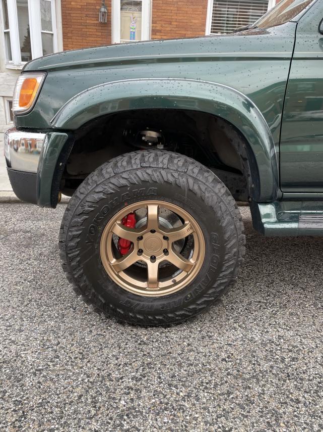

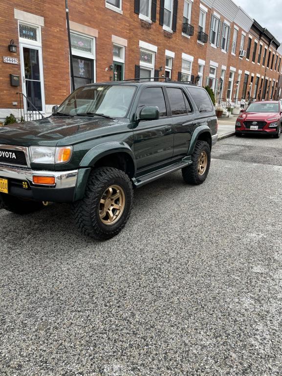

I'm running 295/70-17's which is a inch larger.
BUT I also have worked in the tire industry the last 14 years. So I can help. 295/70-16 is a very rare size it's actually smaller in diameter than the 285/75-16 but wider. It's really only .5" taller over the 265 which you only gain 1/4" ground clearance. Not worth the heavier set up.
Id be shocked if it fit underneath especially with the hitch. I run a swing down hitch mounted spare carrier on mine.
I personally would run the 265/75-16 because you have a lot more options being a more common size and prices are lower, also you won't need spacers furthering your savings. If you want a wider stance save for wheels
If you want bigger tires I'd run 285-75-16 more options /lower prices actual ground clearance gains. But you need to relocate your spare.
Lastly don't buy ko2s way overpriced for poor performance.
[MENTION=595680]Wrenchin4torts[/MENTION] wow what a beautiful rig! And thanks for the input.. very helpful.
Here to is a Geo MT 295/70 R17. Wheels are 17x8.5 with a 0 offset.
3" Toytec ultimate coils with SPC UCA's set to E / -1.0 Caster up front
