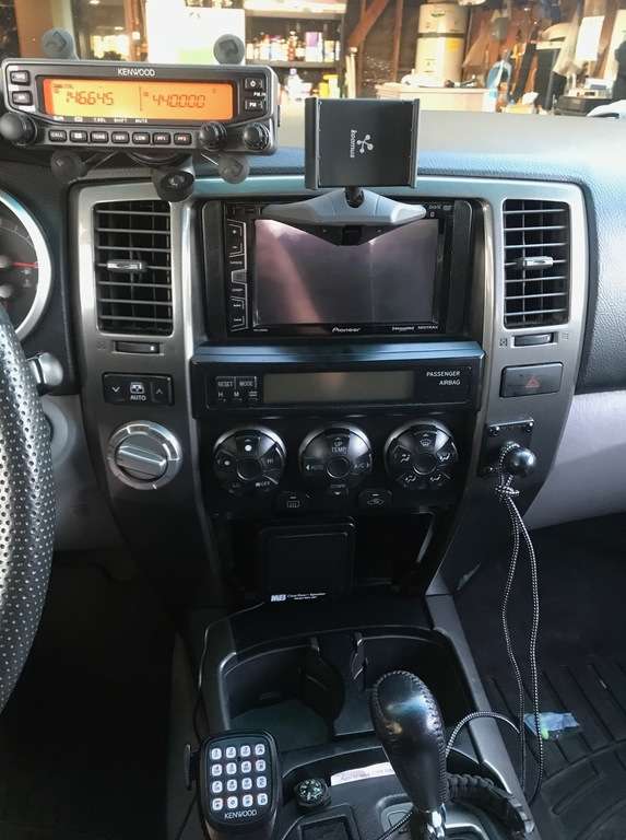

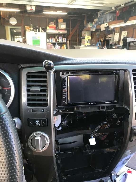

When it came to the install, the first question was where to mount the main body of the radio. A lot of folks mount them under their seats which I considered, but I was worried it might get wet if anything spilled. (A valid fear as it turns out due to a leak from my roof rack, but more on that on another day...) I saw that [MENTION=129593]MTN4RNR[/MENTION] had mounted his ham in his center console and chatted with him about it. He had not had any issues with it there (other than loss of the storage space) so that choice was made.

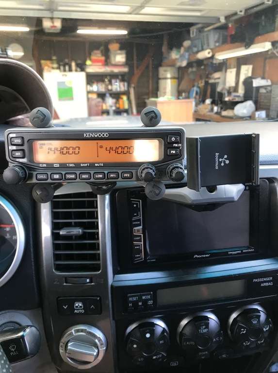

The next big puzzle to solve was where and how to mount the head unit. I knew I wanted it as high up as I could get it so it would be in my line of sight for easy monitoring. I also wanted to be able to remove it so the radio would essentially be hidden from prying eyes. So let's get started...

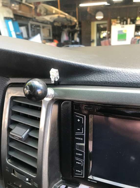

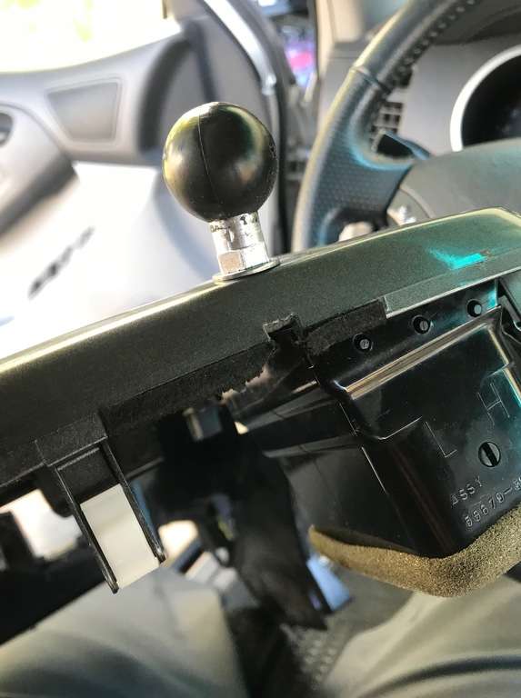

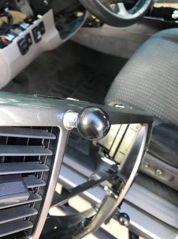

First was the head unit. I decided to mount a RAM ball and mount the head unit with a a RAM X-grip much like my tablet. I pulled the center console trim to see where I could mount a RAM ball.
After removing the trim, I realized there was a perfect spot in between the radio and vent where I could put a bolt through and then mount a threaded RAM ball. Luckily, my friend had one handy so that was sorted.
So that I wouldn't pinch the extension cable to the head unit, I cut a small notch in the trim which is not visible when the trim is re-installed.
So the ball was installed along with the extension cable run down the inside of the trim and into the center console.

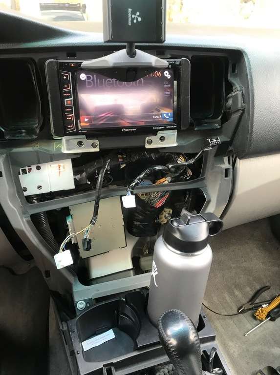

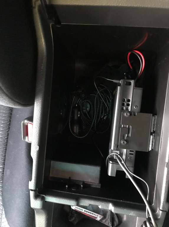

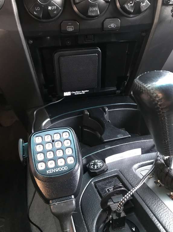

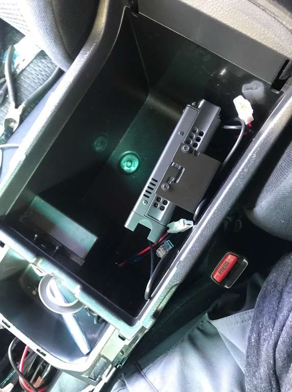

Next up was the main unit in the center console. The only permanent "damage" I had to do for this install was to drill two small holes in the front of the storage compartment to run the power, head unit, external speaker, and antenna wires through. The I used Scotch Extreme Velcro to secure the main unit to the side of the compartment. This works well for a couple of reasons. First, I didn't have to drill any additional holes in the center console. And two, it's relatively easy to remove the unit to attach the programming cable. I then ran the power cables back up the center console, under the dash, through the firewall grommet on the driver's side and connected the power directly to the battery. So this is how that worked out . . .

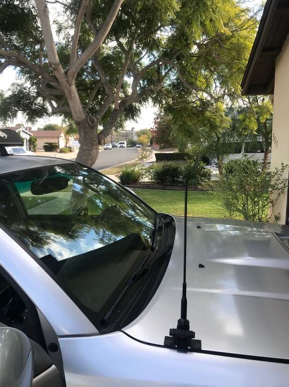

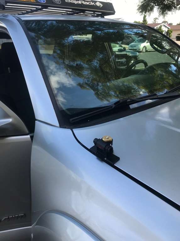

Next up was the antenna. I bought a Diamond NMO mount so I could easily switch between antennas. I originally planned to mount it on the rear hatch, but decided I didn't want the hassle of running the cable all the way from the rear of the vehicle to the front. My dad suggested mounting it on the hood, something about a good ground plane for the antenna. So that's what I did.
The short antenna:

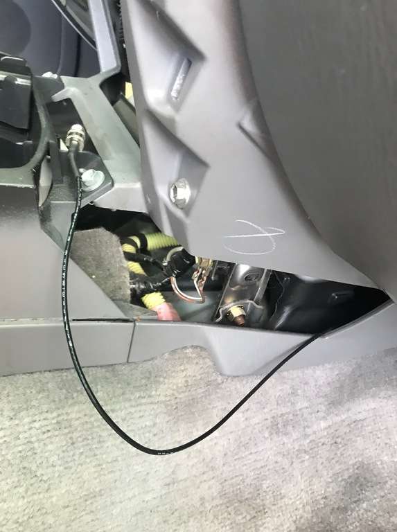

I then ran the cable through the firewall grommet on the passenger side, down under the HVAC vents, etc., and into the center console. I did need an extension cable so off to HRO I went. Only to find out I bought the wrong one. Which required another trip to HRO, where I managed to leave the adapter, which required a third trip to HRO. :ybrick:
The final steps were to figure out where to mount the external speaker and the mic. After considering a few spots, I realized I could just remove the useless storage bin in front of the cupholders and use more Extreme Velcro to mount the speaker in that space which has worked out great. And then, borrowing again from MTN4RNR's build, I used a Nite Ize Steelie to mount the mic.
(I have since moved the mic because I kept knocking it with my leg while driving. Now it's up right under the 4Wheel selector switch.)
And the finished project:

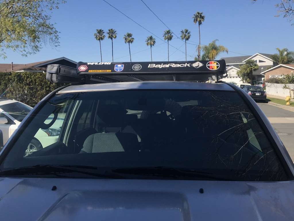

Baja Rack and leak repair

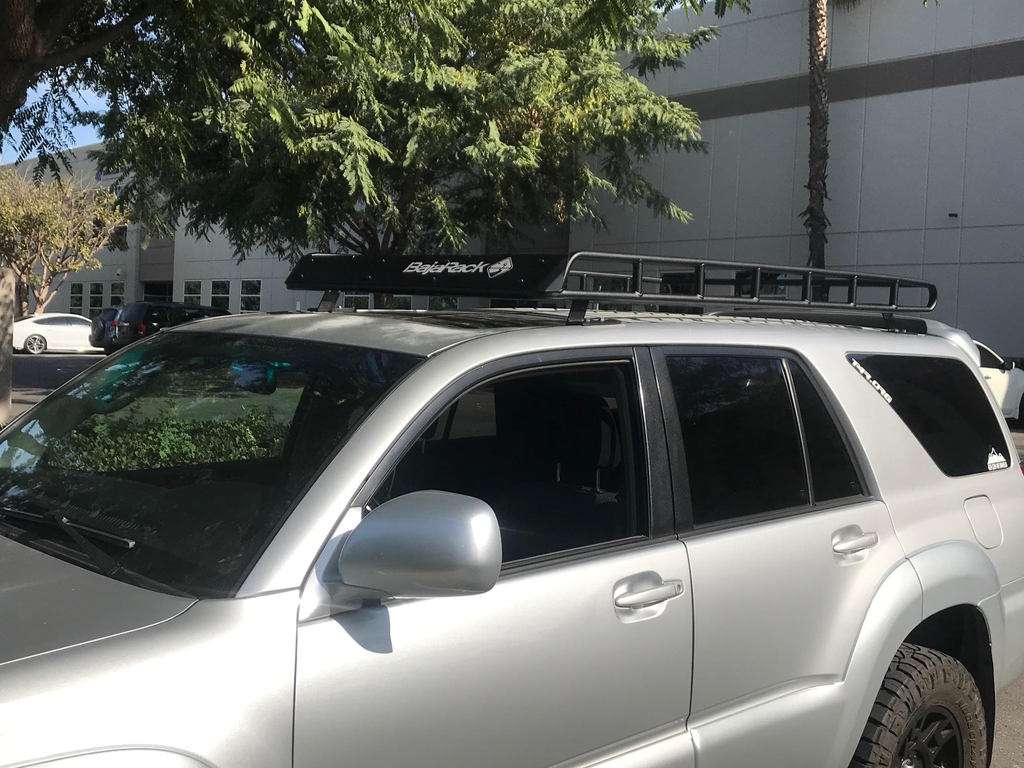

So, back in November I took advantage of the Baja Rack group buy and got one of their full length baskets. Between the group buy, military discount, cash discount, and picking it up in person (no shipping), I scored an amazing deal! :biggrin2:
I drove down on a Thursday morning and installed it in Baja Rack's parking lot.
That said, the install did not go without complications. Whoever the engineer at Toyota is who designed the roof rack mounting points is a guy I'd love to meet just so I could give him a swift kick in the balls. When I removed the stock rack, two of the mounts fell down into the roof liner (you'll see why later). Luckily, I carry a small magnet on an extendable handle in my tool drawer so I was able to retrieve the brackets and mount my rack. However, you are supposed to run RTV around the mounts to prevent leakage and I was not able to do that well (honestly it looked like a drunken third-grader applied the stuff) because I had to hold the mounts in place with needle nose pliers while threading the bolts through the Baja Rack mounting points.

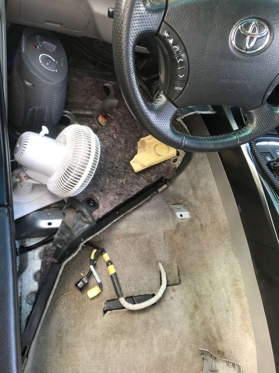

Fast forward a couple of months and SoCal gets hit with more rain than we've had in years. YEARS. Predictably, one morning I got into my 4Runner and was greeted by a wonderful musty smell and a mushy driver's foot-well.
Water was getting in via the driver's side front mount and then running down the A and B pillars and onto the floor. (Good thing my ham radio is not mounted under my seat.) Ughh.
The basic repair plan was to pull up the carpet and dry it out and then pull the headliner down and replace the damn mounting brackets in the roof. I was able to get new brackets and clips from Toyota by the weekend and got a couple of sunny days in a row to make the repairs.
First order of business was to dry everything out. I basically removed the front seats, stripped out everything out from the window line down, peeled back the carpet, and put a fan and a heater on everything. I left it like this for two days while driving the daughter's 4Runner and everything was nice and dry.

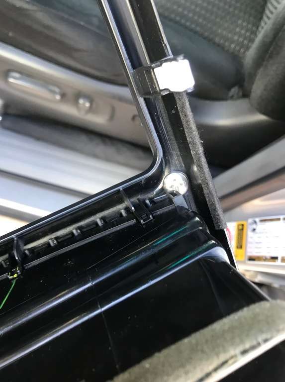

Once everything was dry, it was time to pull the headliner and replace the mounting brackets.

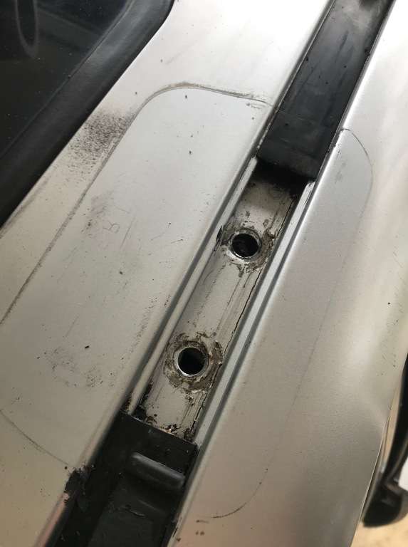

Basically, there are two holes in the roof at each mounting point for the roof rack:

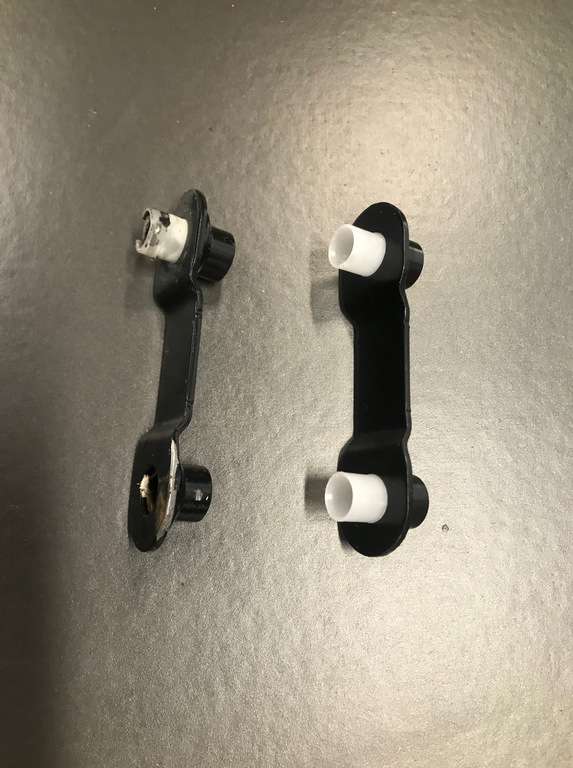

One of these threaded brackets then goes into the holes from below (old on left, new on right):

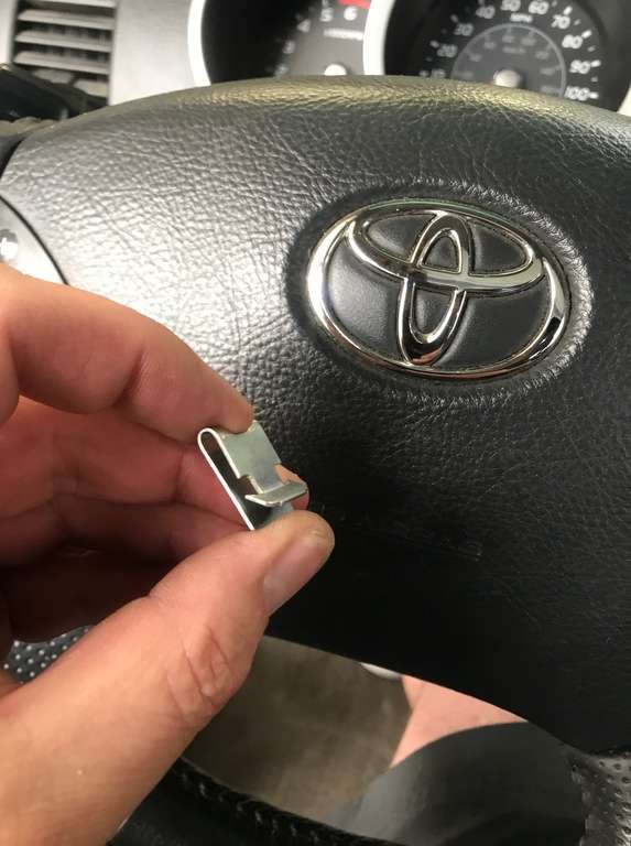

The bracket is supposed to be held in place with one of these clips:

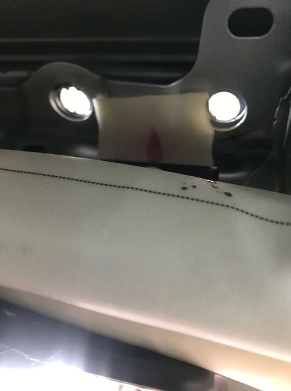

Once I pulled the headliner down, I learned that two clips were completely missing (driver's front and passenger rear), the passenger front clip was almost off its bracket, and only the driver's rear clip was in place the way it was supposed to be. :ybrick:
When I installed the new brackets, I put a drop of silicone on the clips to make sure they stay in place!

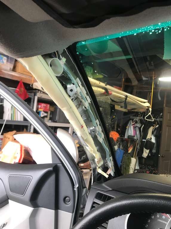

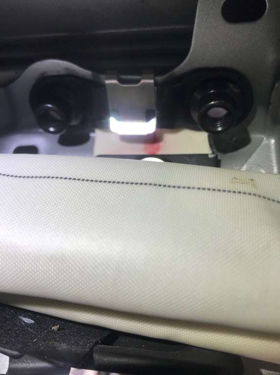

View from below showing the holes and the side curtain air bag.
And the new bracket and clip securely in place:

Damn those projects that take forever and are lots of work to replace like for like part and when it's all back together no one else will even notice the difference!
In addition to a fan under the carpet I've also started to carry a desiccant bag designed to hang in a closet with clothing. This thing sucks the moisture out of the air and holds it in a pouch below the desiccant, it helped dry my 4runner out after wet carpet on a trip and still using it now to help with moisture control on rainy trips and humidity from sleeping inside the 4runner until it's warm enough to keep windows open for airflow. They are available at any walmart in the closet organization section.
That's a great idea, thank you! I currently have a few desicant bags from various things I've bought which are sitting in a plastic tub under the driver's seat.
I'm going to check out those bags at WalMart. Need to go anyways to pick up some target practice arrows.
I tried using a bucket of RV desiccant but it didn't seem to do anything as in it didn't change in weight like I expect it should have if it were absorbing water.
The closet bag as a pro tip can also poke a small hole near the top of the water bladder, drain it and reuse! Yes I'm cheap.

What you see above is what I have, sorry. To remove the head liner you basically remove all grab handles, then remove the A and B pillar trim pieces and then carefully pull the headliner. I did a Google search and found a couple of threads. It's really pretty easy. The hardest part for me was putting the trim back on over the seatbelt height adjusters. It took me a couple of tries to figure it out.
The clips and brackets are VERY simple. You just stick the bracket into the roof and then the clips hold them in place. Just put a dab of silicone on the clips so they don't slip off over time.

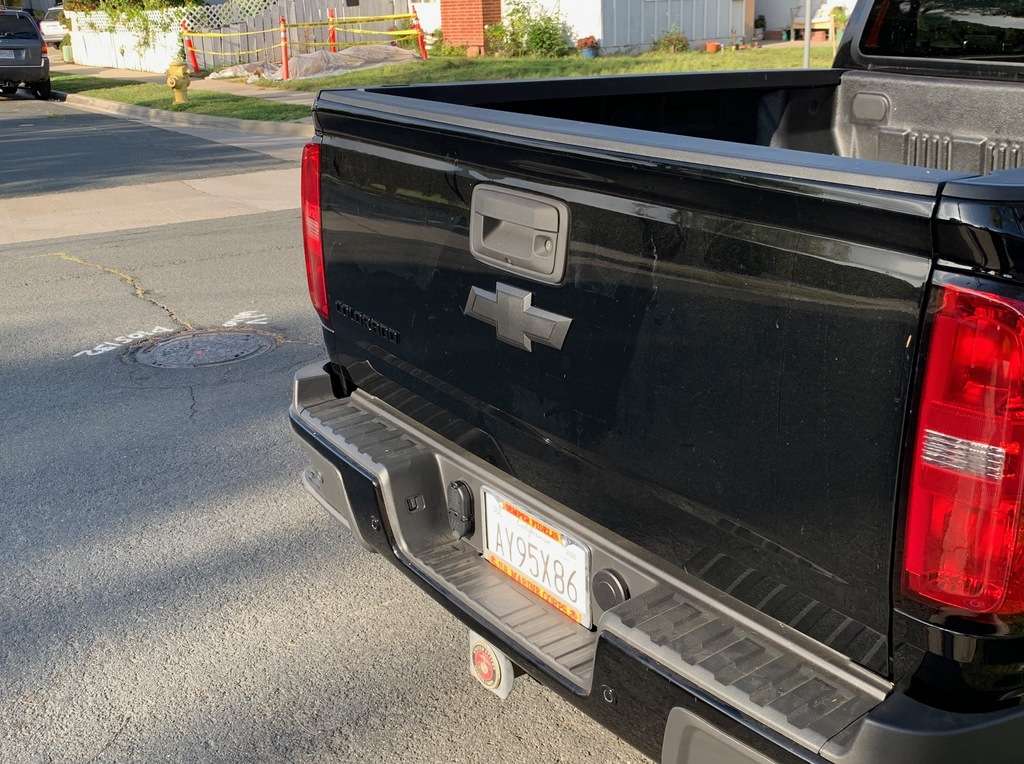

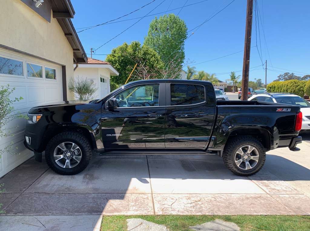

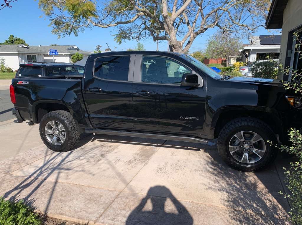

Here it is in all it's stock glory the day I brought it home:
I've already done two of the most important things: removed the front cow catcher air dam and swapped over my BD Squadron Pros:
I've also swapped out all the chrome COLORADO badges for black and plastidipped the Bowtie on the tailgate:
Spray in bedliner and camper shell go on today.
From there, I need to install the ARB compressor and ham radio and I know I want to give it a mild lift in front just to level it out. Oh, and I plan to install the BD S2 Pros I have had sitting around forever because I was too chicken to drill into Hank's roof. Those will go in the rear bumper for some nice rear lumens. I'm also swapping over the drawers from Hank and making a new platform for them. That may be all I do.
