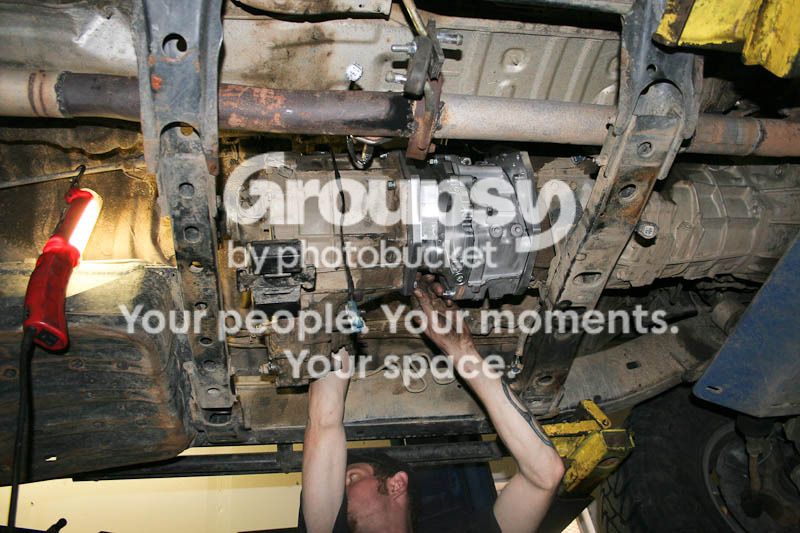

I honestly don't remember how long it is. 19-20" sounds about right though. I basically just cut it right after the O2 sensor. I also cut just after the flange too because i didnt feel like the extra work to get the flange to work was work it so i just made it all one piece.
Here is a picture
