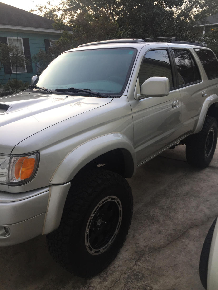

4Runner 5100 and OME 2881 ride great on my buddy's rig.
On the lowest setting, you'll get about 1.75" lift. You have 3 more settings to go above that. My buddy's rig(pictured above) is on the lowest setting with 285/70R17 KO2- for reference.
The OME 2881 are a 500lb rate, while the ToyTec(Eibach) front coils are 620lb rate, and provide a 3" lift.
Again, weight and desired height is important info to have.
