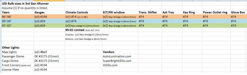

This picture is wrong. My map lights on my 97 sr5 4runner are 31mm, not ba9's. I wasted 6$ too. anyway I could put these ba9s to use?

Looks like there was no clarifications between models with or without a sunroof. Each have different map light sizes.
Classifieds? How about returning them?
31mm was to tight for my map lights. I used 29mm
I agree. Everyone keeps saying 31mm is the size to use but I had to bend the metal tabs for my dome and cargo lights to fit 31's in there. I think 29mm is the right size.
The 6$ isn't the problem. just jerking a chain over here, just put it out there so someone might fix it and save someone.
map lights they fit fine, my dome lights rear/front were a pain..\
