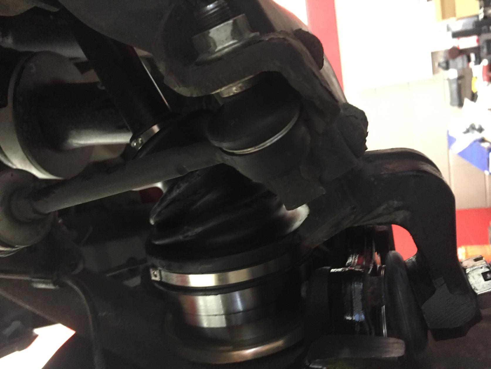

Video was taken at Eagle Automotive in Ottawa/Canada. I showed the video to Orleans Toyota and the original dealer in northern Montreal and they both said that the play is normal. What frustrates me is that the Orleans dealer said NO FREE PLAY, which is totally incorrect because there IS play.

There is a tolerance of movement, but it is very small. Not sure if yours is within or not, but to anyone on this board.. it needs to be NO movement at all. These ball joints are a poor design. It's not that they're weak or prone to failing.. it's just that when they go, they just f'n GO. So to side on the err of caution, you should replace them as soon as you see any movement whatsoever.
The people at that dealership are smoking crack. It doesn't even take a trained eye to see there is independent up and down movement in the joint. The joint naturally rolls in the socket but there shouldn't be up and down movement. Up and down movement is a dead giveaway there's play in the joint to allow for the ball to move up and down in the socket.
And, since the FSM says .5mm is an acceptable amount of movement, pretty much any movement you see is way too much. No way in hell are you going to see .5mm movement. You'd need a special dial gauge to read that and who has one of those in their toolbox. I just decided to change mine as preventative maintenance knowing there's pretty much no way to 100% tell your balljoints are good unless you have one of those special tools to take a reading.
Change both balljoints before you have a catastrophic failure and damage your rig and possibly get in an accident and injure yourself and any passengers.

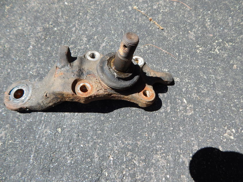

Changed this out the other day. Unknown mileage on lbj--truck has 217,000 miles. Had been like this since this winter. Joint moves smooth still and the other side's boot was still good but I'll sleep better with them changed out. mtbtim thanks for your video.
