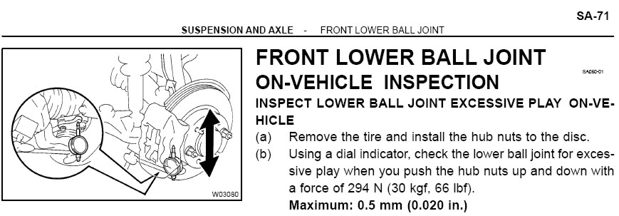

There is a test, at least for the lower ball joint.
Not sure how you'd measure 66 lbf in this situation.
I have performed this test procedure for years on my 96 4x4 Rnr. Used a floor jack to apply upward force with jack pushing up on brake rotor. Doing it this way loads the suspension as if setting on ground in normal operating conditions.
