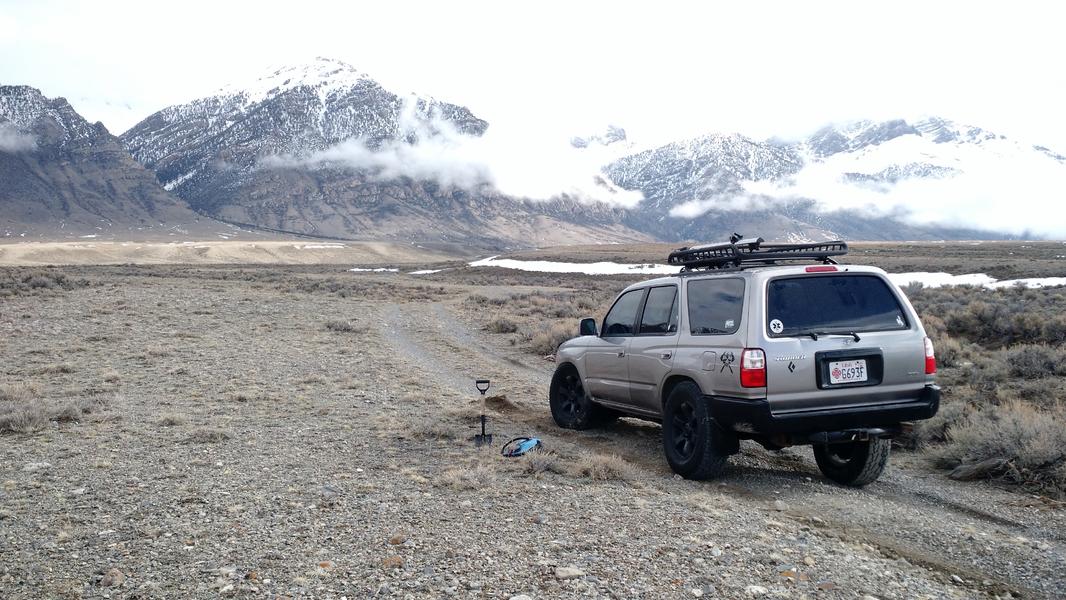

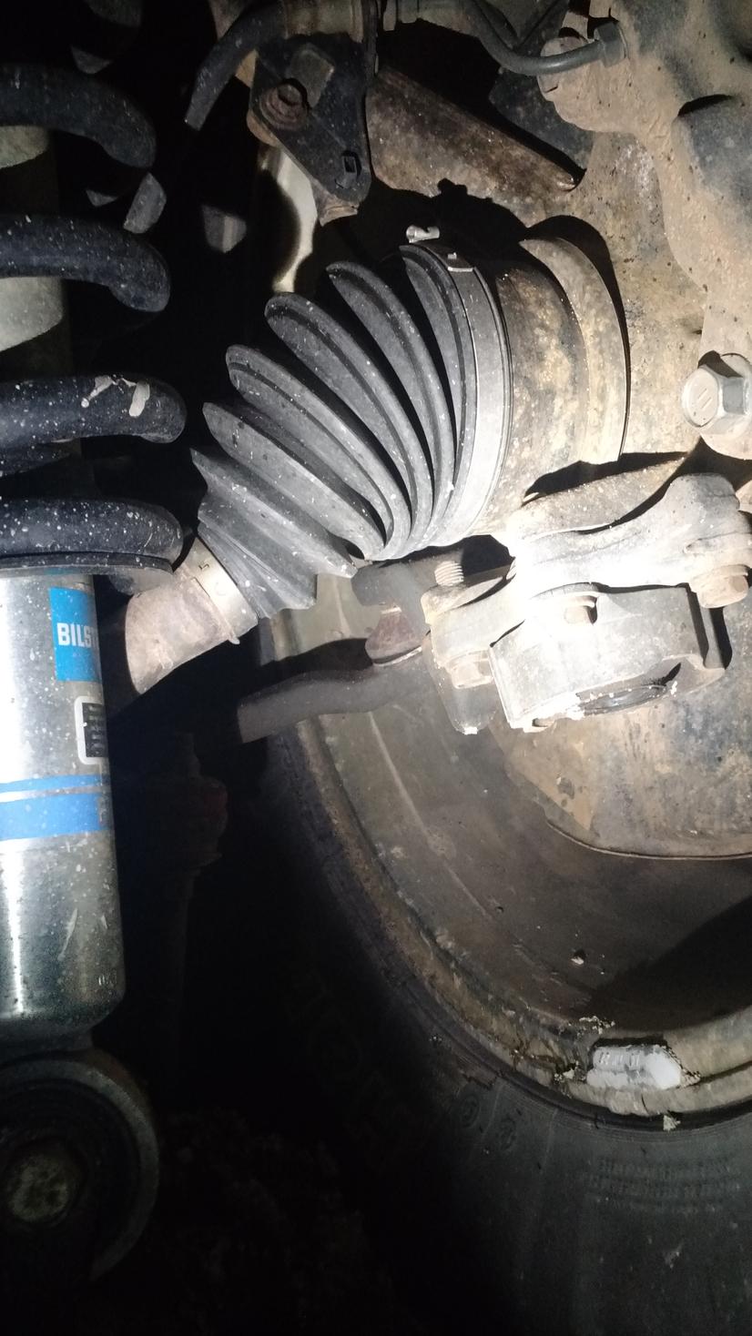

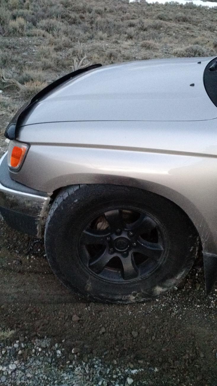

My Drivers side lower ball joint broke while driving on a dirt road, spent the night in my 4runner in pretty cold temps, replaced it on the trail with the help of some friends. And drove it to a mechanic to double check it and replace my CVjoint. Its been about a long year of feeling unsafe in my own vehicle. Recently replaced the left side again due to same noise I was hearing. Was made aware that in ball joint failures it is a good idea to replace the steering knuckle as well (the hole where the ball joint fits into), because it is weakened as a result of the failure. And the lower ball joints will continue to fail until this problem is addressed. I was wondering if anyone else has come across this? or has any idea how to replace the steering knuckle, looks like a lengthy process due to the face that the bolts seemed fused to remove it?
Every time another one of these is posted I start worrying again. I am truly glad you were okay but getting stuck up in the high country like that could be not so fun either. I just had my LBJ's done with OEM at 130k but I also do wheel this rig a bit so they get worked. I don't know about the steering knuckle but I'll be watching.
Any more info would be interesting....were they original LBJ's? Any idea how many miles on them? Have you wheeled the rig a lot? How much lift? Any warning signs? Etc. etc.
Also curious on the story getting out. Assuming no cell coverage so did you wait for someone to come along, hike out...? Just sounds like a good story. And I know doing it trailside would not be a lot of fun!
Going into more detail, Pretty sure they were the original ball joints. Third owner 200,000+ miles 2001, 2in suspension lift. (found out today on this forum that there was a recall on 2001 ball joints) Frequently went exploring on the trails in Moab which can get even the most experienced driver in trouble.
Noticed some noise while turning left for about a month prior to the failure, thought it was something else. All in all, not doing my research and being a dip#### is what did me in. :ybrick:
Postponed my MT. Church winter ascent and hiked 3 miles in the back roads of Idaho until I finally got service :hunter:
Called in a few favors, got the parts delivered to me and found out how to replace them. Waited 2 hours on the side of the road until helped arrived. The replacement went better than expected and the rest is history. So.... test your ball joints and don't put them off!!!!
