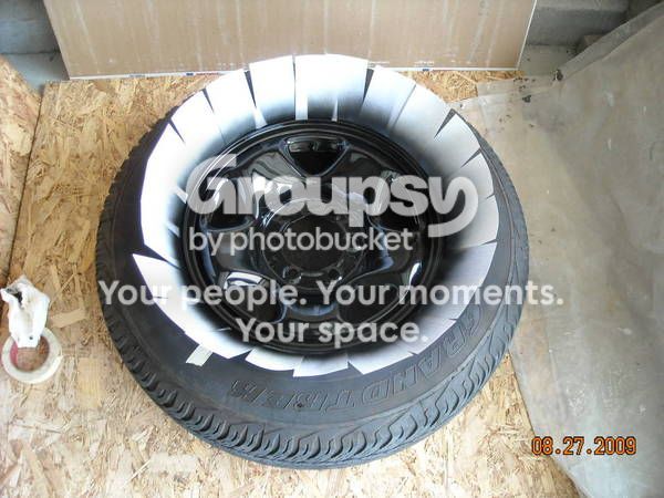

remove them.. if you have the resources (they can be painted on the truck.. much easier when off IMO). Wash them then sand them down, use some sort of paint thinner/mineral spirit to clean them up nicely after sanding. Next prime them which will fill in any small blemishes from sanding and let the paint stick. after youve primed them pick your colour.. i always use krylon otherwise automotive rim paint. Give it a few layers until satisfied (using gloss black for you) and if youd like.. i never have because i dont like the outcome, you can clearcoat them. If you take them off use a deck of cards like so :) Good luck!

Sweet! Thanks so much, would i sand them by hand? if so what level of sandpaper?
You could probably hand sand with 220. Maybe work your way up to 400 ish and then prime. Primer will cover up any imperfections at 220 so the rest is just personal preference.
I sanded mine with, first a drill, then by hand. then cleaned them with paint thinner, then 2 coats of primer, then 2 coats of satin black, and last but not least clear coat.

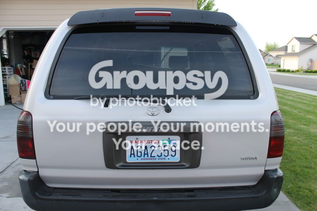

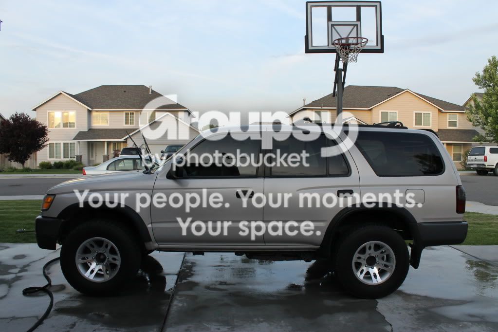

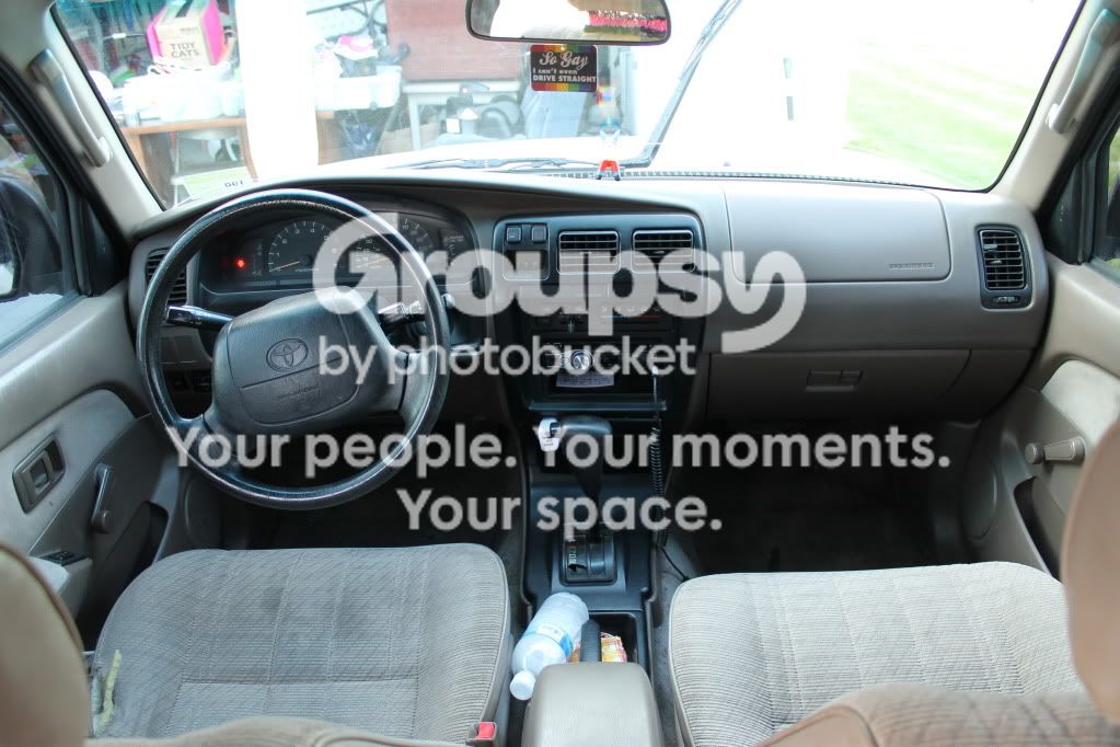

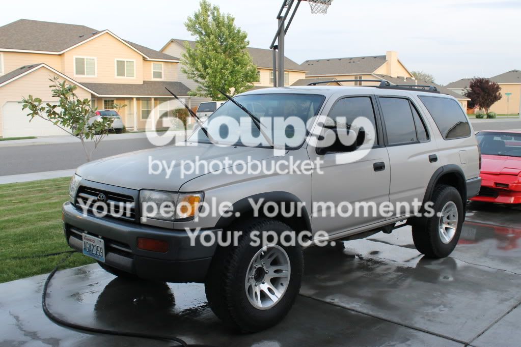

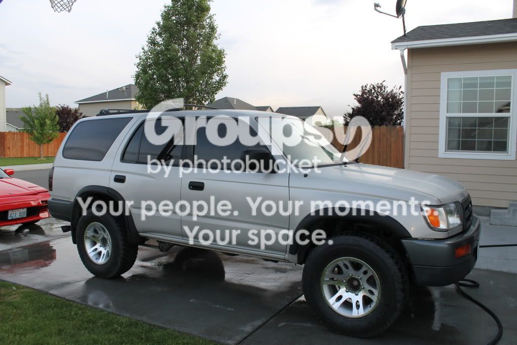

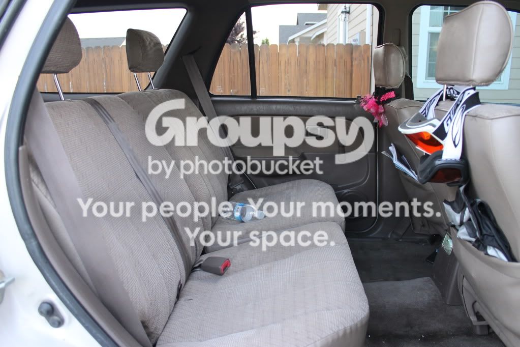

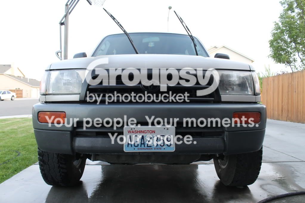

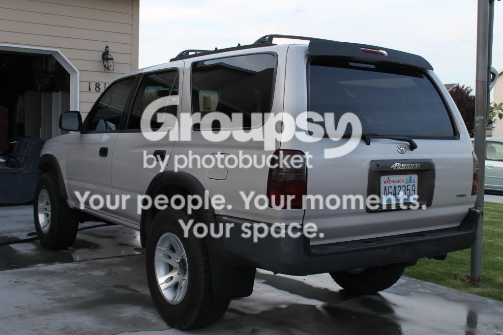

::update::

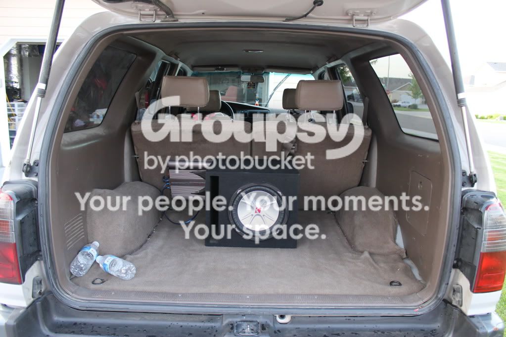

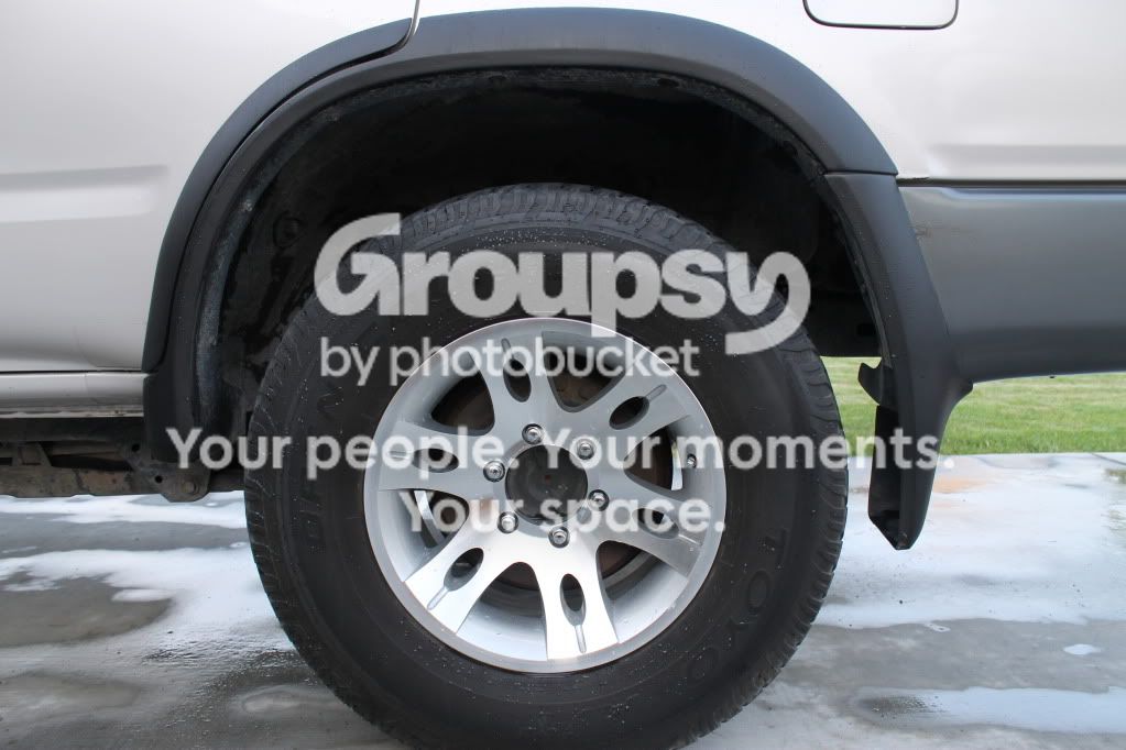

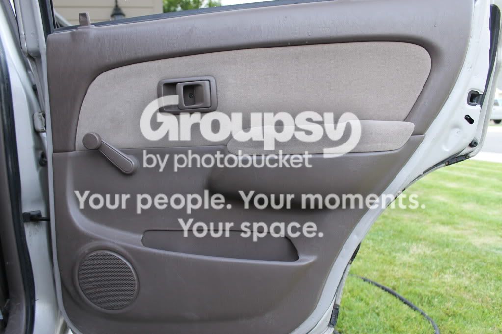

Here is some pictures of my Runner.
What I've done so far
-tinted tails
-all around window tint

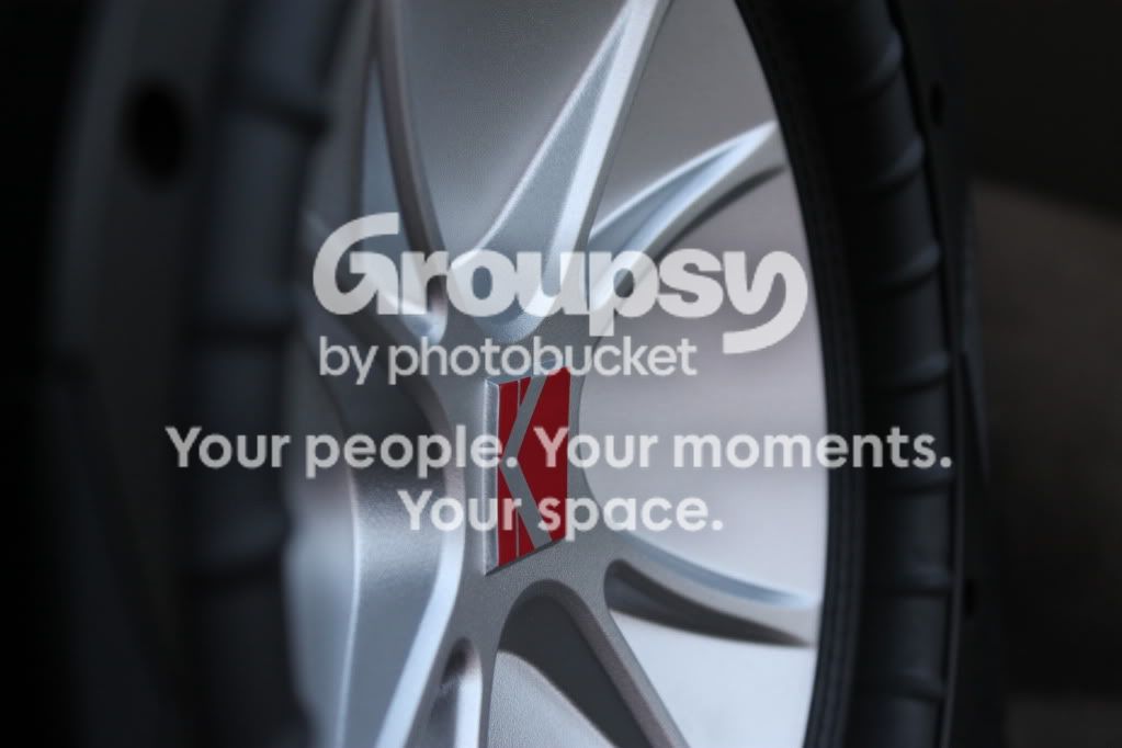

-10' kicker with 500W amp
-New JVC stereo
-Blacked out grill
-Newish tires and rims
Reminder, i'm only 16!
What I plan to do
-Sand and paint rims
-black front and back bumpers
-old man EMU lift
-flowmaster
-new sport hood, or regular idk.
-new windshield
-bug deflector
-weather guard/visors

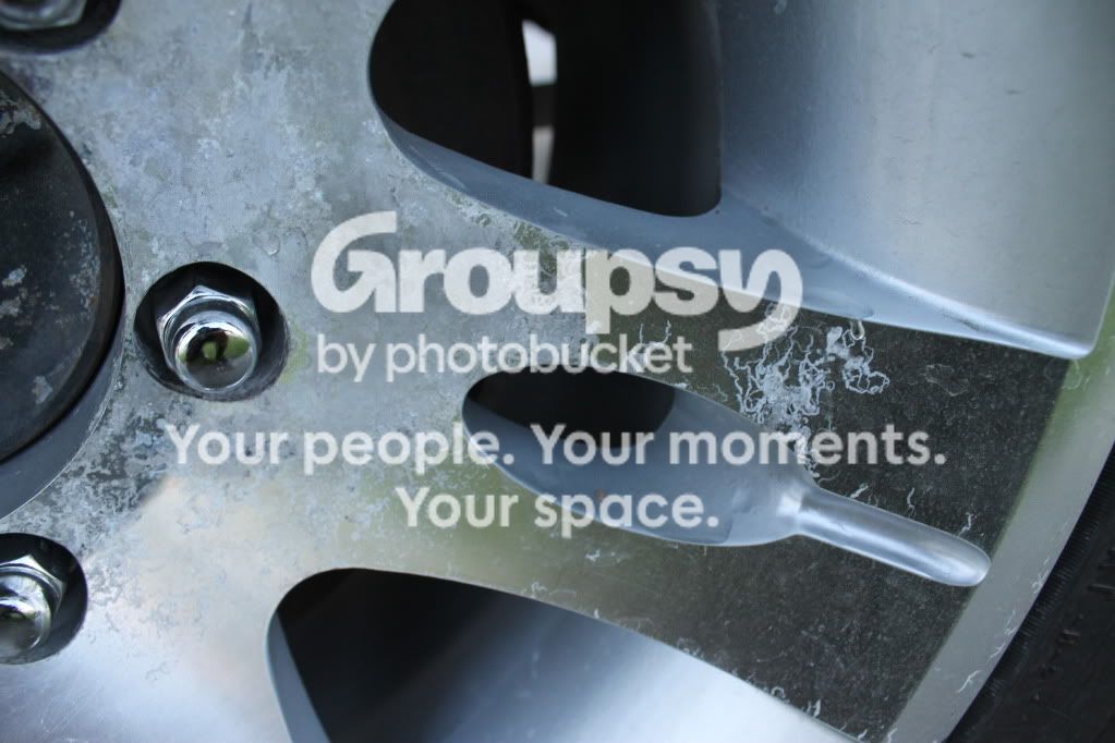

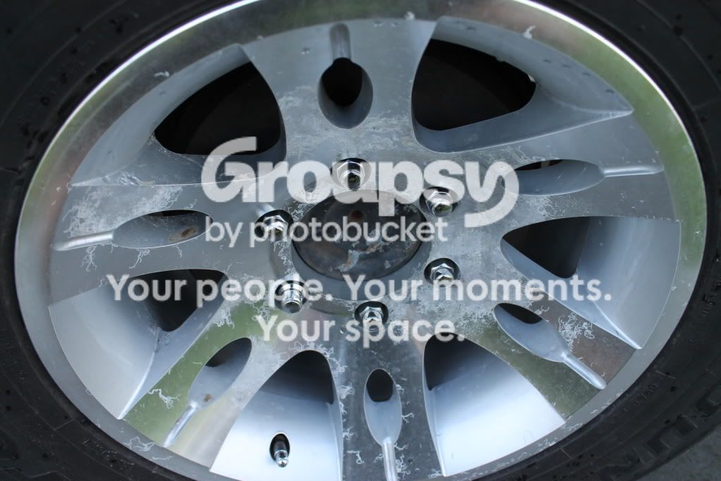

the BAD rim

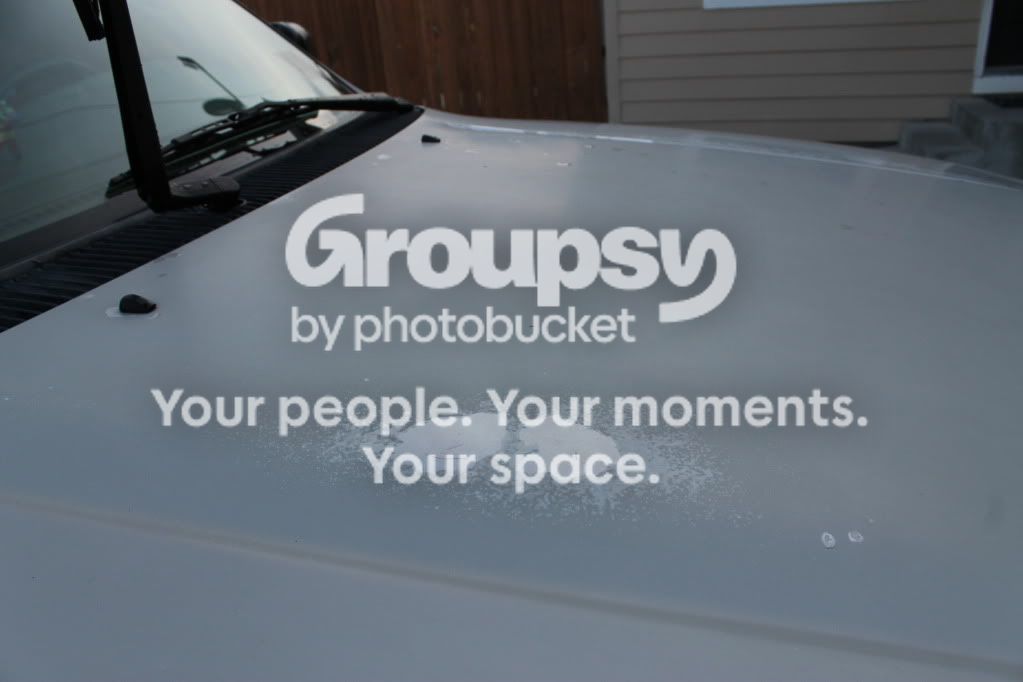

the nasty hood

HAHA!! I was hoping someone would notice that. I got it for my friends birthday and he just put it on my mirror. The girl who sold em to me said they were off a 4runner. MB Motoring is the brand. This style of wheels are discontinued tho.
Dude, awesome 4Runner. From a fellow young 4runner driver, I know how you feel! I've got a list of **** I want to do to mine but don't have the money to do any of it :( haha
What size wheels/tires do you have? They look good and my truck looks really similar to yours (with the light body color/black door handles). Eventually I'd like to upgrade to something that looks like that.
