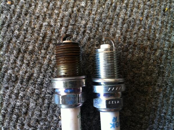

Changed spark plugs at 105k miles

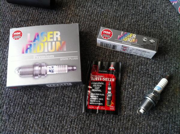

Well, I had some store credit at Autozone, so I went ahead and bought some spark plugs.
NGK Laser Iridiums. About $8 per plug.
It was pretty simple (although I only did the driver's side last night...see NOTES below).
Remove electrical plug from coil pack.
Unscrew coil pack bolt.
Remove coil pack.
Use spark plug socket (I think it was a 5/8") and extension to loosen plug.
Use long needle-nose pliers to grab loose plug.
Inspect (use one of the charts here). (I couldn't tell any obvious shortcomings here. Just looked old.)
Apply anti-seize to new plug.
Tighten by hand, then tighten gently with ratchet while compressing the crush washer.
Tighten a little more once washer is compressed. (Don't overdo this. You don't want to ruin the threads or break off the plug.)

Just curious why you needed a needle nose pliers to remove plug if you used a spark plug socket? Sounds like you lost the rubber cushion insert in the socket.
They make a rubber insert? That would have helped.
(My socket was a one-off from harbor freight. Need to put a nice set of deep sockets on the birthday list.)
I've got a pretty good tip regarding this. If you're spark plug socket doesn't pull it out, stick your coil end back down in the tube and it should pluck it right out.
Just be ready for some effort.

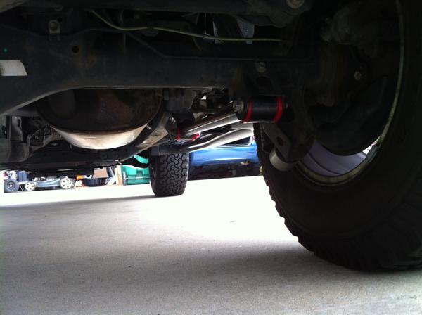

Changed my LCA bushings this morning, sorry to clog up your thread but I just wanted to say thanks again for the inspiration and write-up! Took about 9 hours. But that included removing/adjusting my COs & searching for a lost nut for over an hour, then waiting another hour for my girlfriend to bring me a replacement.
The grinding/torching was very tedious and I don't understand how you peeled the rubber from the bushing, I had to use a bench grinder with a wire wheel for about 15 min/bushing. I was completely covered in rubber particles..
The results seem impressive, I'll know more after I get it re-aligned. I believe I had misdiagnosed my caliper/rotor as well.
The grinding/torching was very tedious and I don't understand how you peeled the rubber from the bushing, I had to use a bench grinder with a wire wheel for about 15 min/bushing. I was completely covered in rubber particles...
I think for the inner metal bushing, I was able to torch it from the inside out. I might have neglected to mention that I made a lengthwise slice in the rubber bushing also. That way, when it heated up (~20 minutes of heating), I was able to "unpeel" the rubber bushing from around the metal inner bushing.
Even so, some of the rubber stayed on the metal, so I spent 15 minutes over the wire brush cleaning it up, too.
I'm ready to start on the rears, but I wasn't able to easily press out the old bushings, so I put it back together and need to find a day where I have access to a machine shop.
This was an excellent tip, and helped greatly when I finished the passenger side.
There was one plug that I still had to use my skinny pliers for, though. Other than that, it worked great. Thanks.

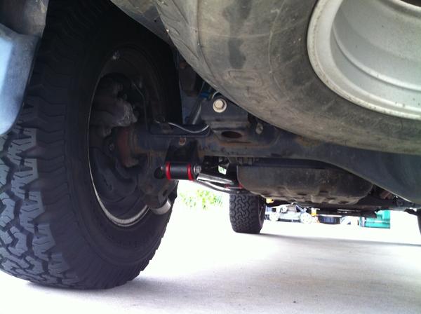

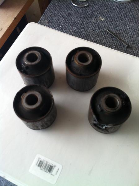

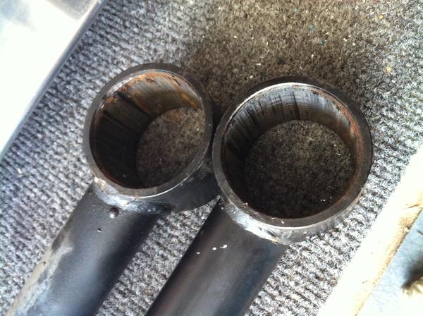

Not much a writeup, but I managed to the the rear lower control arm bushings changed. If you're keeping count, I still need to do the front and rear Upper Control Arm bushings.
I've been having pulsation while braking, and after replacing the rear pads, rotors, and flushing the system, I figured I'd better check out the bushings in the rear (same as the front, chased a shimmy while braking to the control arm bushings, and replacing them fixed it).
Anyway, here come the pictures. I didn't mess around with cutting them out myself. I took them to a machine shop to have them pressed out. Turns out he couldn't press them out, so instead of charging me $5 to press them all out, he charged me $30 and cut them out.
Empty control arms, before cleaning.
Then, I got dirty, and stopped snapping pictures, but here's the end result.
It took my pulsation while braking down to about half, so I'm assuming the upper rear control arm bushings are also bad, and I'll need to do those soon.

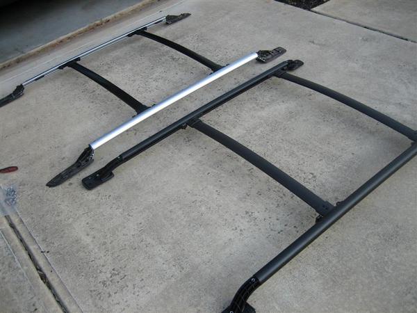

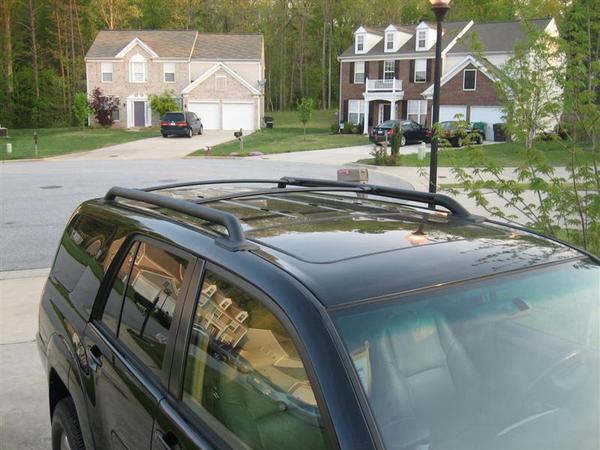

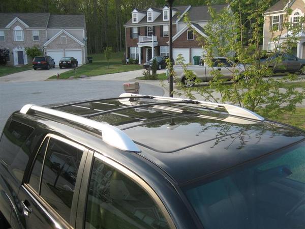

Well, I got an email this afternoon from UPS stating that my Urban Runner Roof Rack had arrived, so you can imagine my excitement upon seeing the HUGE box at the front door.
Anyway, I got it unpacked and got to work taking off my current rack. (I think I am going to try to sell my current (stock) rack in the classifieds, so I'm going to take a couple pictures. Here's the original rack, still in pretty good condition. (It has a couple chips of paint missing, but otherwise is in great condition.):
Then, I spent about 45 minutes trying to figure out how to pop off the covers in the four corners. Once that was done, I got the rest of the rack taken off. The runner looks so naked without a roof rack.
Once I got the new one mocked up on the ground, I snapped this pic for comparison. (Sorry, should have included the decorative pieces on both racks. Use your imagination.)
And of course Toyota decides to use a (T40-size) star bit for the attach bolts for the Urban Runner rack. Do I have a star bit? YES! Is it a T-40? NOPE.
So, off to Autozone to buy a whole set. By the time I got home, I got everything installed, but the pictures at night didn't do it justice. I'll try to grab one before leaving for work tomorrow.
But, I'm very happy with the new rack. It actually looks much more rugged than the normal rack, which is a little too sleek (and silver) for me. If you are interested in the old rack, let me know. I don't want to make a lot of money off of it, just want to get it out of the garage, and figured someone here would be happier with it than the garbage man.
More pics in the morning, I promise.
EDIT: Here they are!
