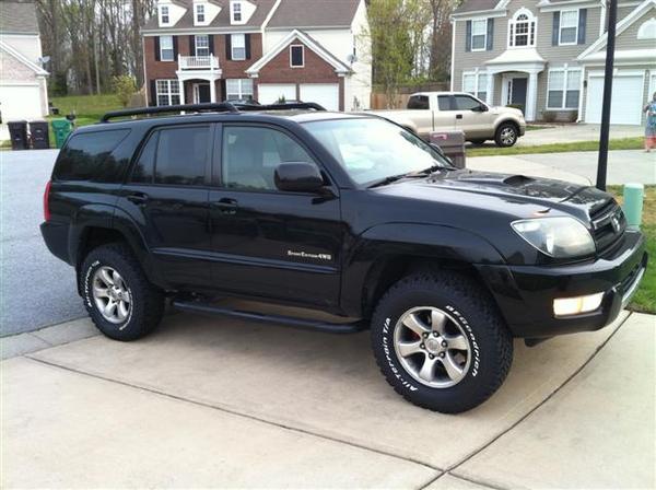

Looks nice and level man, did you stay at 0.85? Can't wait to see more pics!!!
Here's the latest, and yes, I left it at 0.85".
It looks a little reverse raked, but it's not, just my back tires sitting in the dip at the end of my driveway.
very nice! how does it ride? Just waiting on shipping and I am doing the same!

The ride is far improved. Much less brake dive, and way more stable around the corners. Highly recommended.
I do have some rubbing just behind the front bumper, but I'm going to follow all the other posters here and move the wheel well liner forward an inch or so. That should do it.

Much improved look, I've wanted to do the FJ springs and 5100's for a long time, problem is that I park underground and can't go above 6 foot tall. Can you tell me what the height difference is now that you didn't gain 4"
Bfg at 265/70r17

I'll try to get a measurement tonight.
For now, I have an updated pic with the new tires.
I did en eyeball measurement (held a tape measure on the ground, then looked across the tape measure, and saw where the two roof rack bars lined up.
I got 73.5", but the crossmembers might be a half inch taller.
Keep in mind, the urban runner bars are a little taller than the stock ones, but you might be cutting it close in the garage.
Sorry for the bad news.
Thanks for the info, I'm actually planning to move to a taller garage, so problem averted :nicethread:

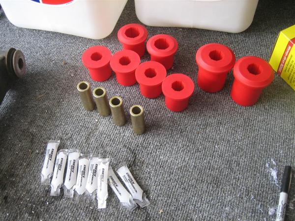

Here's what comes in the kit:
Everyone seems to love Poly bushings, and from all the reviews, no residual noise, and everyone seems to claim that the ride is better. Skeptical, but let's see how it goes.

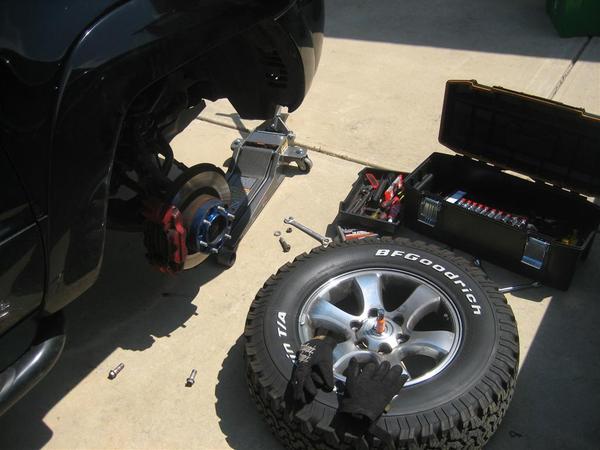

First off, let's get these beautiful tires off.

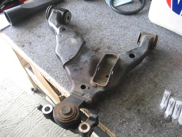

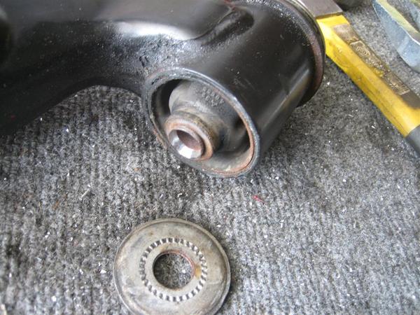

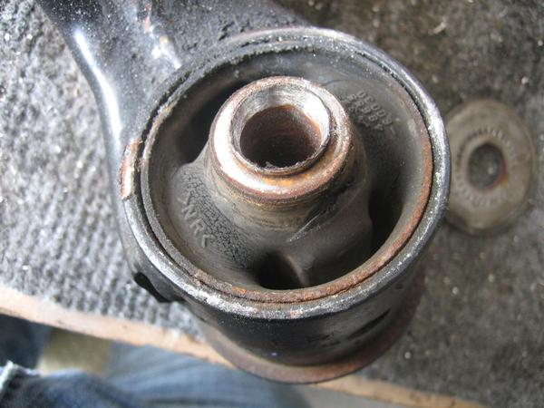

Here are my current control arms and bushings.

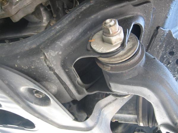

Be sure to place matchmarks on the front and rear adjusting cams
before you start. You will need to use these matchmarks to reinstall
the lower control arms back in the same position after the new
polyurethane bushings are installed. Torque to 100 ft-lbs. Then have
the vehicle’s alignment checked by a certified technician . The
alignment must be within factory specifications.

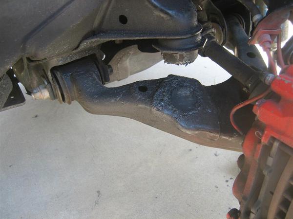

Here's my "mark." (Really honey? You had ORANGE nail polish? Yikes.)

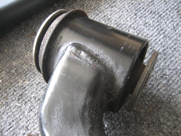

After pulling the LCA off:
A closeup:

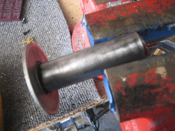

Grind the flare that holds the inner washers in place
on the lower control arm. Only grind off about half
the thickness of the flare. Clamp the washer in a
vice then work the lower control arm back and forth
just enough to get the washer off without braking off
the flare. Washer will be reused on install.

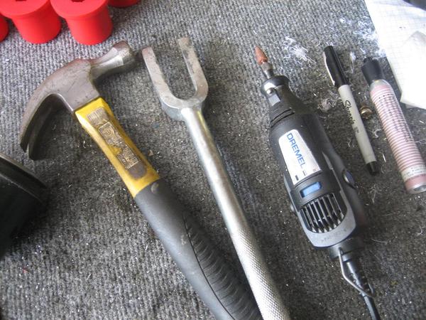

I used these:
And ended up with this:

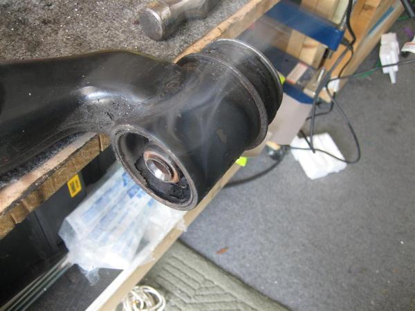

This was the part I was most nervous about, but it went perfectly. The first time, I kept heating it up gradually, then trying to apply a lot of force. Didn't work. Gradually, I built up the courage to leave the heat on a little longer. (Good smoke coming from the edges of the bushings, then gently prying the bushing out. This took about 10 solid minutes of direct blowtorch to achieve. I used a laser thermometer at one point, and I could hear the rubber separate from the sleeve at about 500°. Don't be shy, and be quick to blow out any rubber that catches on fire.)
Smoking:

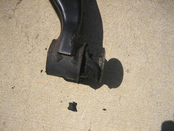

After prying (one hint here. See how I was able to apply heat towards the bottom of the picture, but not behind the connecting arm? The bushing stuck in place there, and it was a biatch to pry out later. On the second LCA, I spent some time heating up that arm, and the tube underneath that arm to get the whole bushing to pry out. Saved me a lot of time.)
Once the inner sleeve with bushing is pried out of the outer shell, I made a lengthwise cut with a boxcutter down the bushing. Then, I heated up the inner sleeve from the inside, stuck a screwdriver in the cut I just made, and peeled the bushing from the inner shell. Had I not made the cut, I would have had to slide the hot bushing off the shell. Much easier to peel. Then. Clean that sucker off.

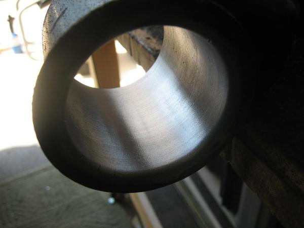

Here's the inside of the outer sleeve, after cleaning with a wire brush.

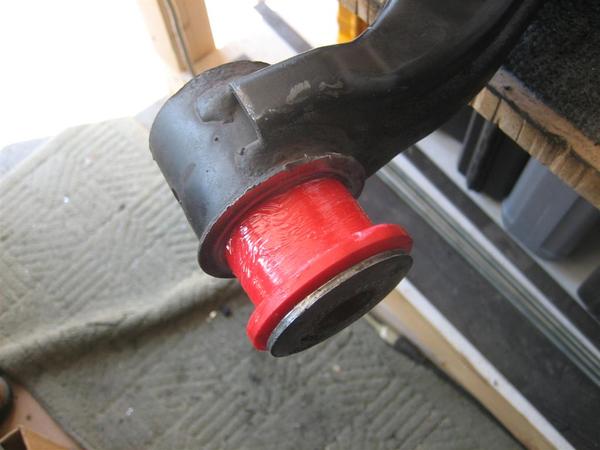

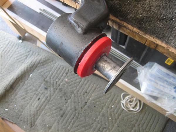

Grease ID of shell in LCA. Grease all sides of the bushing that will contact metal and install the bushings. Grease and install sleeve with embossed washer. Install the embossed washer back over the flare and reflare using a ball bearing or ball pen hammer.
Well, I repeated this for the other side. It took me about 8 hours. 7.75 hours on Saturday, having gotten frustrated that I couldn't get the last of 4 bushings pressed in all the way, then 15 minutes on Sunday after I realized how to do it (I have a bench vise!!!).
