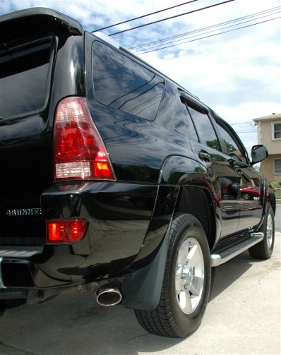

Guys I hate to bust chops on this but you are all wasting your money on Zaino. I gave the runner another coat of mothers glaze today and as usual it looks better than new. We are talking like unser $6.00 a bottle and it lasts years. Easy on easy off......Trust me on this its all the same....

that must be what's professional detailers is using, glaze, glad you're happy with the result.
damn i wasted my money on zaino, i guess i have to buy a porter cable and pads to get close to your glazed truck.
Jak: I am at work and cant view pics! Im sure shes looking good!
AK: Different strokes for different folks :) Ive used OTC products before. I was an avid Megs user, and I find Zaino to be better as far as durability. And it only seems expensive because you buy a kit with everything you need to detail your vehicle! If you only get the Z2 (which you can get by with) its like $13. Your last line has me confused! Are you saying that the bottle of wax will last for a year, or that the coat of wax on your 4R will last a year?

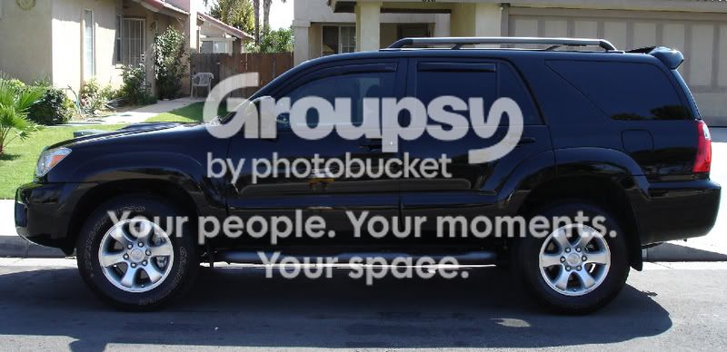

Looking good! How hard was it to de-badge? Im thinking about doing this. Looks more clean like that.
Glaze is just a lighter product than wax, it is used to enhance shine over a good wax job. The mothers glaze is applied by hand and goes on and off with ease. I can do the entire truck in 20 minutes. All I am saying is that these products work for a fraction of the price and have been around for many years. and they work just as well.
one of the easiest mod

it was very easy, all you need is a heat gun, on my case i used my other half's hair dryer.
just a little patience, because you want to heat those letters slowly and rocking each letter back n forth until they're loose enough to be peeled one by one. work one letter at a time. in some case, i even used dental floos. have a adhesive remover (3M) to clean up some adhesive leftovers.
there's plenty of threads regarding debadging.
Just heat the badge letters up with a hair dryer (not a heat gun) and pull them straight off the door without rocking them to much. if you rock them to much the letters may dig into the paint.
