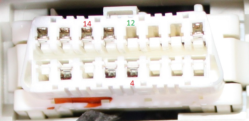

This is the method I use. #4 and #14 later T4R use #12
Parked flat and level, steering wheel straight.
1. Ensure the shift lever is in Park.
2. Turn the ignition switch ON.
3. Using SST 09843–18040 (paper clip), repeat a cycle of short and open between terminals Ts and CG of DLC3 4 times or more within 8 seconds.

could not see what year your truck is, but if its an 05, then its slightly different, i had problems doing the zpc on my 05, until i came across a post by a memeber, the 05 requires a slight change, go through my posts, you will see what i did, if you have an 05
edit: for an 05, use pin 12, instead of pin 14

#12 for '05 and later T4R, as I stated in my previous post.

Yeah I used those exact pins in the picture, 4 and 14. When I am performing step number 3 however, everytime it is connected for the split second the VSC OFF / TRAC OFF go away while it is connected but then CRUISE CONTROL blinks, the airbag picture blinks and the ABS starts blinking. Ive never seen this before.

for an 05, use pin #12, and not pin #14.

Just a quick question concerning the zero point calibration, people keep referencing pins 4 & 14, but my chart shows pins 4 & 12???? Am I looking at somethinmg different here, or does the pin location change with vehicle model year??? I have a 2006 that I need to calibrate but don't like the idea of making smoke by plugging in the wrong pin location
Toyota changed the OBDII protocols in 2005. Pre 2005, the correct pins were 4 and 14. Post 2005 the correct pins are 4 and 12. If you have a 2005 it could be either, depending on mfg date.
