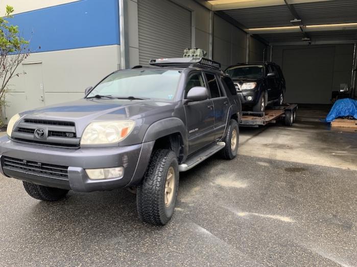

Fast forward to the first week of December. I browsed craigslist for random 4runner parts and stumbled upon a 2006 Shadow Mica v8 4WD sport. It had a bad engine. I called up the person and drove up 2 days later to pick it up. So now I have 2 4runner v8 4wd vehicles sitting in my driveway. I truly fell in love with the sport facelift model so I decided to keep that one and give my dad the supercharged one. So here starts the build.

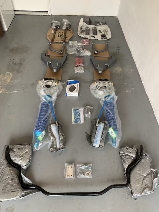

Total Chaos 2” Race Long Travel Kit - #86002-R
King Shocks 8” Long Travel Coilovers with adjusters - TC5119-03A
Total Chaos 2” Long Travel sway bar - 86090
Total Chaos spindle gussets with sway bar mounts- 59698-SB
Total Chaos coil bucket gussets - to be installed - 59651
Total Chaos cam tab gussets - to be installed - 59860
Total Chaos diff drop spacers. -87200

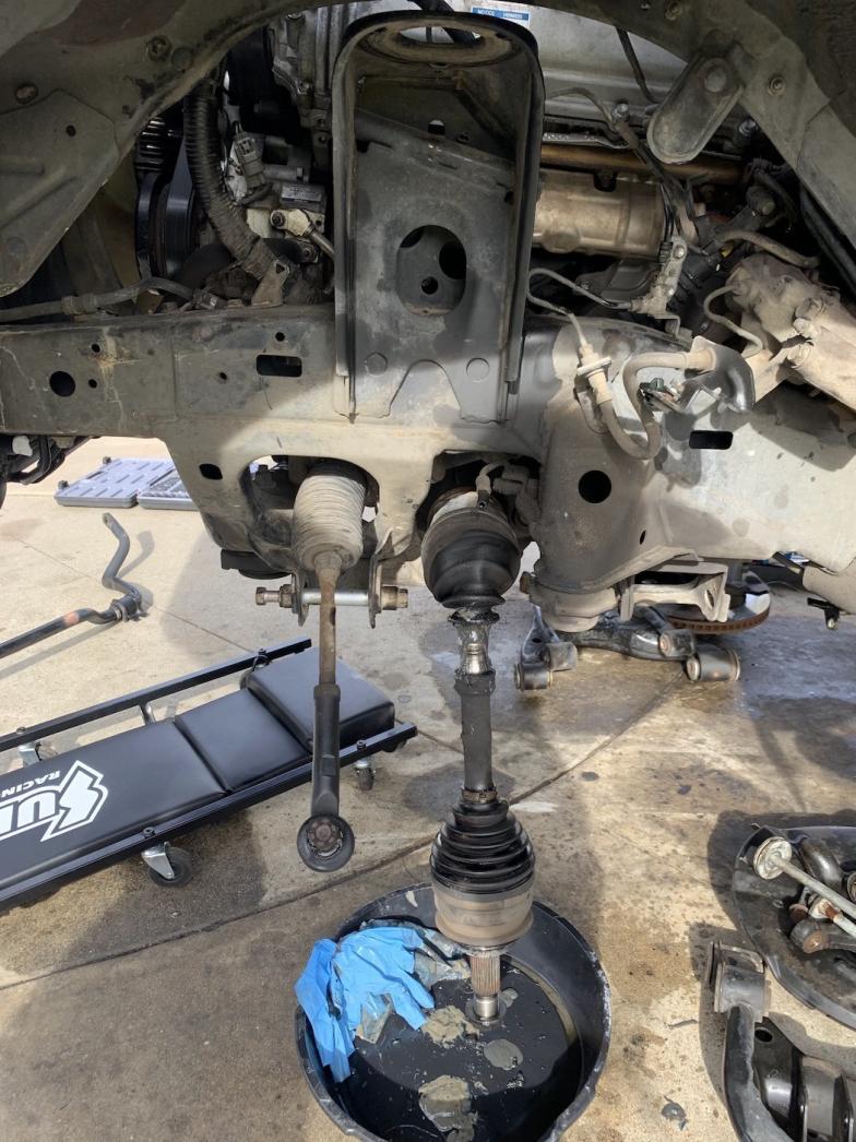

All Pro off road 2” extended axles - CE-AP-6307-KIT or AP-306914
Toyota genuine boot kit x2 - 04427-60141
Rear -

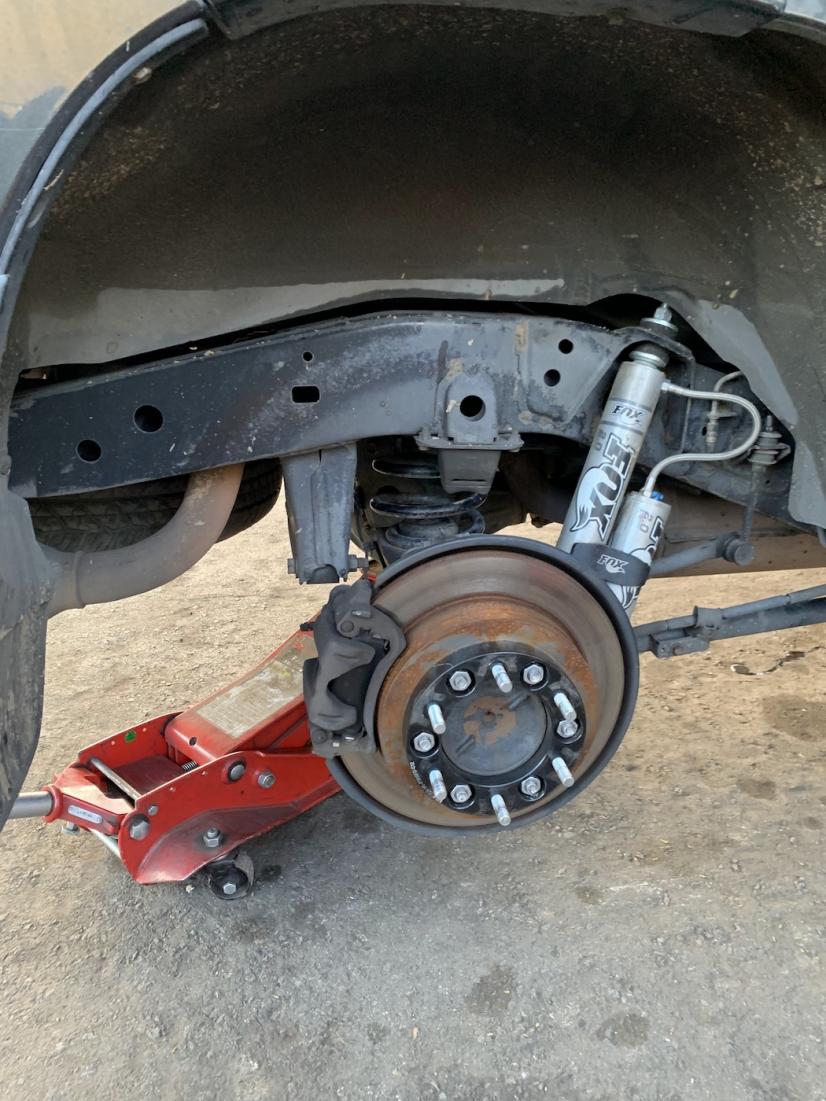

Fox Shocks 2.0 extended travel shocks with adjusters - 895-26-118
OME 895 rear springs
Icon Vehicle Dynamics upper link arms

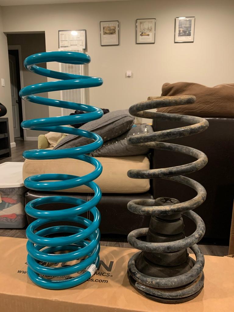

Dobinsons long travel springs - C59-677V

12/07/2019 - The Day I picked her up:

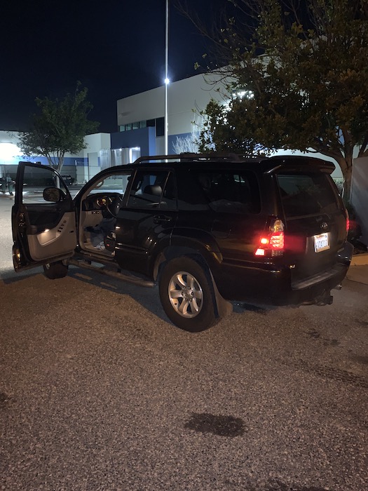

12/09/2019 - The first time she ran since I picked her up. 104k miles on the new to her engine - 2 days from purchase to full engine swap:

12/21/2019 - Heavy Dissassembly:

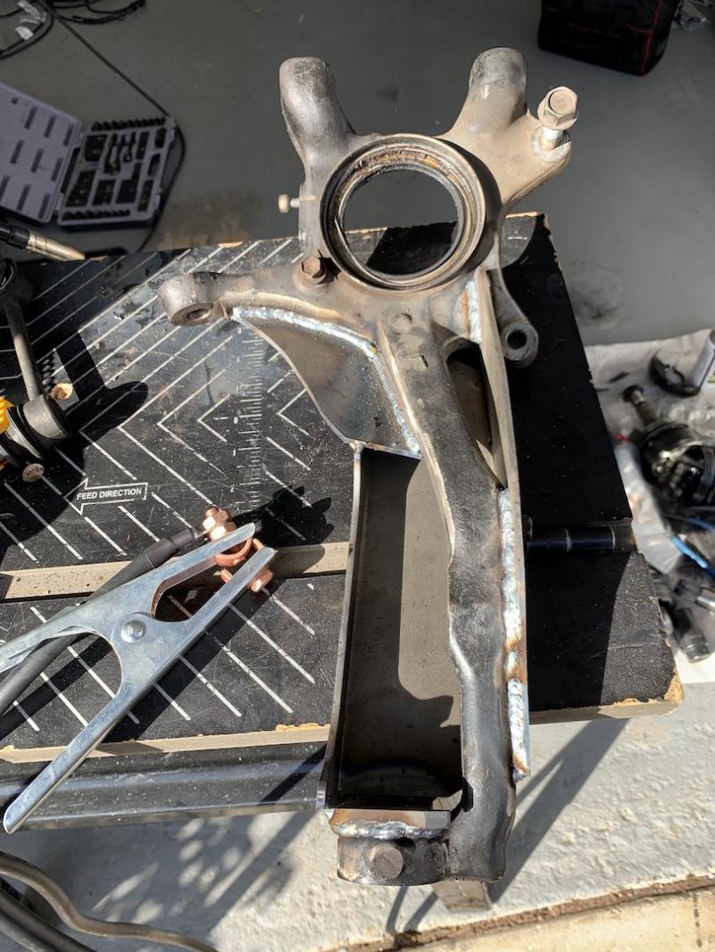

12/24/2019 Spindle weld goodness:

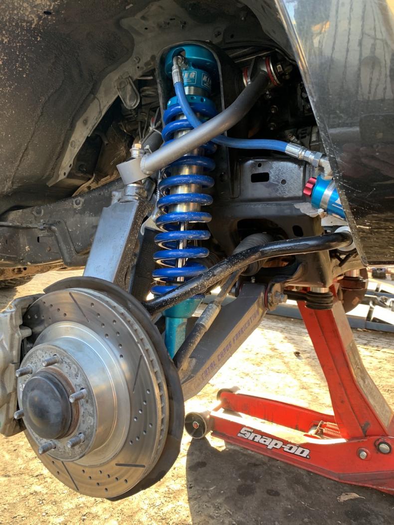

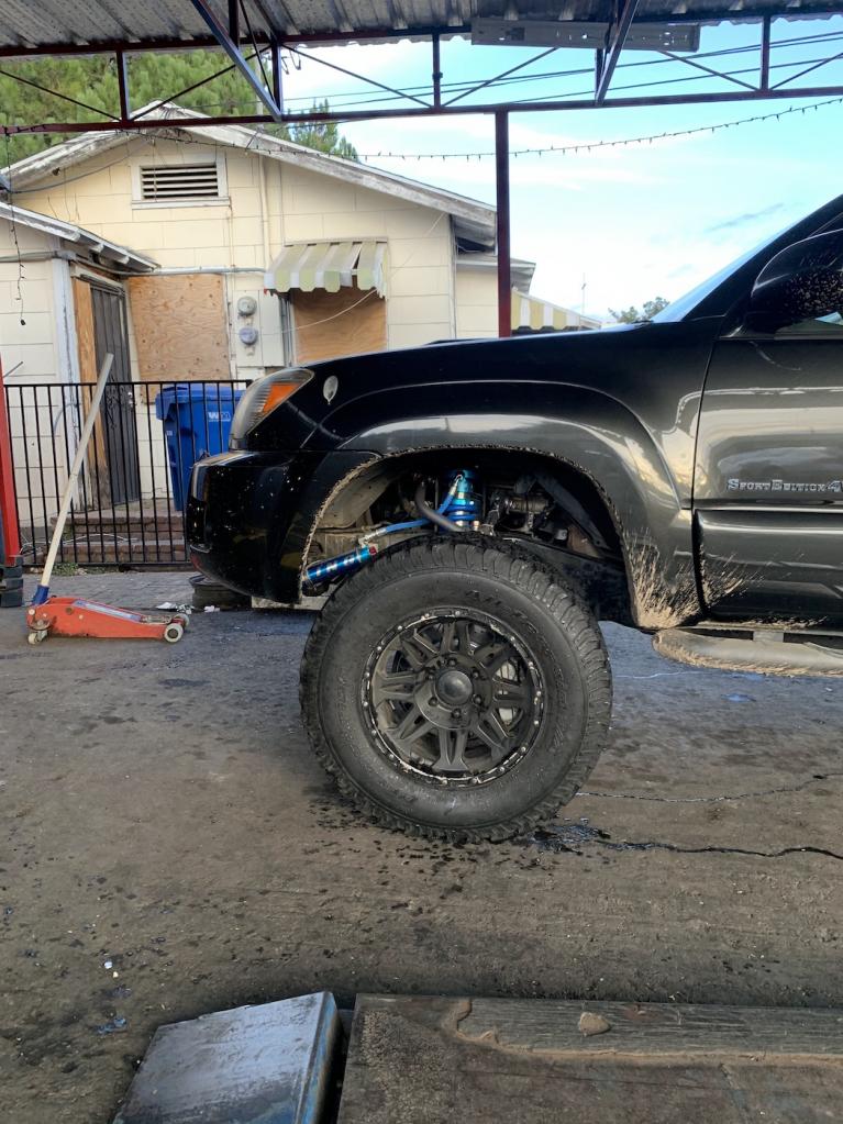

1/08/2020 - full droop front
1/08/2020 - wheel off lifted from the axle. NEEDS MOAR DROOP

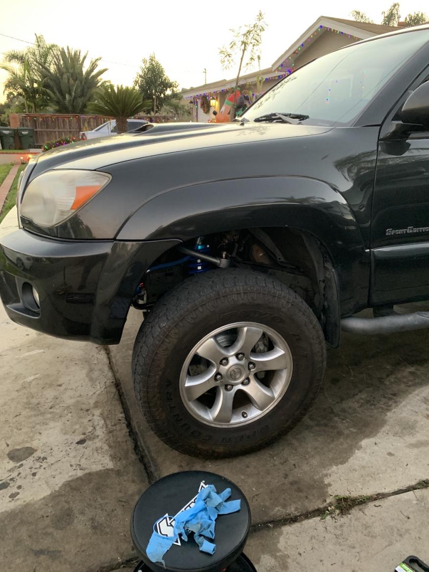

12/28/2019 - The First time the front stood under its own power after the install:

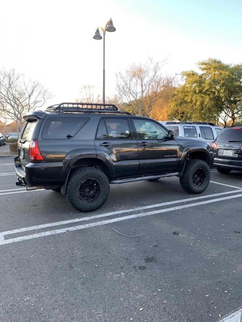

12/31/2019 - How she currently sits in all her glory:

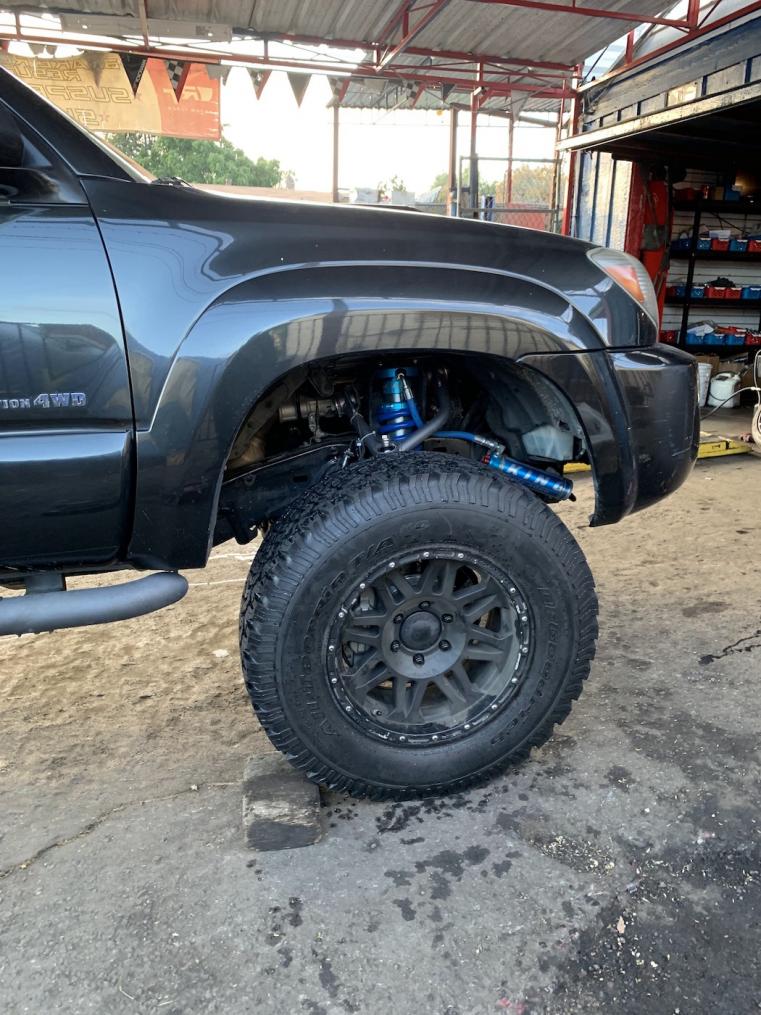

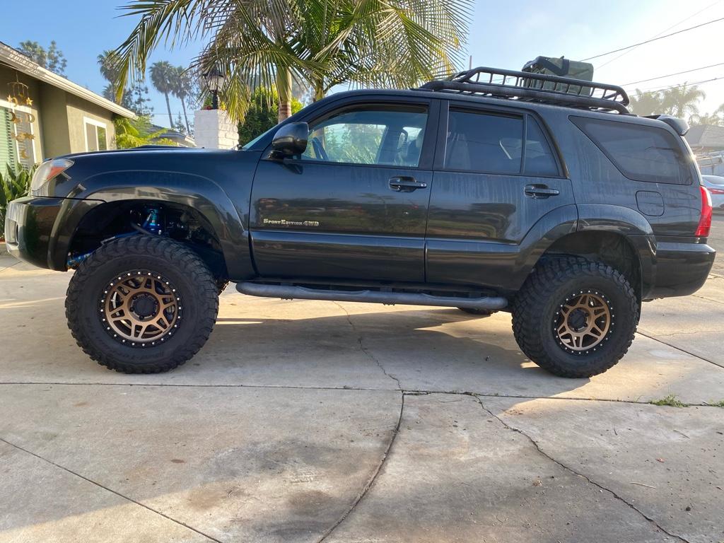

1/08/2020 - Decided to step down in size to 285 70 17 BFG KO. BFG seems to run small for its size but the 305 70 17 BFG KM2 were insanely heavy with no gearing

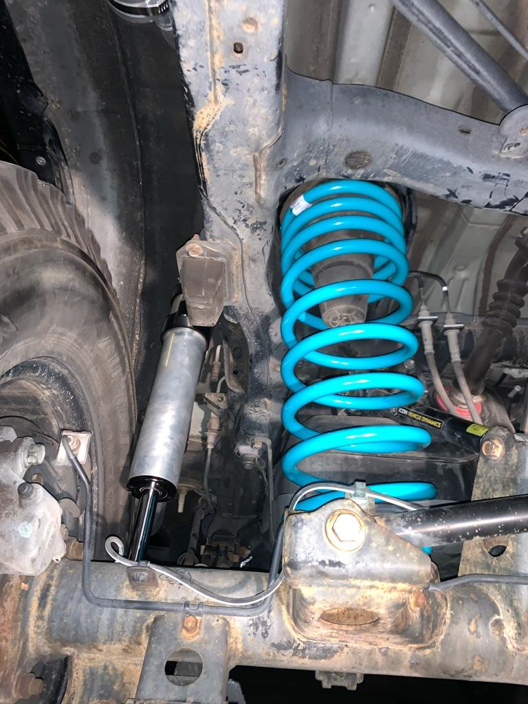

1/20/2020 - installed the dobinsons c59-675v long travel coils with Icon long travel remote reservoir shocks with adjusters

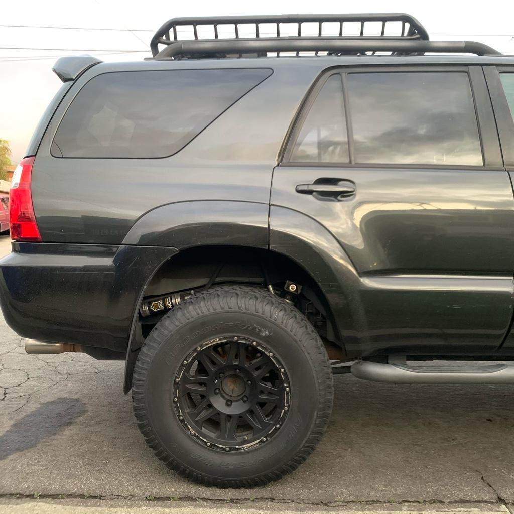

2/14/2020 - got some method mesh wheels with e rated KO2 in 285 70 17 off a forum member.

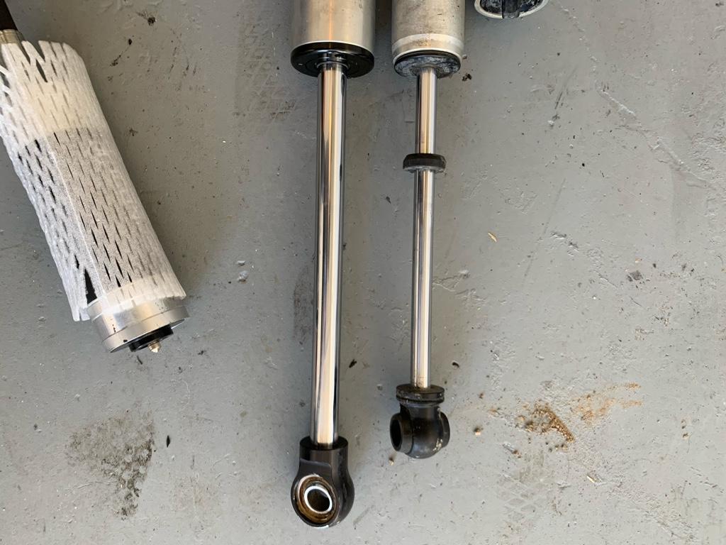

3/17/2020 - I installed some used Icon Omega dual bypass shocks. I sacrificed an inch of shock travel in exchange for tuneability. Also, I hadn’t fully committed to a welded in upper shock mount so this was more reliable than my bolt in experiment. This will do until I go 12” king triple bypass.

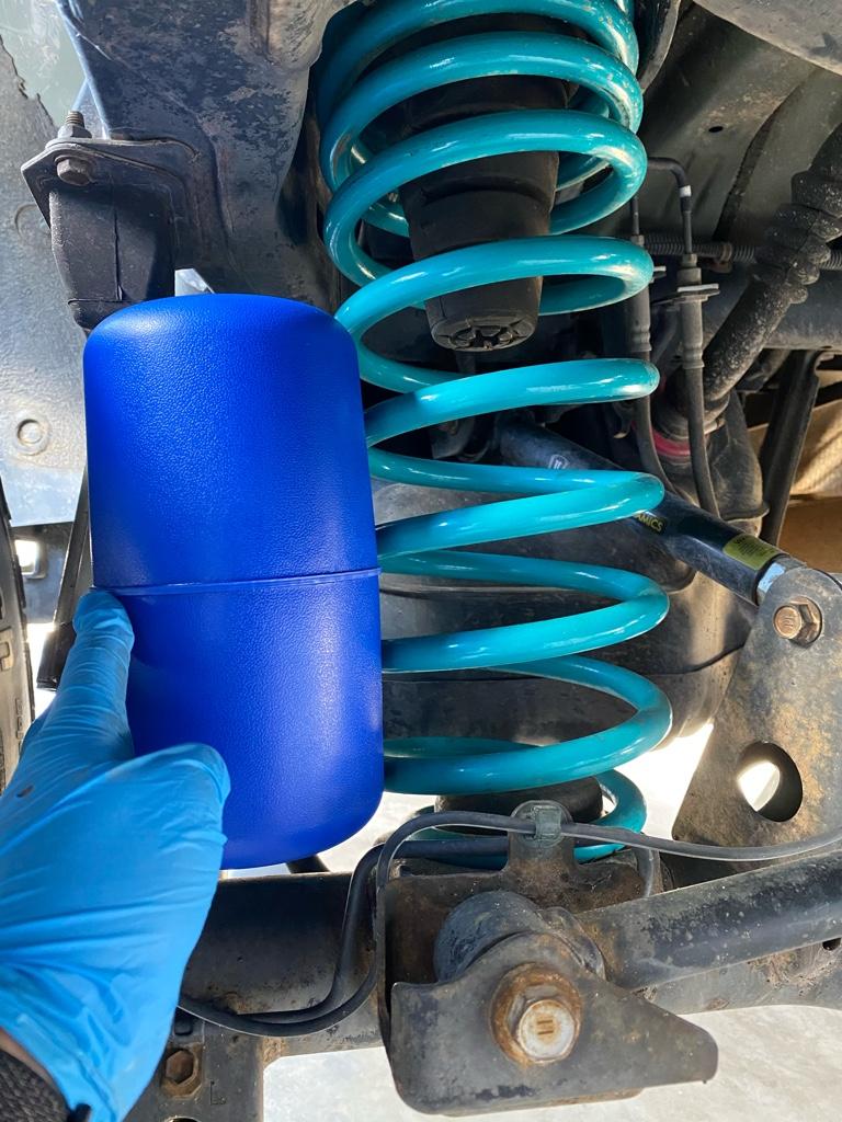

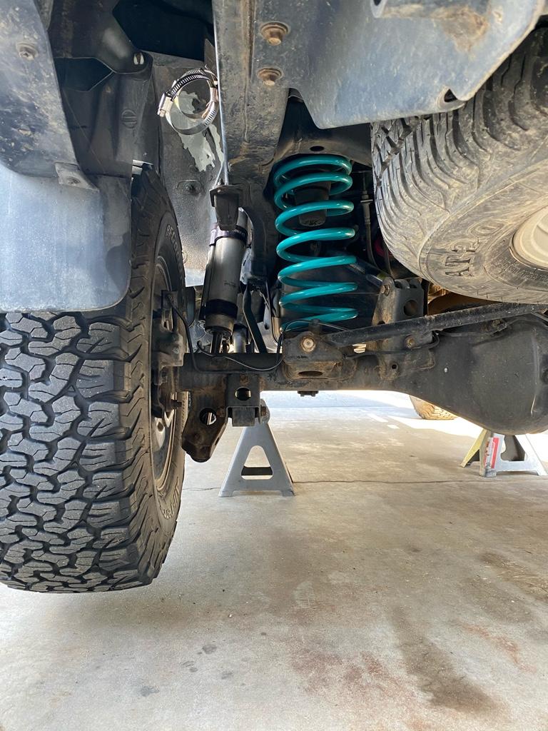

4/21/2020 - I decided that I hated the sag while towing the boat so I installed the firestone coil-rite 9” air bags. So far, I like the ride.

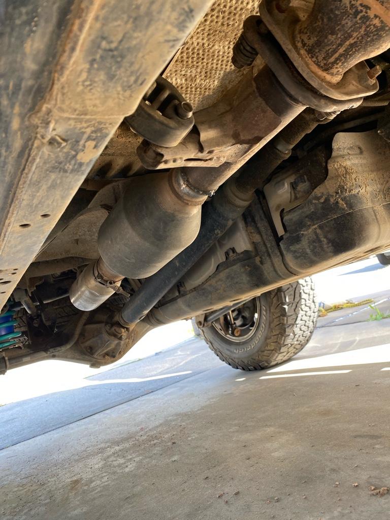

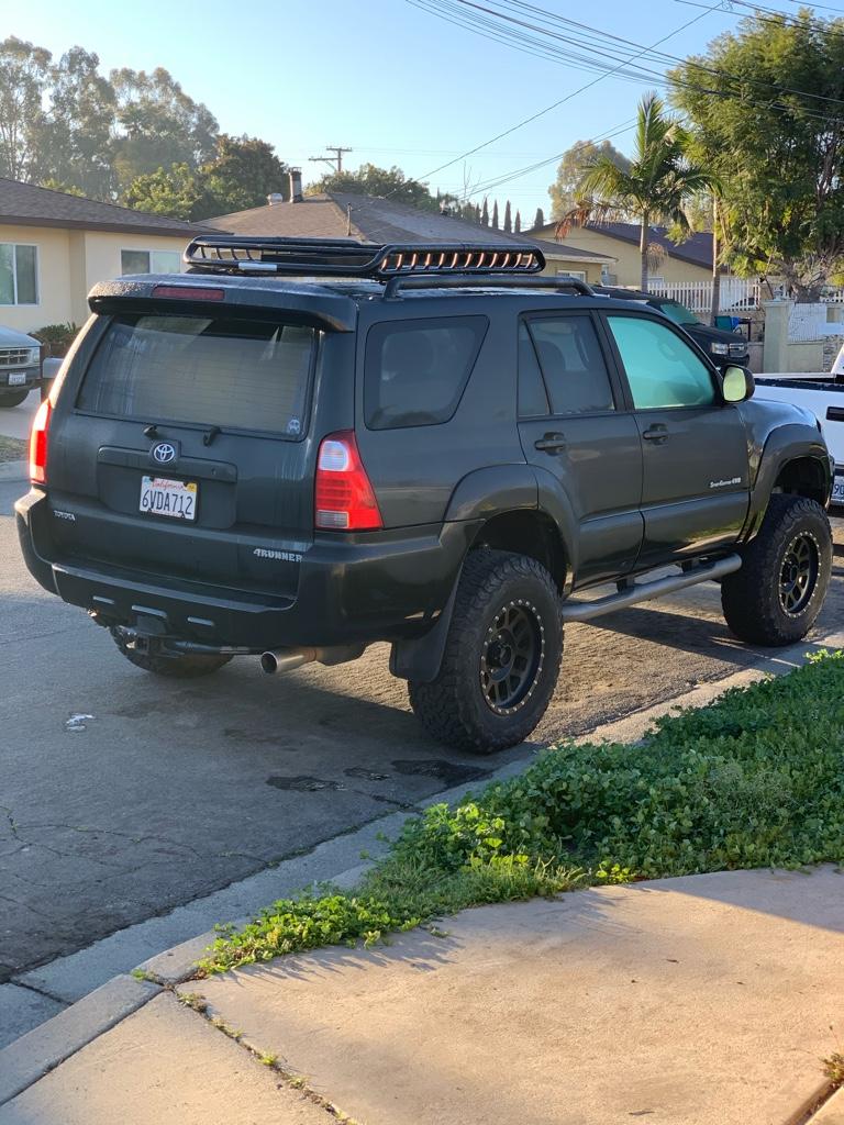

4/22/2020 - I got bored so I chopped off my muffler. I took the stock resonator and welded it in place of the muffler. I think it sounds pretty good and it’s not loud at all. I will most likely weld in a bend to point down at a 45 degree angle. Once the quarantine is over, Ill have a custom y pipe and muffler set up.

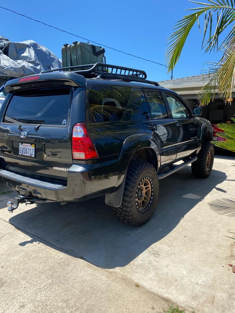

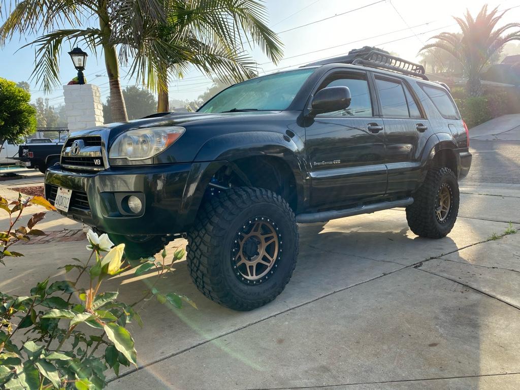

4/24/2020 - I mounted up a set of method 312 bronze 17x8.5 with 285 70 17 km3’s. I think these are the keepers. Heavy as all hell, but they look fantastic. It will be a good excuse to mount the custom bumper mount spare tire swing out.

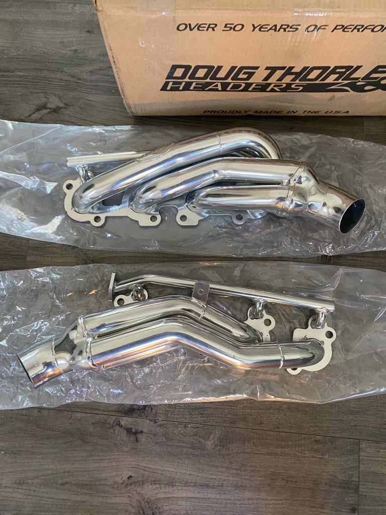

4/24/2020 - doug thorley shortie headers came in. These aren’t as easy to install so just some unboxing porn for now.

Great looking suspension! did you ever get those headers installed? Were you able to get the passenger side header past the steering shaft?

I haven’t gotten that far yet. I’ve been using the rig a lot lately for errands (including a ton of sod today, literally)
I’m hoping I can do it soon. Since I can’t get a hold of someone’s old headers, I need to pull mine, build a jig and straight pipe it. Just got my renewal notice and no smog needed until July 2021!
