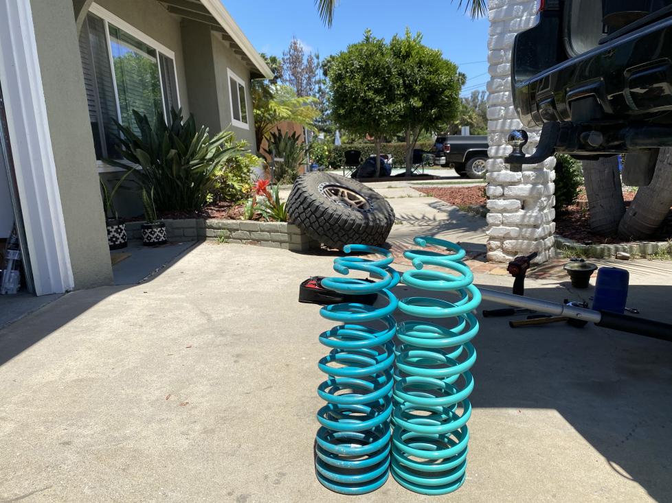

5/12/2020 - I swapped the Dobinson c59-675v to the 677v. They came black so I sprayed them an off the shelf teal. Not an exact match but close. IMG_4217.jpg

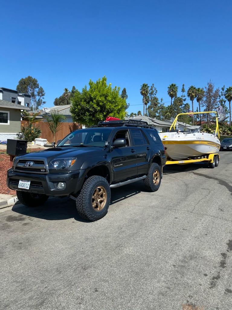

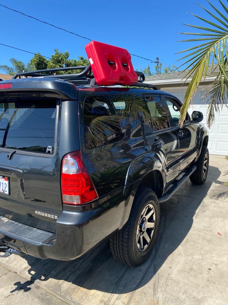

I added a Rotopax fuelpax to the side of the Rola roof rack. A little extra fuel capacity for the long towing trips.

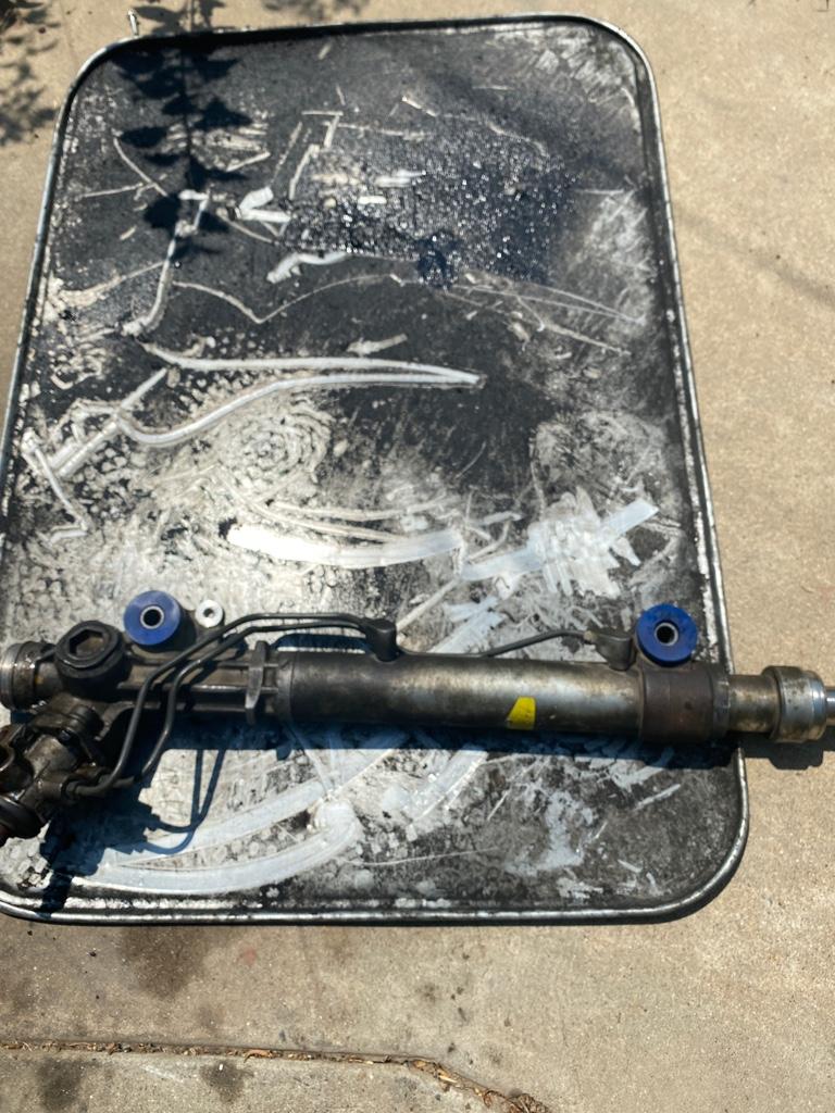

8/27/2020 - Almost missed this one. Spent some time refreshing all the steering components. It's not glorious work or shiny new mods, but it transformed the feel of the car. I made a write up you can find in my profile about it. All new tie rod ends, rack bushings lubed everything up.

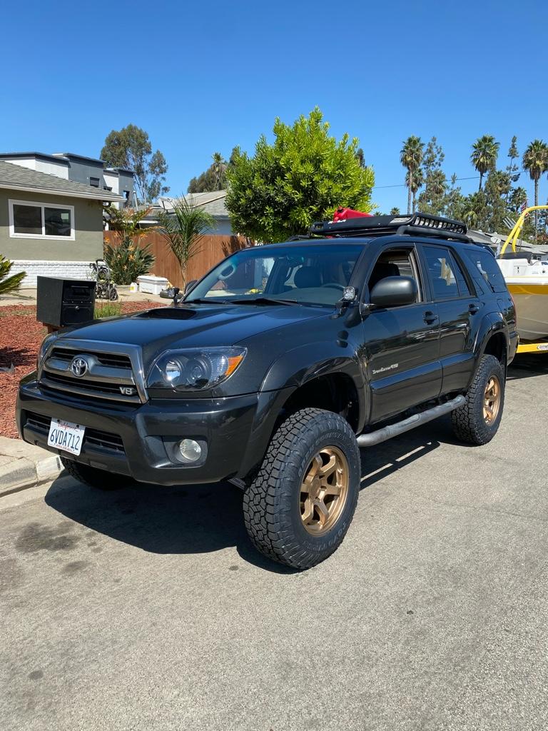

8/31/2020 - She spent a few weeks on 5th gen trd orp wheels/tires while I waited for my new wheel/tire setup to come in. I have to say, it didn't look half bad and they weighed 31lb lighter per corner. Made a huge difference in the MPG and towing department.

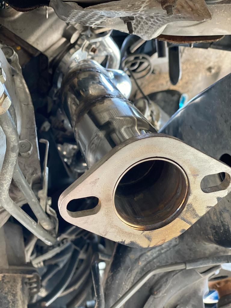

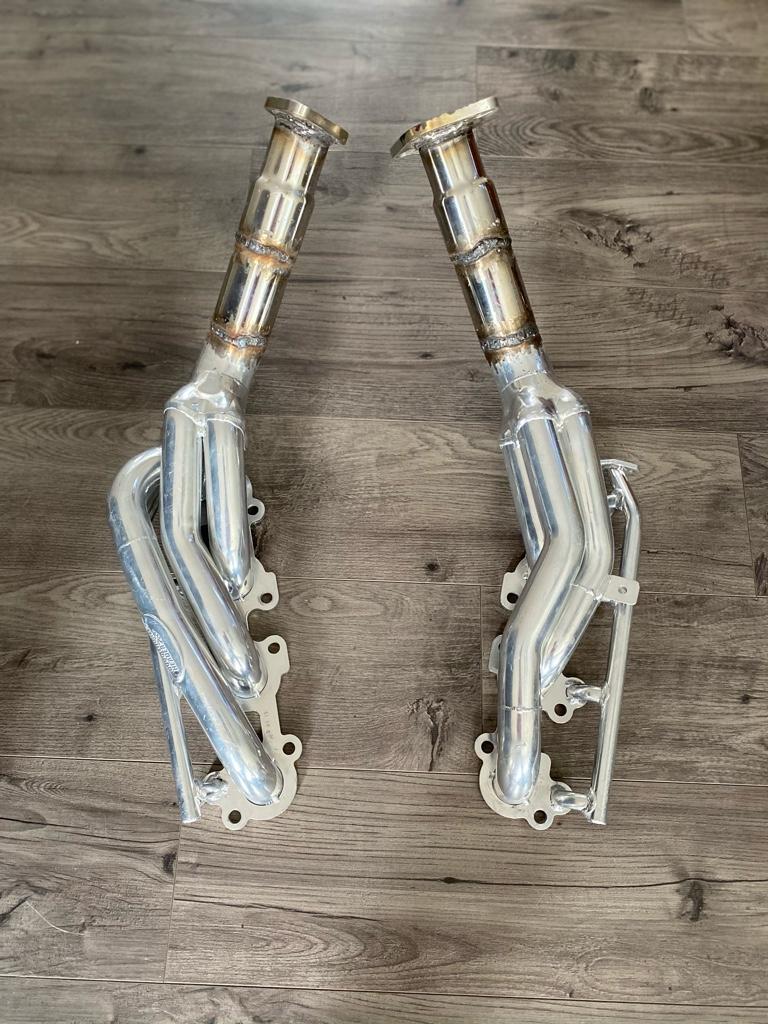

9/13/2020 - Finally installed the headers. Instead of hacking up my stock cats, I straight piped the shorties. I used all stainless components. 2.5" pipe to 2.25 reducers to 2.25 flanges. I have to admit that I tried to use flux core stainless welding wire and it boogered it up. I ended up having a friend silicone bronze braze the welds. Not the prettiest end product but ended up working out at least. Definitely do not short cut the welding process. Either TIG or gas MIG weld. Do it right.
I ended up trying 2 different o2 sensor spacers which alone failed, but together, have kept the CEL off for a good week now.

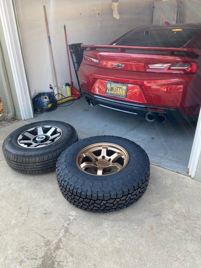

9/18/2020 - My new wheel/tire setup showed up.
Specs:
Motegi Traillite 17x8.5 offset 0
Toyo Open Country atiii 255 80 17 E rated
