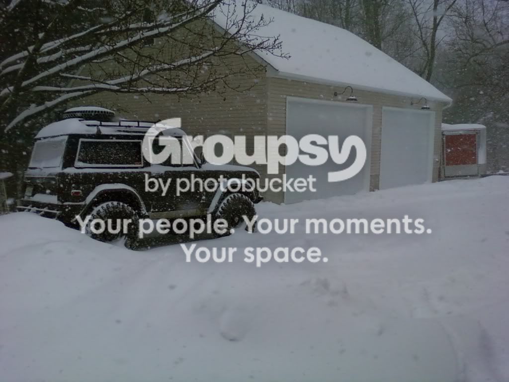

Thanks, I ran them on my Early Bronco I built a few years back,and really liked them, they are great in the snow and are really sticky on the rocks, and @ 150/tire you can't go wrong! they may not wear as long as some others, but this is not a DD so I was not concerned with super high mileage out of them.
No kidding?! I've got an EB also. I'm from GA originally and used to go to a ton of the eastern Bronco events.
Regarding the IROKs i know they hook up, i've been really intrigued lately at their emergence as a DD tire for more and more people. I would love to try a set of them one day. My tires always are destroyed from offroading long before they wear out from the street. :wacko:
Here is my EB, sold it about 4 years ago, missed it hence the T4R purchase.
Nice! You wasted no time, I see! :thumb:
Great looking rig, and those wheels, even though I still prefer the factory 5 Stars, are loads of improvement over the split spokes.
Judging by those wheeling pics I see sliders in your future :)
edit... I just re-read the first post... I see that on your future list. RTFP Mike!
