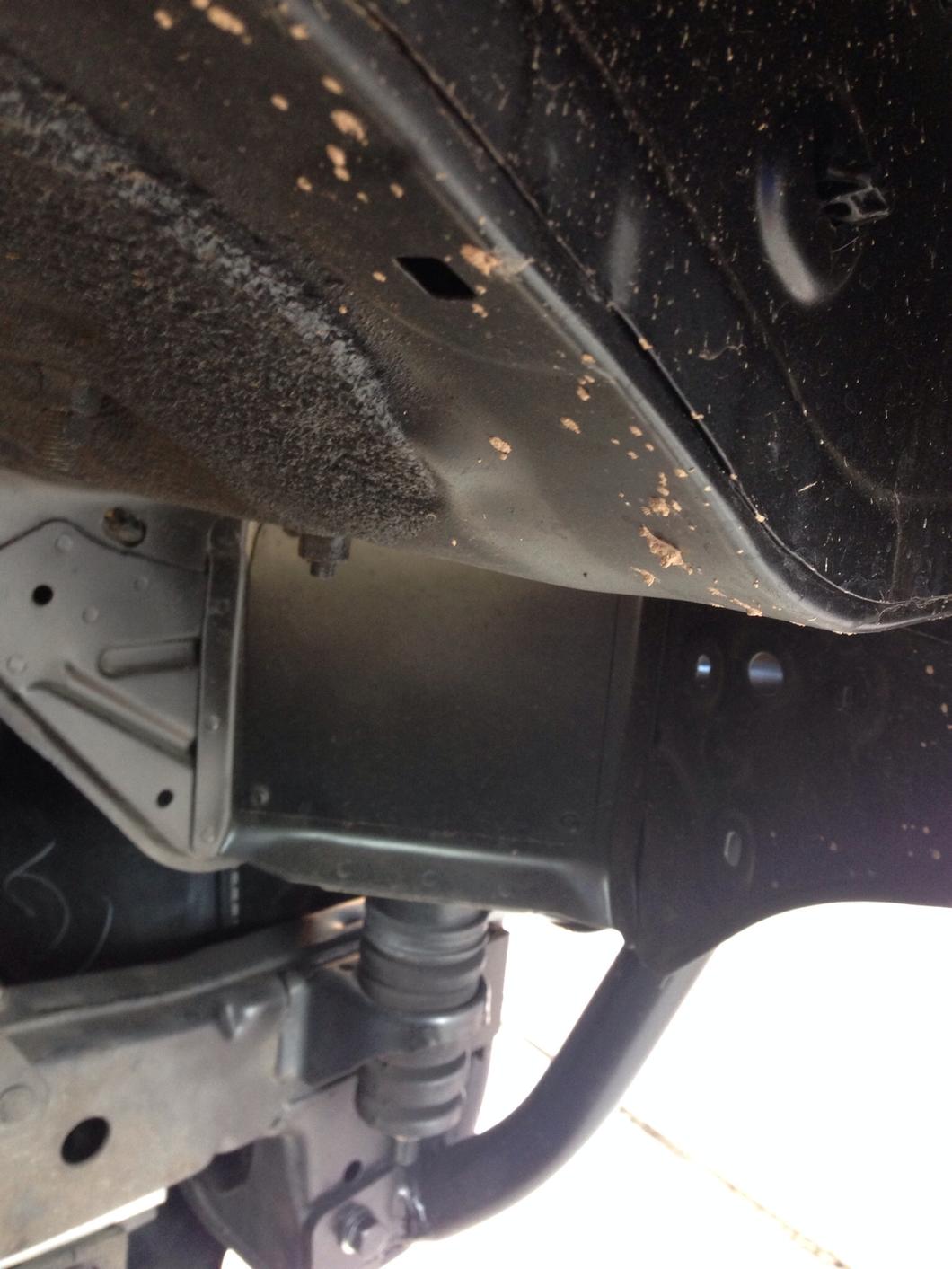

the toytec lift has been awesome, the ride is amazing. a few friends have even said for a lifted truck it doesn't make them want to not ride with me. the lift comes already pre set for the max 3" recommended, I used the rodger brown body lift but I think I did 2" lift. the steering link extension ended up being the hardest part for me, a real pain. I'll post pictures of the inside of my finders to show where I rub. but I've done A LOT of hacking to get my tires not to rub. I'm think more might be needed. so far I have not had any issues with the LR upper control arms knock on wood. I Finished my front bumper and wanted to adjust the coils to get back the 1/2' I lost and I have to remove the coils to do that. that would most likely be my only complaint. also someone noted that the cv boots cracked on theirs after the lift... mine did too. so now I'm looking into replacing those at some point.

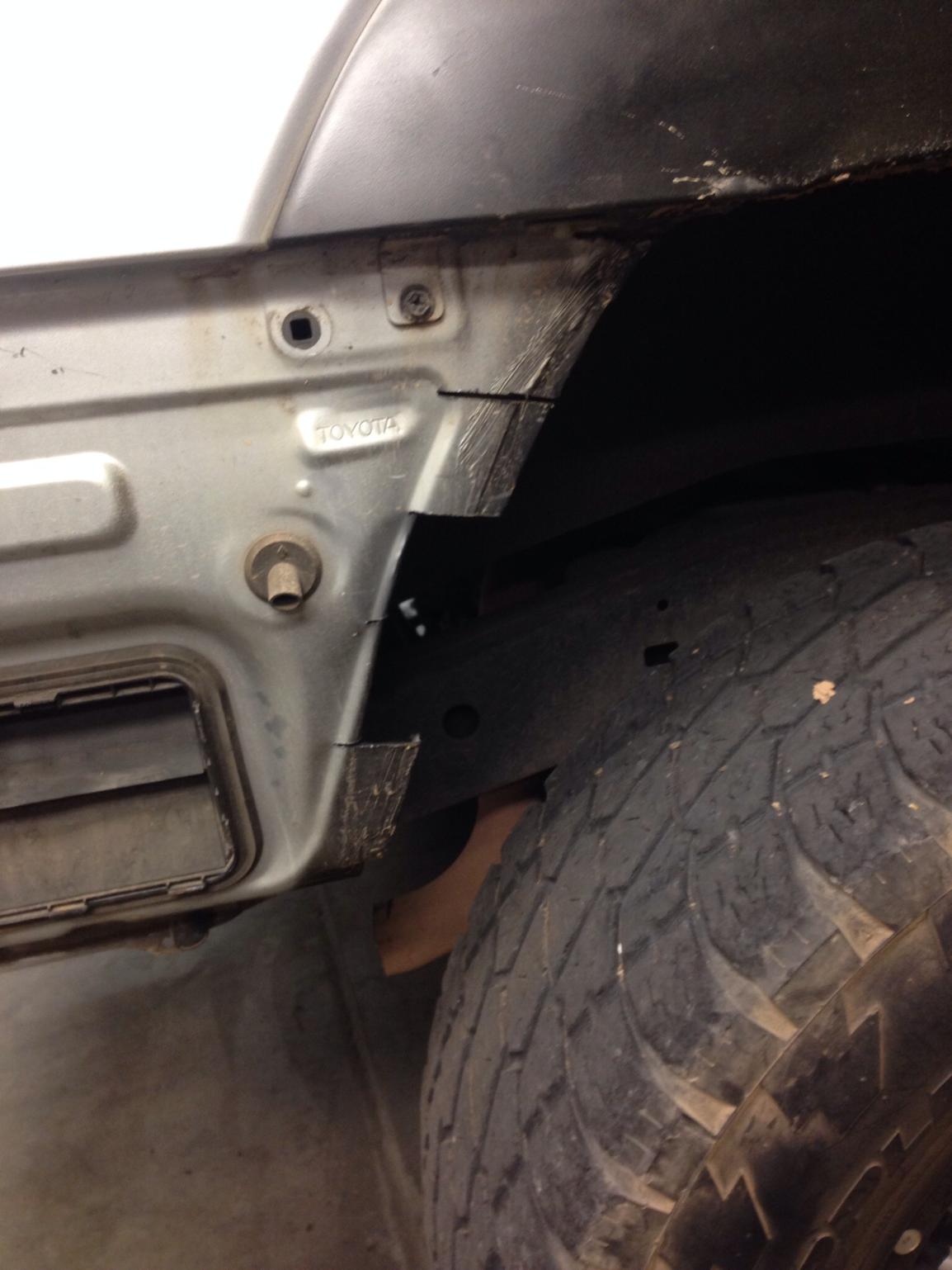

This is my front right inner fender. You can see how much of the body mount I've cut up and I'm still rubbing, I've also cut and bent and beat the inner fender where it is glued/welded/crimped to the body. It's been a learning curve as I learn new places I rubb when I remove another.

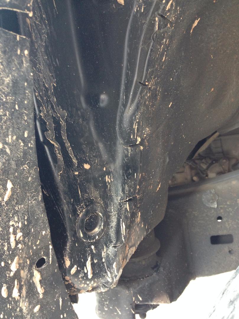

This is a cover I made to help keep water and mud from building up on the body mount

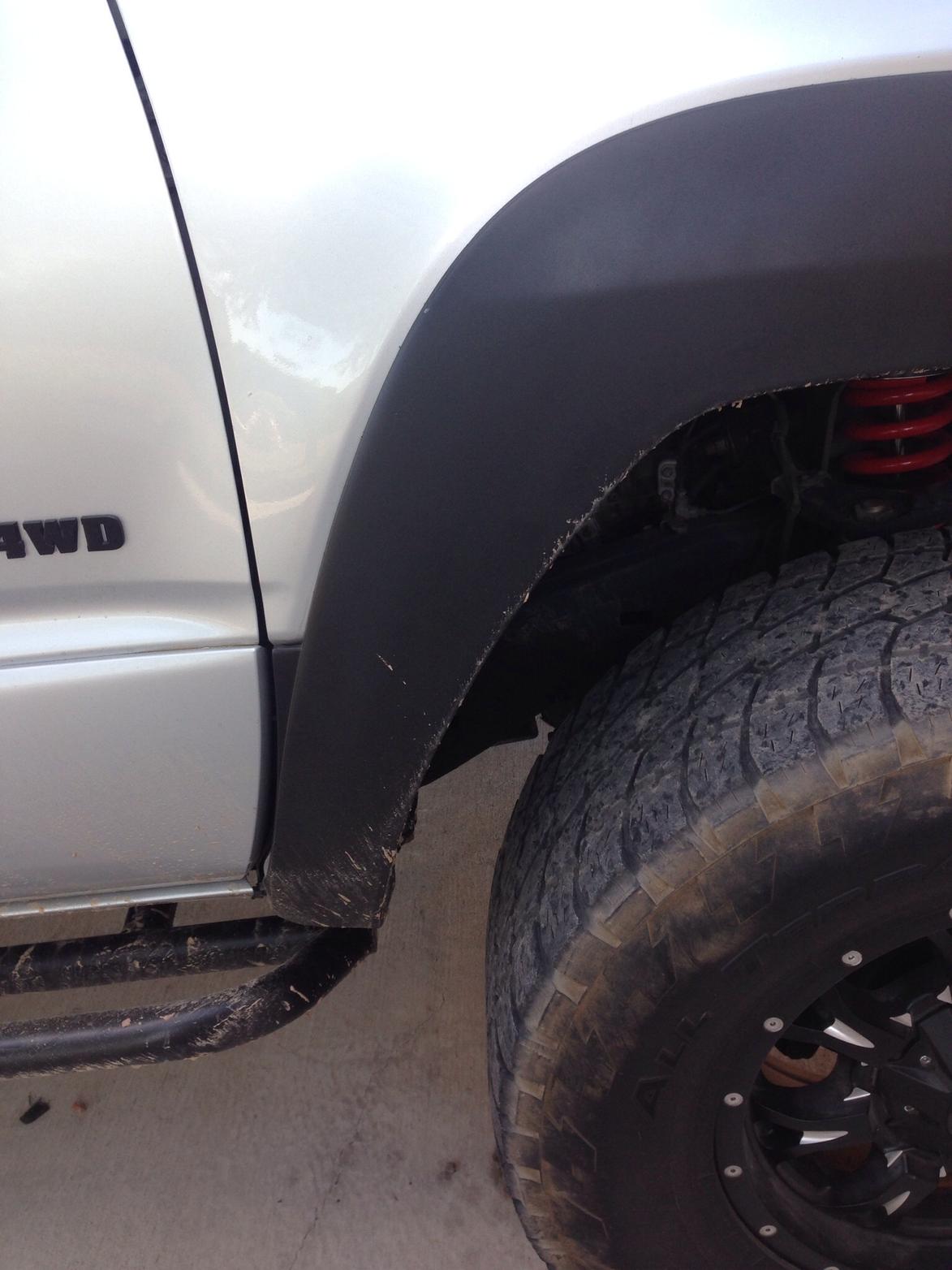

Because I wanted 35's and refused to settle and just give in, I also had to trim my fender flares because as most of us know no one is willing to make aftermarket set for us. I cut out 2 inches from the bottom and cut along it till I was happy with the curve, then glassed it back together. Left fender took me 3 times to get it correct.

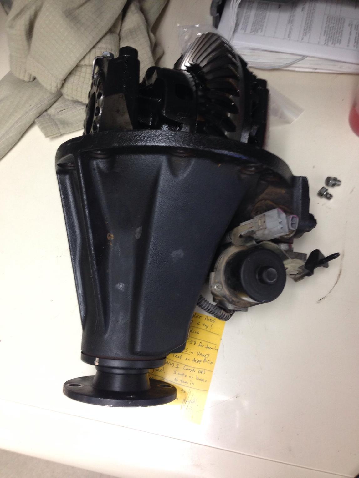

Got my e-locker, I'll post an in detailed install so hopefully people won't have to search as much as I have trying to piece together how to do it, I'll also post pictures of my wire harness I'm going to build using a factory switch to help keep a clean oem look inside my 4runner.

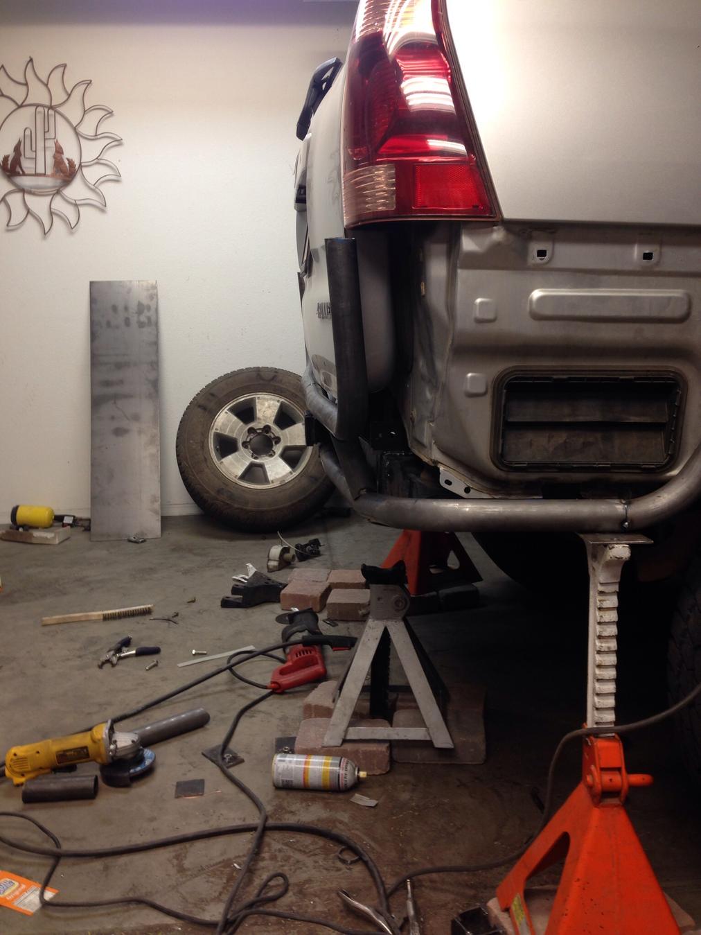

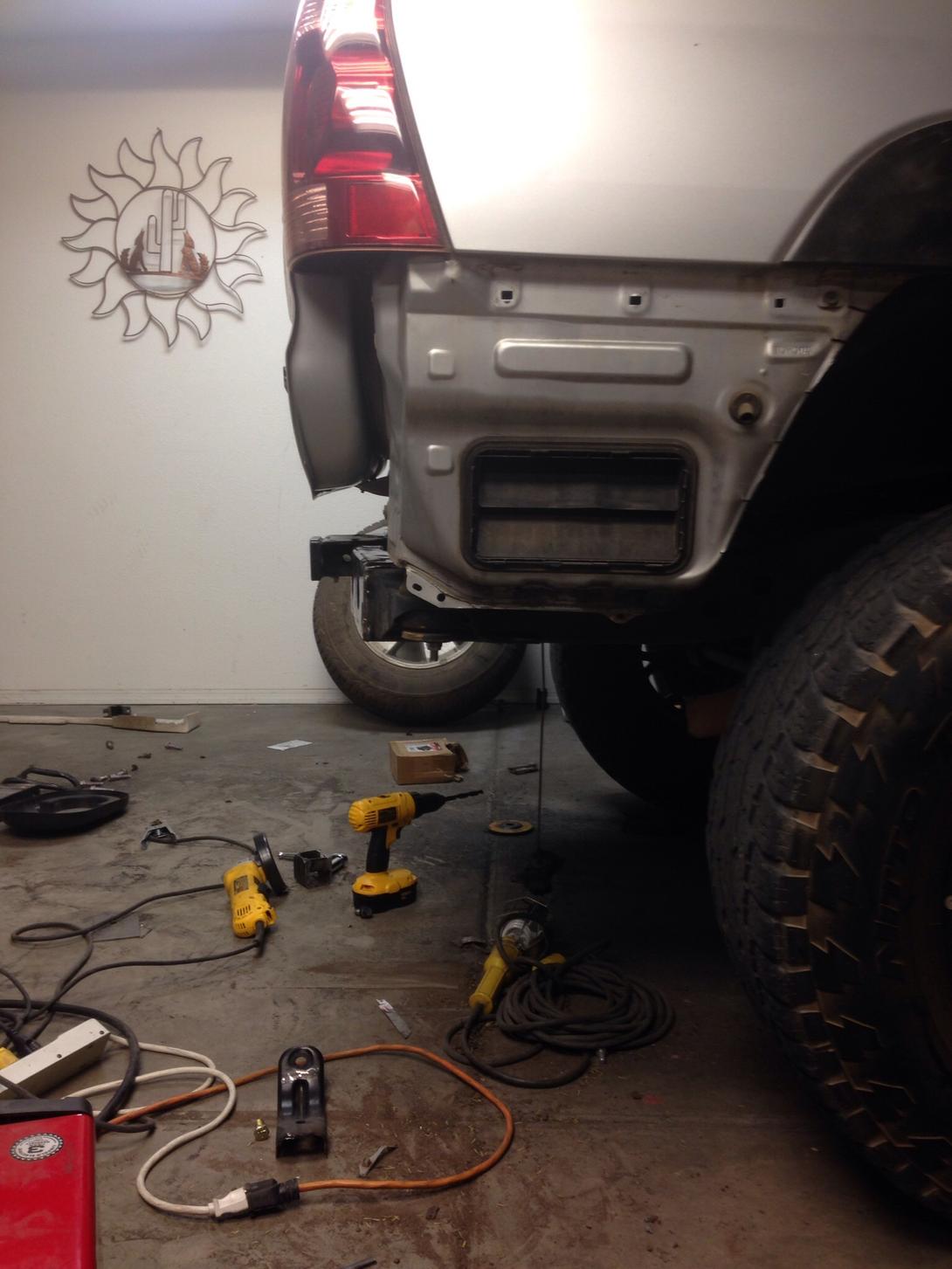

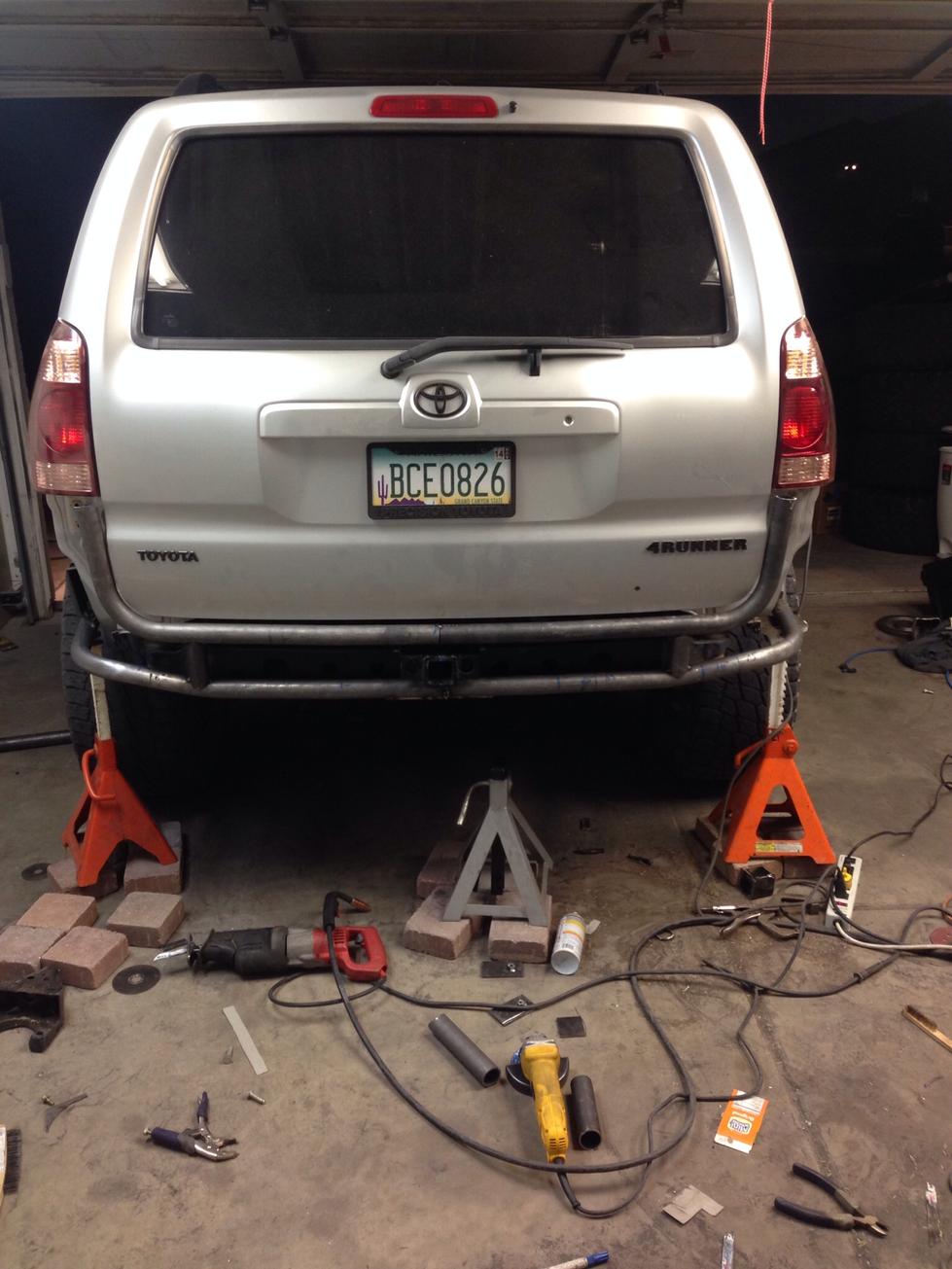

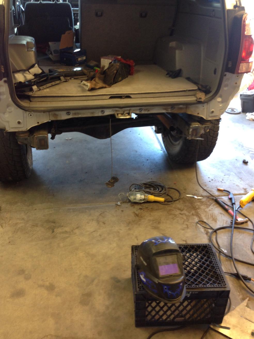

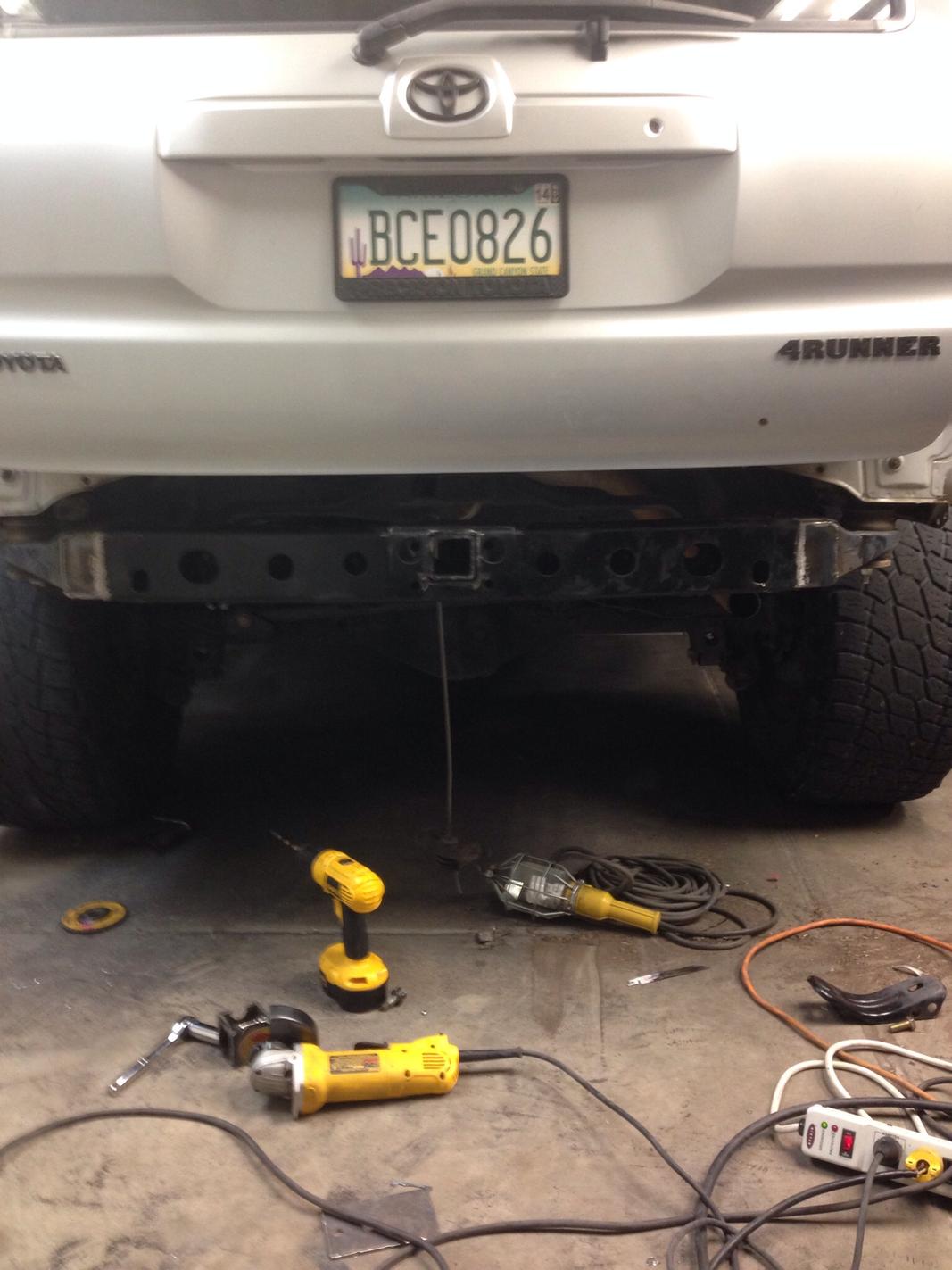

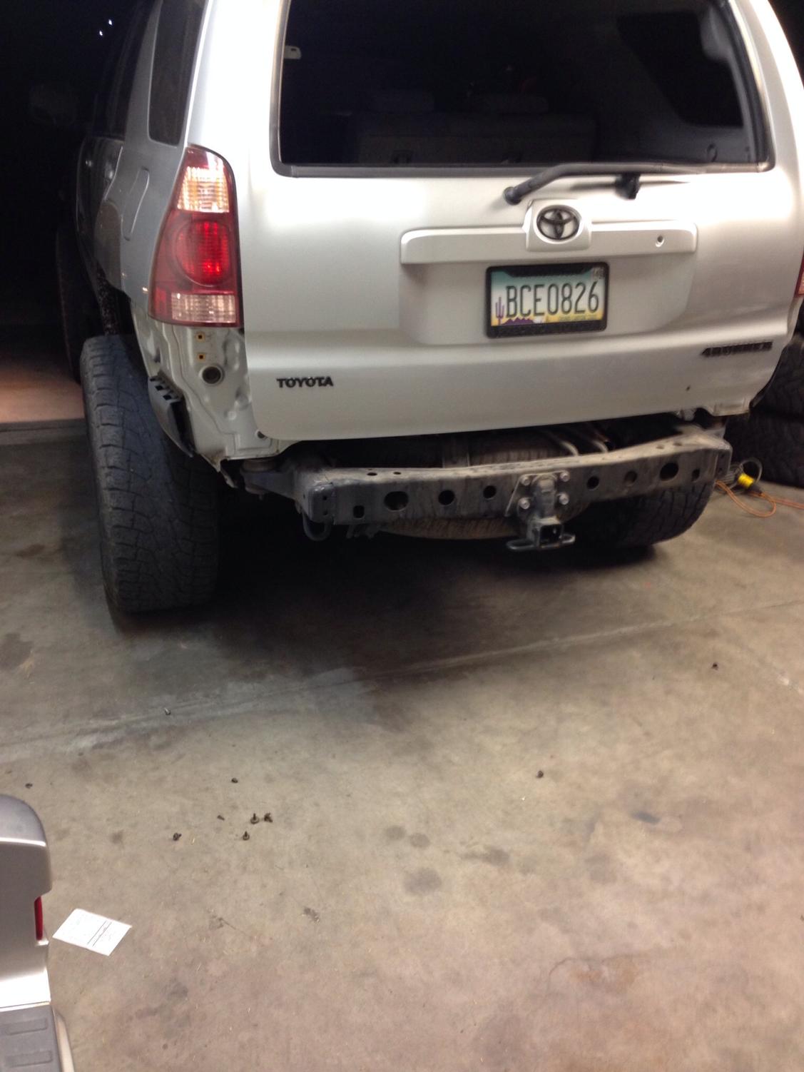

Removed my rear bumper so I can start building my own. Going to cut the frame back 5ish inches to limit the amount of over hang

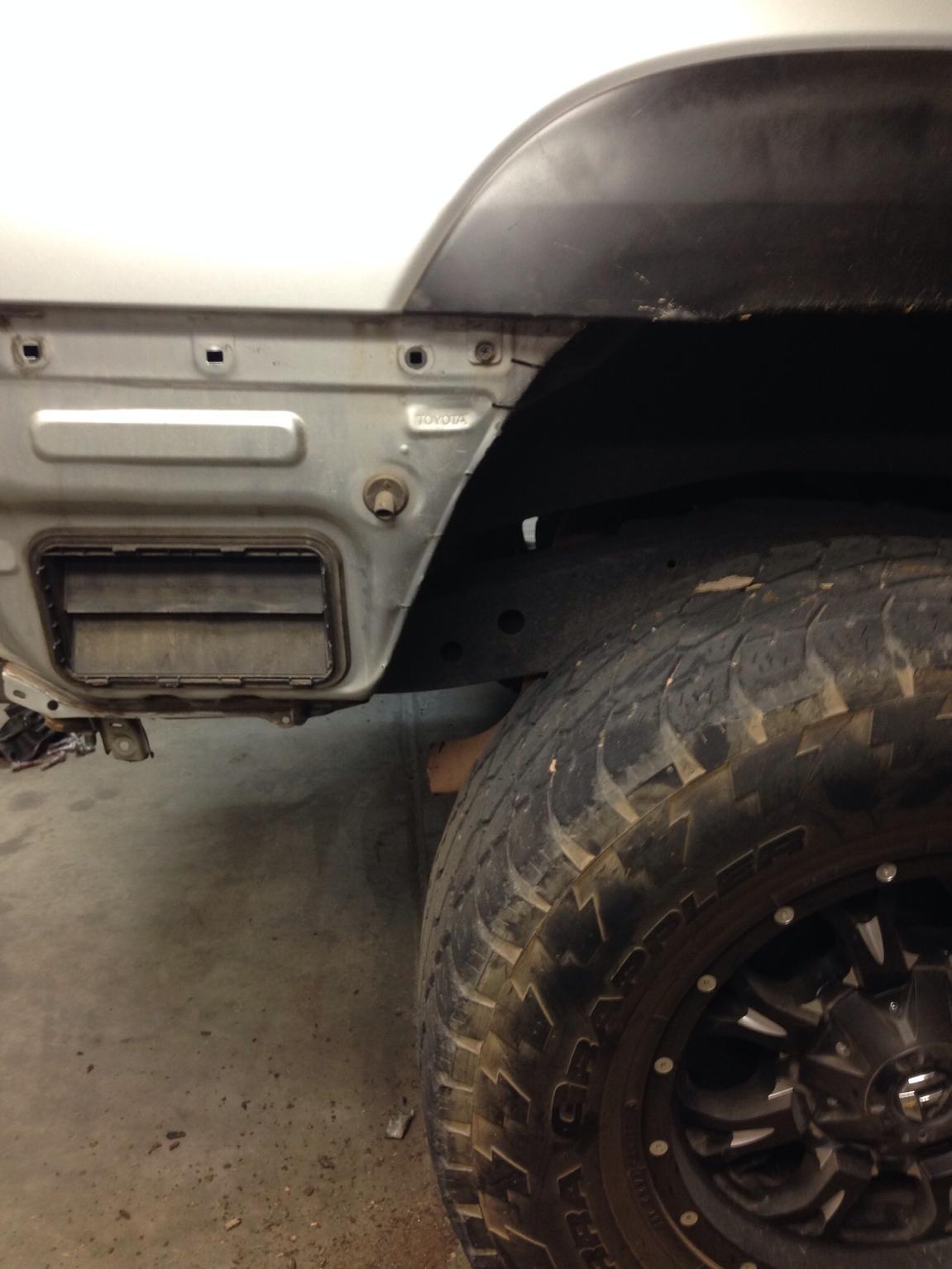

More trimming! Yay! My want for 35s and still to be able to flex. I used to rub against the bumper and the tire would come up but now I've given myself plenty of room
man that looks great, you've got my wheels turning now.
Just an observation, but shouldn't you have a little more space between the hatch and the bumper? Or does it just look close?
Very cool man.
The gab between the rear bumper and hatch is about 1/2". For it to bend up into the hatch I would have to bend the frame too. I'll take closer pictures of the mounts if you want.
